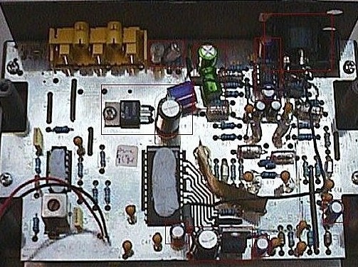

Inside the Digit this 12v unregulated supply is divided. It feeds a single 7805 fixed voltage regulator, with 470uf/25v smoothing caps, to provide the necessary regulated 5v for the LC resonator, 7224 and 7323 chips. The second feed from the 12v supply uses a simple Zener diode (D2) to provide a regulated 11v across the NE5532, giving a supply +5.5v supply.
It's worth noting that while the Digit uses the minimum of supply regulation and diversification, extensive use is made of low impedance tantalum bead caps to provide decoupling to all components. There are 15 such 10uf/16v caps, plus some additional 50uF electrolytics providing additional smoothing to the subsections of the 7323 DAC chip.
The 7323 is a 44 pin chip on the underside of the board. It is highly complex and it has separate analogue and digital supplies (Digital pins 22, 23 Analogue pins 11, 39 & 43). Decoupling between the digital and analogue supply pins is provided by 2 * 50uf Caps and 2 small inductors, resembling small carbon based resistors.
It has an onboard voltage reference (optional) with it's own supply pin (Pin 11) and smoothing cap pin (pin 15). It also features onboard OpAmps, 2 sets, the first to provide current to voltage conversion (pins 10, 44 used by the Digit), the second to drive the output (pins 12, 13, 14, 40, 41, 42 disabled in the Digit - primarily used in Discman type applications of the chip set).

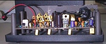

Dismantling the Digit
The Plastic case is held together by 4 screws accessible from the underside. Removing these enables you to separate the plastic box into its top and bottom sections.
The circuit board is connected to the lower half. When reassembling do not be tempted to overtighten these screws as they will strip the thread from the holes in the top section, and no longer bind. I speak from experience as my Digit is now held together by 2 audio-grade-polymer-damping-loops ("Rubber bands").
There are minor differences between types of Digit. Early models had the red LED mounted on the board and visible through the semi-dark Perspex front. This kind is the easiest to take apart. My later model has no Perspex front, the led is glued over a small hole in the front of the box. This means that 2 fine wires link the LED to the circuit board. This adds more complication as to dismantle properly this will need to be disconnected. If you expect to be doing much work, some form of small cable plugs and sockets would provide a simple way of breaking and making the link every time you dismantle. Purists might say the LED isn't needed, but it's nice to know when there is power, especially as the DC plugs and sockets are not very good.
To remove the circuit board remove another four screws which hold the circuit board to the base + a further 2 screws which hold it to the back. >From here you should be able to remove the board by lifting the front and sliding the 3 RCA sockets out of there rear holes. The Digit OPTO is more tricky due to the additional TOSLINK Optical socket on the circuit board.

Within the Digital section the regulation to +5v is provided by a standard 7805 fixed volt regulator, either side of which is a 470uf/25v Electrolytic cap. The regulator can be replaced by the higher spec Linear Technologies LT323AT, which is also higher current rated. It's identical in size and pin arrangements. The 2 caps can be replaced by equivalent ELNA RSH caps or OSCONS. The OSCONS are a little bigger. I use an ELNA on the input and a lower value (100uf) OSCON on the output. Both caps can be bypassed under the board with suitable low value MKP caps, I use 0.01uF Polycarbonates from MAPLIN.
The Digital supply track follows the edge of the circuit board, presumably as a wise means of keeping noise low. 3 * 50uf/10v caps are used to provide extra decoupling between stages. One is by the 7242 chip, the other 2 are around the 7323 chip. All are miniature can type and can be better replaced with identical value OSCON caps, which are the same size and fit well. Agin each of these can also be bypassed under the board with small value MKP's.
Do not remove any of the tantalum beads in the Digital section, these provide extra low impedance smoothing.
All of the above provides better power supply decoupling throughout the Digital section of the DAC.

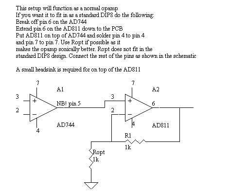

The output OpAmp itself provides a nice field for experimentation. First you should unsolder the NE5532 and substitute a gold-plated, turned-pin DIL-8 socket. There is a little mark on top of the OpAmp which shows you its direction. Be shure to remember this direction because you can't use these chips the other way around. If you destroy the OpAmp while unsoldering you should buy a new one for future comparisons (it's very cheap).
The NE5532 is a dual OpAmp / it amplifies the signals of the left and right channel. It's very easy to replace it with another dual OpAmp which has to be pin-compatible and designed to work in an output stage. The Digit has to be switched off before replacement. Be careful while pressing the new OpAmp into the socket because the pins easily get broken. There are a of possible replacements for the standard IC (the OPA2604 is my favourite).
If you want more you should try two single OpAmps instead of one dual. To do so you need a U-form adaptor for the connection between your DIL-8 socket and the two 8-pin OpAmps (I think Audio Synthesis sells them). A single OpAmp with a high reputation is the AD797 which I never tried because I directly chose the even more complicated solution of an AD744/AD811-combination (the original NE5532 is replaced by 4 OpAmps !). Sonically this one is the best, at least for ME.
You have to be aware that every chip has a sonic signature of its own and you will have to find YOUR PESONAL solution here. As Dominic Todd wrote in Hifi-World 08/1998 "One listener's 'bright and vivid' is another's 'grainy and harsh'". Jonathan, for example, still uses the standard OpAmp because all its replacements were too bright for him. You should go back to the NE5532 from time to time to check that you really achieved an improvement. Be aware that OpAmps need a little time to break in though.

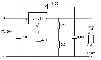

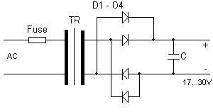

Dieter also built a Lead Acid charger
Charger for 12V Lead Acid Batteries
This charger delivers a constant voltage of 13,8V which is the optimum for charging 12V Lead Acids. During the charging process the Lead Acid itself sets the current (the current decreases while charging). The batteries need charging when their voltage drops below 12V. After charging their voltage will be approximately 12,8V. The circuit described above is able to deliver up to 1,5A of current. It is also possible to charge several Lead Acids in parallel but then it will take longer until the batteries are charged. The voltage regulator (LM317) gets very hot and so needs a cooling surface. The circuit needs an input voltage of 17-30V DC which could be supplied by a simple design like this:
The parts of this design should be able to handle the maximum current of the following chargers. C should have a value of (1000uF * max. current A).
