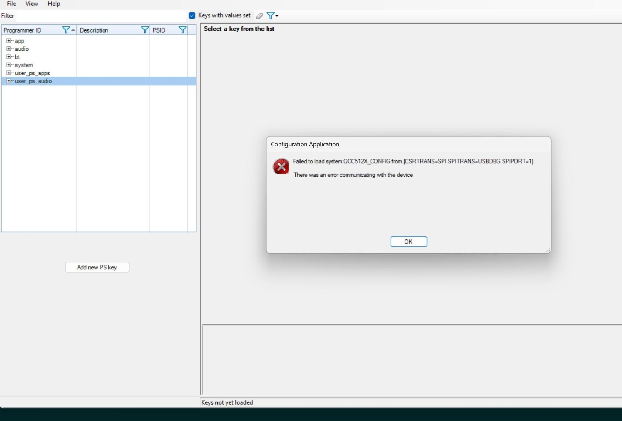

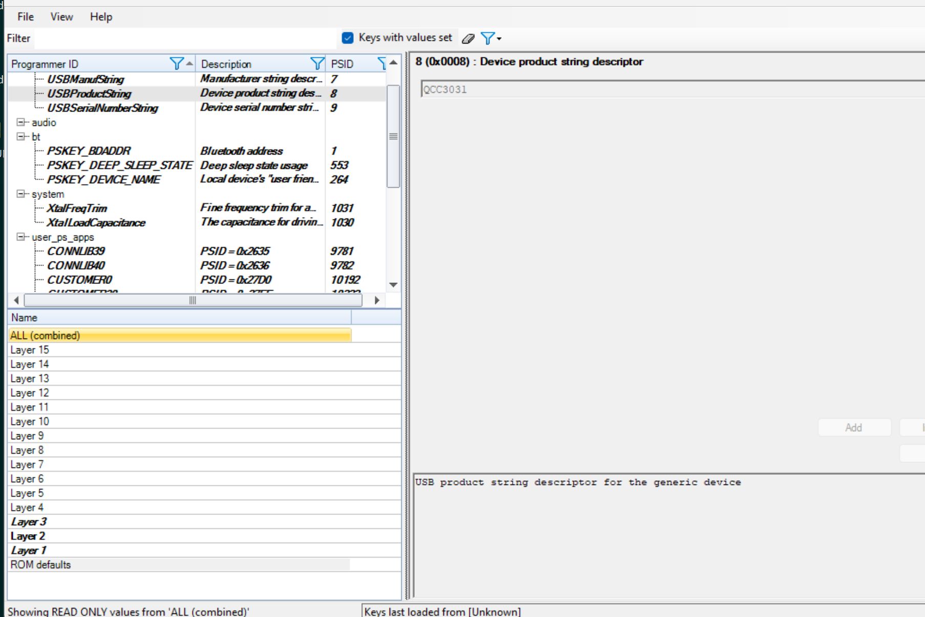

I am still tying to rename QCC3031 module. QCC-Tool works for me, but it changes the "Friendly Name", which is called "PSKEY_DEVICE_NAME" in Configuration App. The key I really need to change is called "USBProductString".
So I'd like to change this name with Configuration App.
But for Configuration App, I need the .sdb for QCC3031.
If I simply use file "512x.sdb" (found in QCC-Tool directory), configuration App can read, but writing ends up in deleting keys in the module ...
Attached screenshot with error when reading QCC3031 with 512x.sdb - although many (all?) keys seem to be displayed.
If there is a link with .sdb-file for QCC3031, please let me know.
Or better: Is there a way to change the sdb and to remove all keys, but the one "USBProductString" which I want ro read/write?

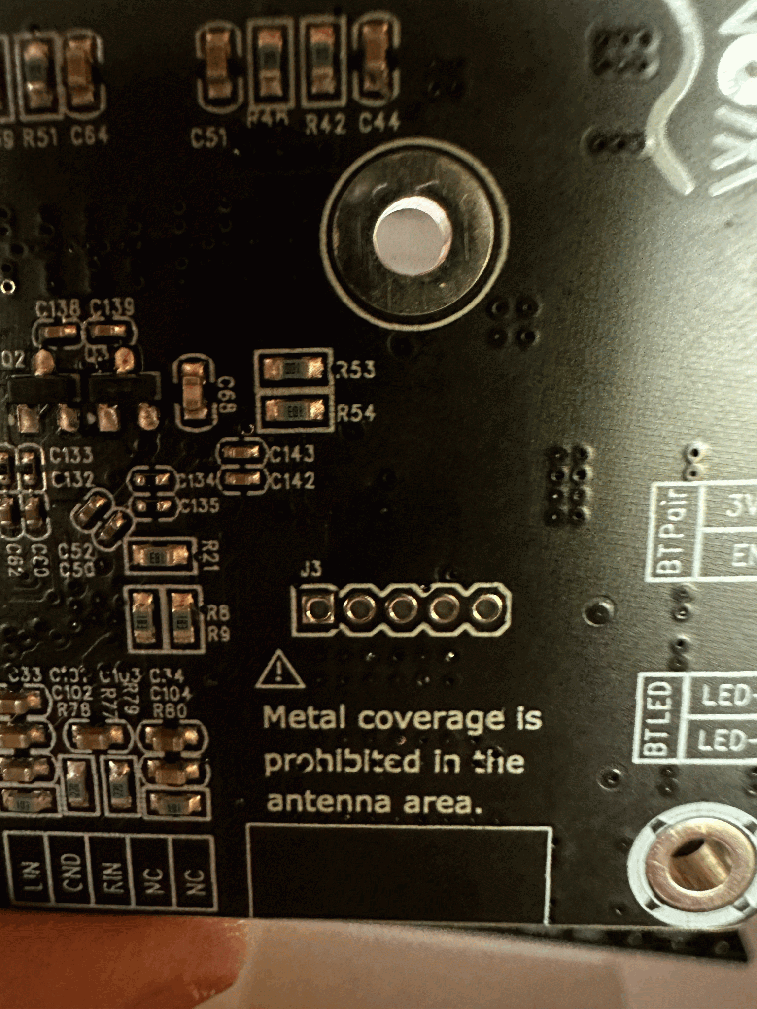

@Bluebert, did you every try and use the SPI connection for this unit? I am in the same boat, and already have the SPI-USB converter from a previous project, but I don't want to fry this board in the process. I love that you received the J3 pinout, but can you confirm what order these pins are in from left to right? I am assuming left to right it is MOSI, MISO, CLK, 3V3, GND with the "square" pin being MOSI. Does that seem correct?
In case anyone is looking for it, I got Wondom to provide the pinout for this board. Looks like pins 27, 28, and 34 are for USB. I am not sure about the VCHG pin, but I figured I could omit that pin, and just plug the whole board in for power. I will be trying later today, so wish me luck.Hi,

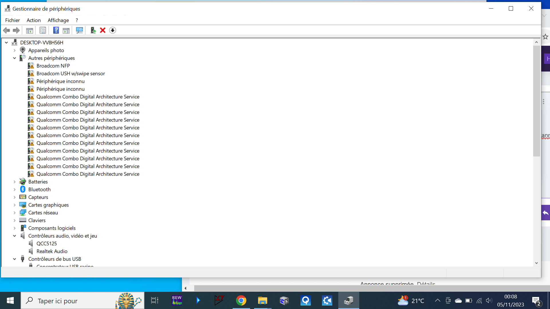

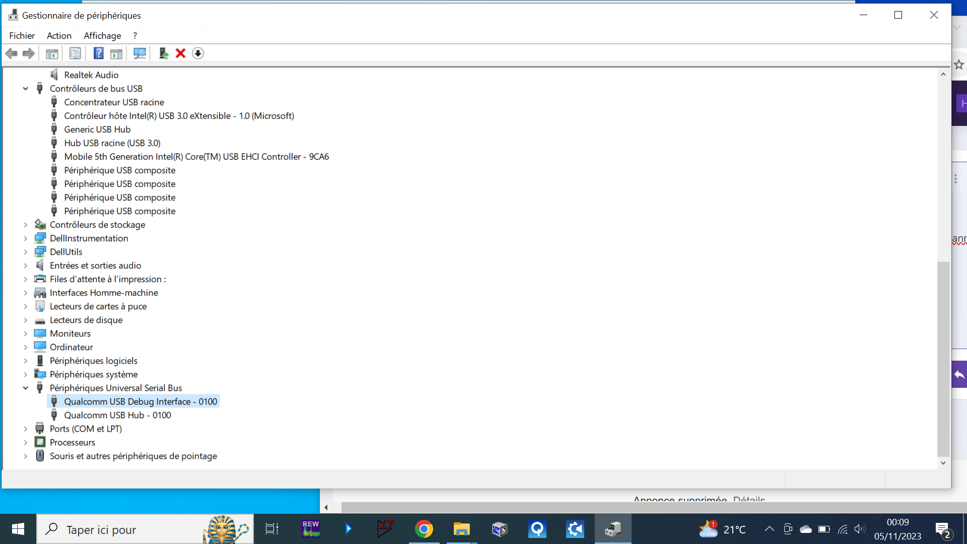

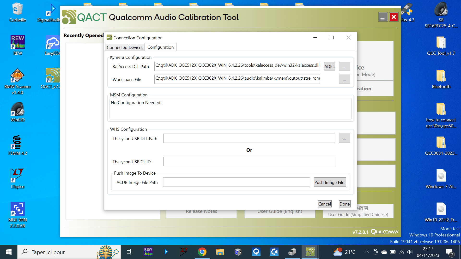

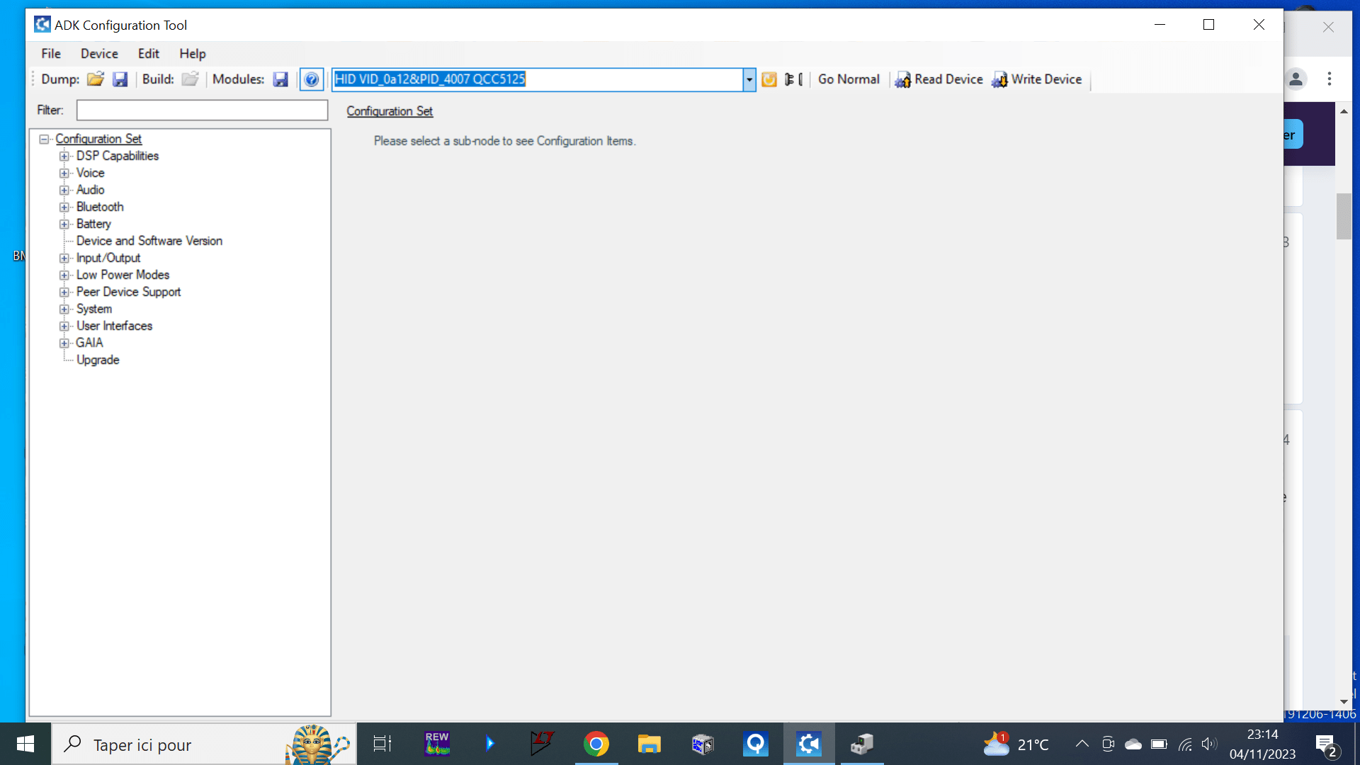

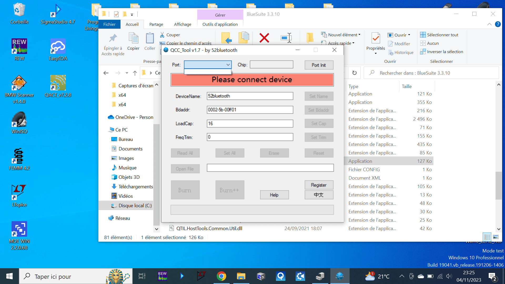

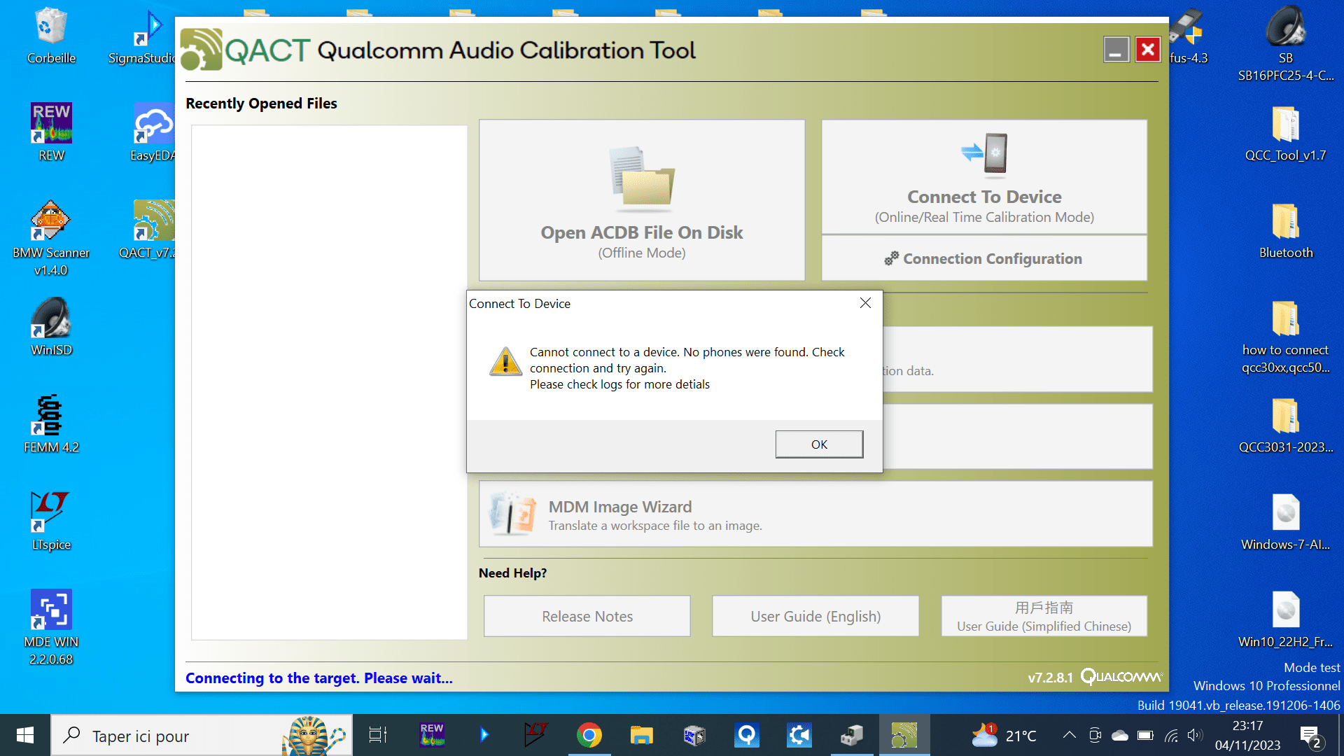

Hello
Do someone can help me with usb connection with qcc5125?
Drivers seems to work, I can see the qcc5125 in the ADK Configuration Tool and can configure it,
but I cannot connect to it in qcc tools to change name, nor in qact to configure DSP.
You will find screenshot of the differents involved windows.
Thanks a lot
Hugues
