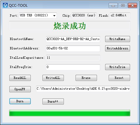

Any advice on using QCC_Tool? It's in Chinese and I'm struggling to make sense of it even with translators
My advice will depend on your goals of using this app. It works for me.

I hope this picture will help you.

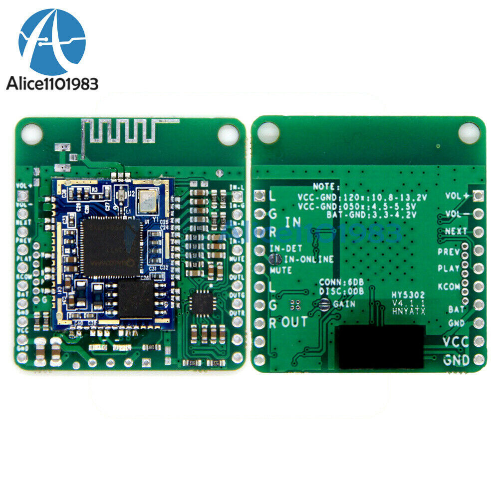

I got one of these QCC3031 boards. Does anyone know which are the USB pins?
There's smaller solder holes on the left side labelled N, B, P, V, G. Just a random guess but could it be this?
N - USB_DN
P - USB_DP
V - VCHG
G - GND
I'm wondering if anyone has programmed this specific design before. I really don't want try a random guess and blow up my board.

About labeled holes on the board, in my case this is not working for me, I connected directly to the pin on the chip, the pictures on the first page can help you with that.
GND -> GND
Data+ ->USB_DP
Data- ->USB_DN
+5V ->VCHG
If you have a multimeter you can check contacts on the chip and on the lebeled hols.
From the picture you sent 1.27mm pitch pins are top to bottom
1 - NC
2 - D-
3 - NC
4 - VBAT
5 - D+
6 - VCC
7 - GND
I have the same board and I don't remember where I found it but I found a datasheet for the BTM331 and was able to trace out the pinout to confirm them. To be clear your connections between the two will be
USB QCC30XX
VCC 1 --> 6
D- 2 --> 2
D+ 3 --> 5
GND 4 --> 7

Thank you. It works.
Unfortunately my board broke a few days ago. In the middle of listen to audio, it randomly died. When power is connected, one LED turns on for a second then goes out.
I wired up a USB cable and it is detected by the computer. I installed the drive and applied the unlock steps. It showed up in the NVS app. I was able to dump the firmware. The verify command and it was very flakey, failing to verify more often than not.
I tried to erase and reflash. But after erasing it is no longer detected by the NVS app. The USB devices still show up in Device Manager but nothing else works. So I guess it's really borked now. I noticed the firmware dump from my board is 28MB vs 57MB that German1212 posted earlier.

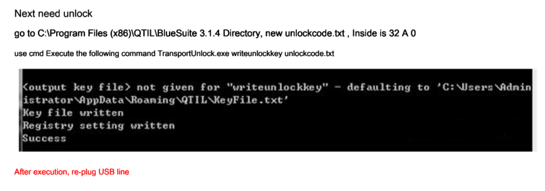

I'm following the steps in the PDF and have created a file with 32 A 0 but TransportUnlock.exe is complaining:
Code:
ERROR: Key of invalid length at line 1 of key file 'unlockcode.txt'
Failed
Any thoughts?

Great, that worked. I've unlocked it and made a FW dump.

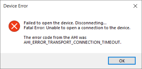

I'm now trying to use ADK Config tool but I'm getting an error when I select the QCC3031 device with the correct VID and PID. Am I missing any steps?
