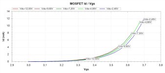

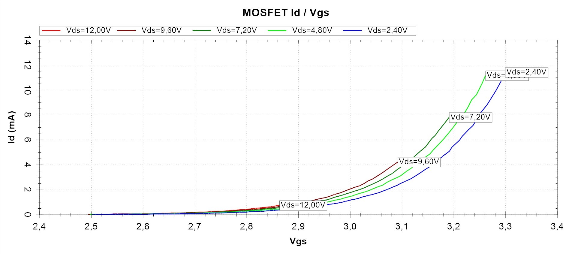

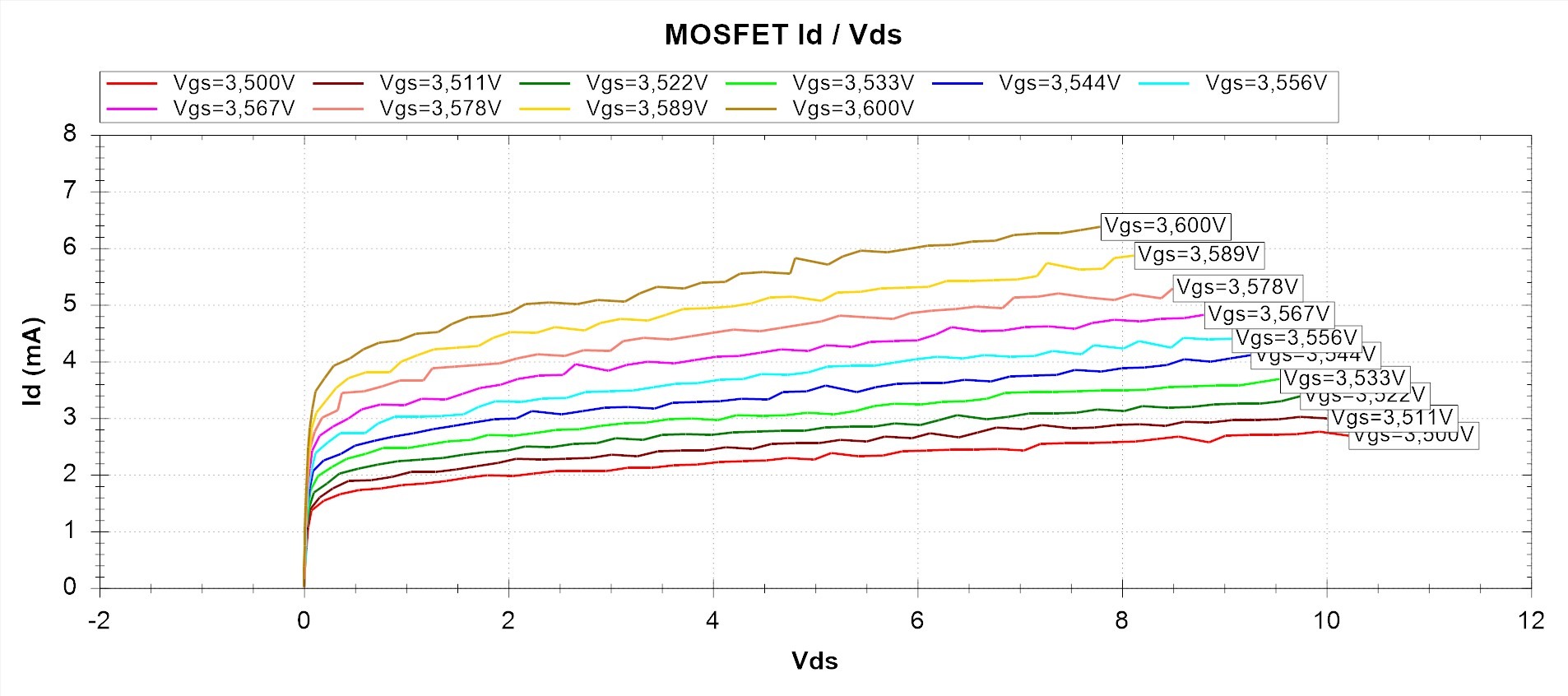

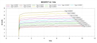

Hello,

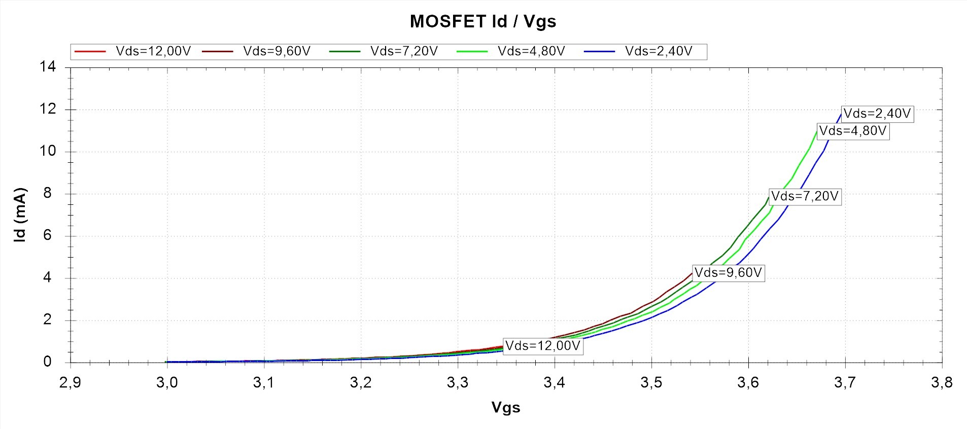

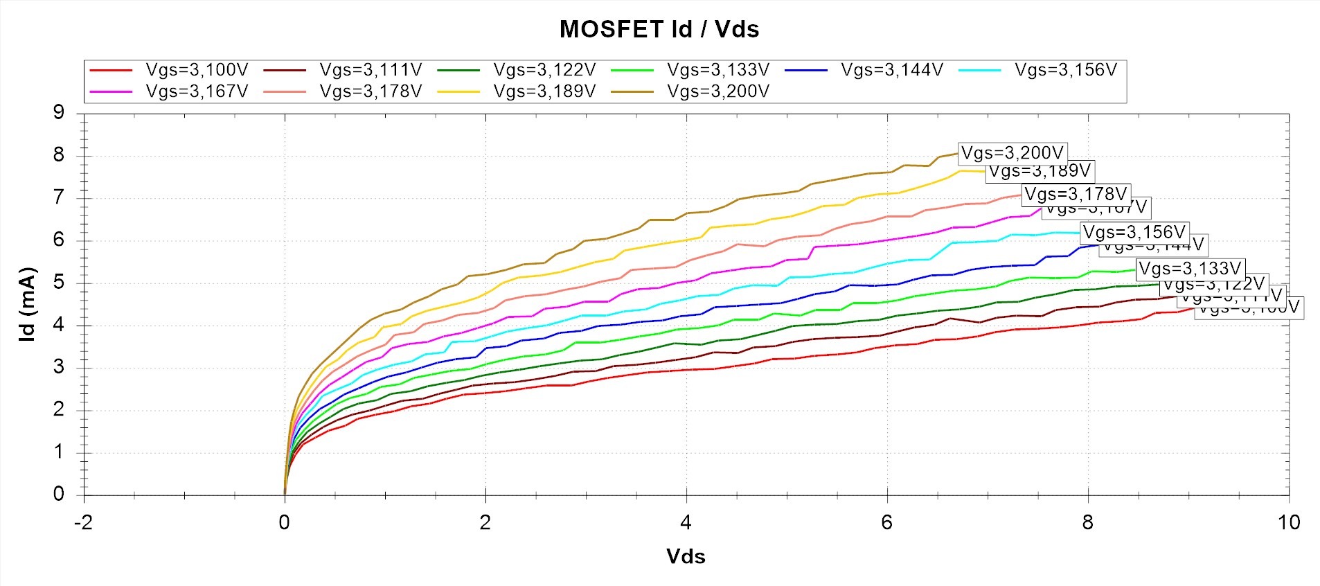

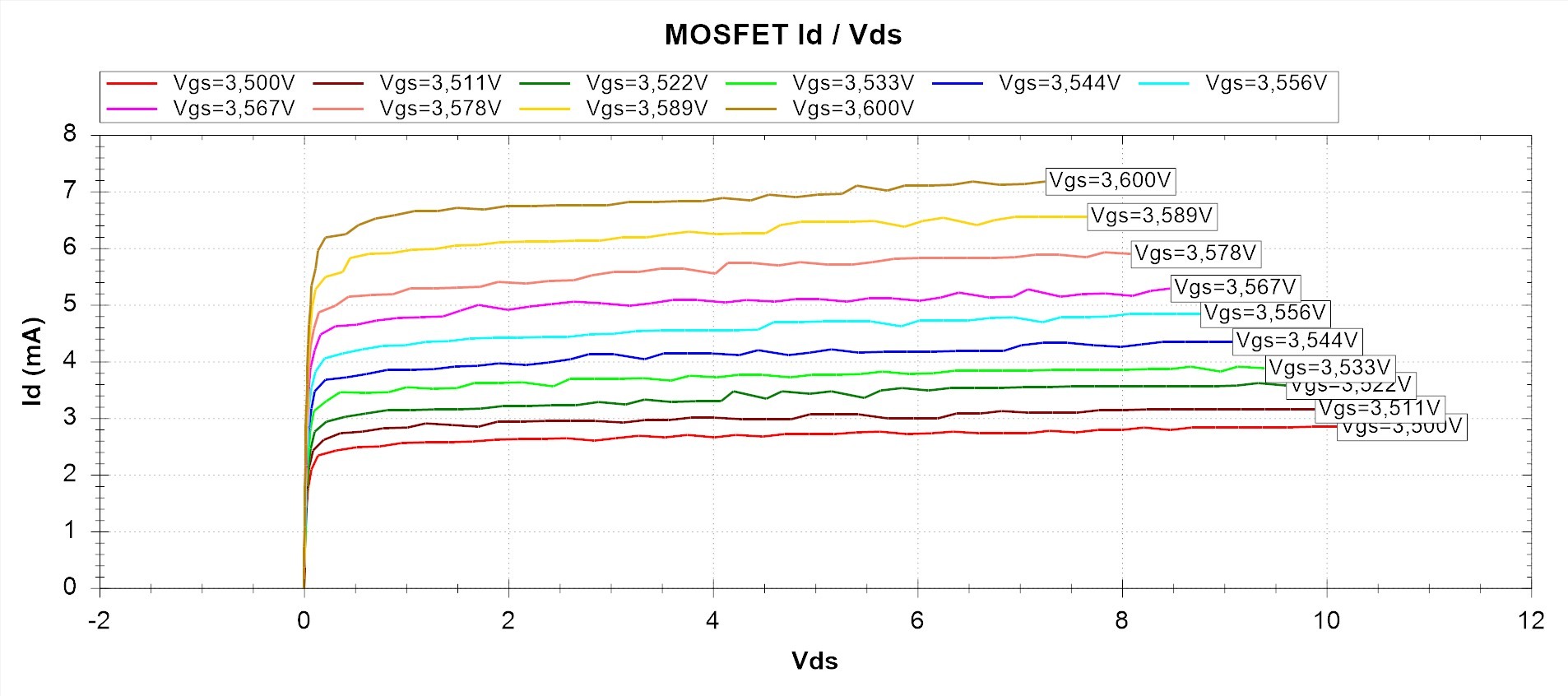

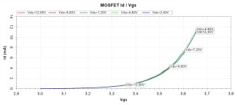

I got IXTH48P20P and made measurements, also FQA36P15 and FQA46N15 for comparison
Regards Tim
Regards Tim
Tim thank you for this comparison!
In the next Q17 build, the clear choice for me is FQA46N15+IXTH48P20P.

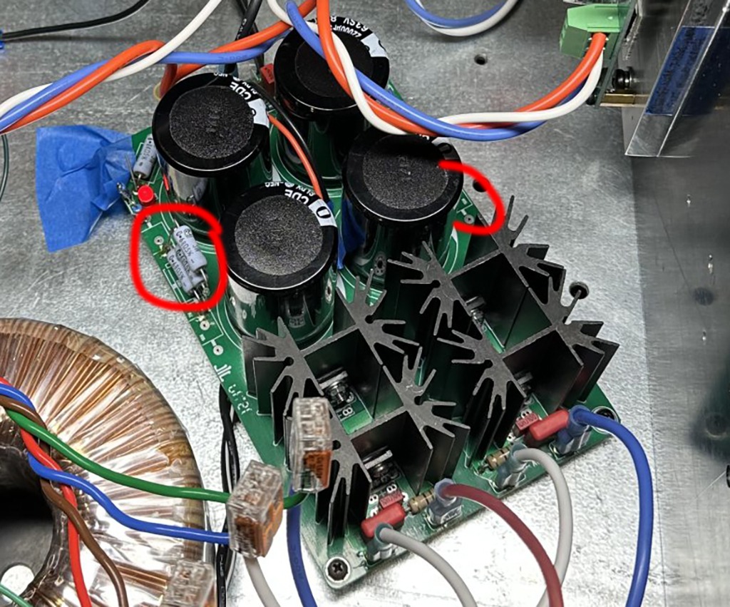

Hi Tibi,
I've just assembled the PSU and the amp, up to the point where you describe some tests to be done before installing the last components.
I wanted to test the PSU before I connect it to the amp. Unlike a linear PSU, the active PSU can't just be connected to the mains and the output voltage be measured without a load connected to it.
I'm using a 2x40V toroid 500VA trafo.
Without load, I measured +-60VDC at the output, while I measured 40VAC at the input. This is totally different from a linear PSU reading.
My question to you is: can I connect the PSU to the amp without a risk, or is another test method recommended for the PSU? E.g. recommended load to test the PSU?
Christophe
Christophe
Hi Christophe,
You may power and measure active power supply without load. You will get a slighter higher voltage than a normal diode bridge.
+/-60Vdc is perfect for Q17. Double check if you have correctly mounted all parts and go ahead and test.
Thanks a lot Tibi,
I just wanted to be sure that the higher output voltage is ok, before I connect it to the amp.
No worries: I'm double checking every component while putting it in place.

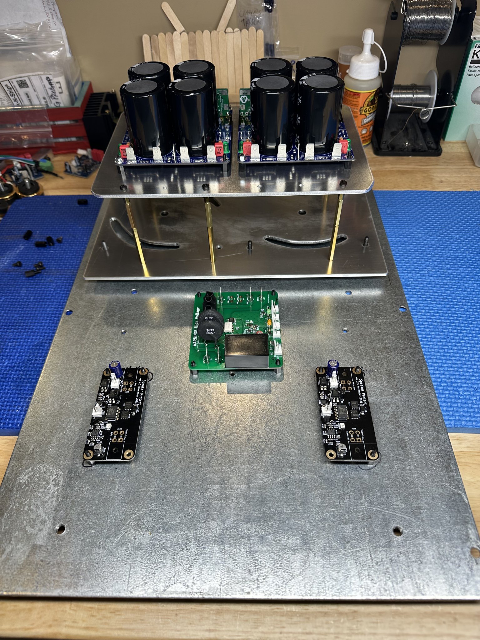

I see you will be using mosfet SSRs. The PSU should have screw or, in the best case, clamp connectors. Large transformers also have thick secondary wire, which are not ideal for crimping fastons, ...
