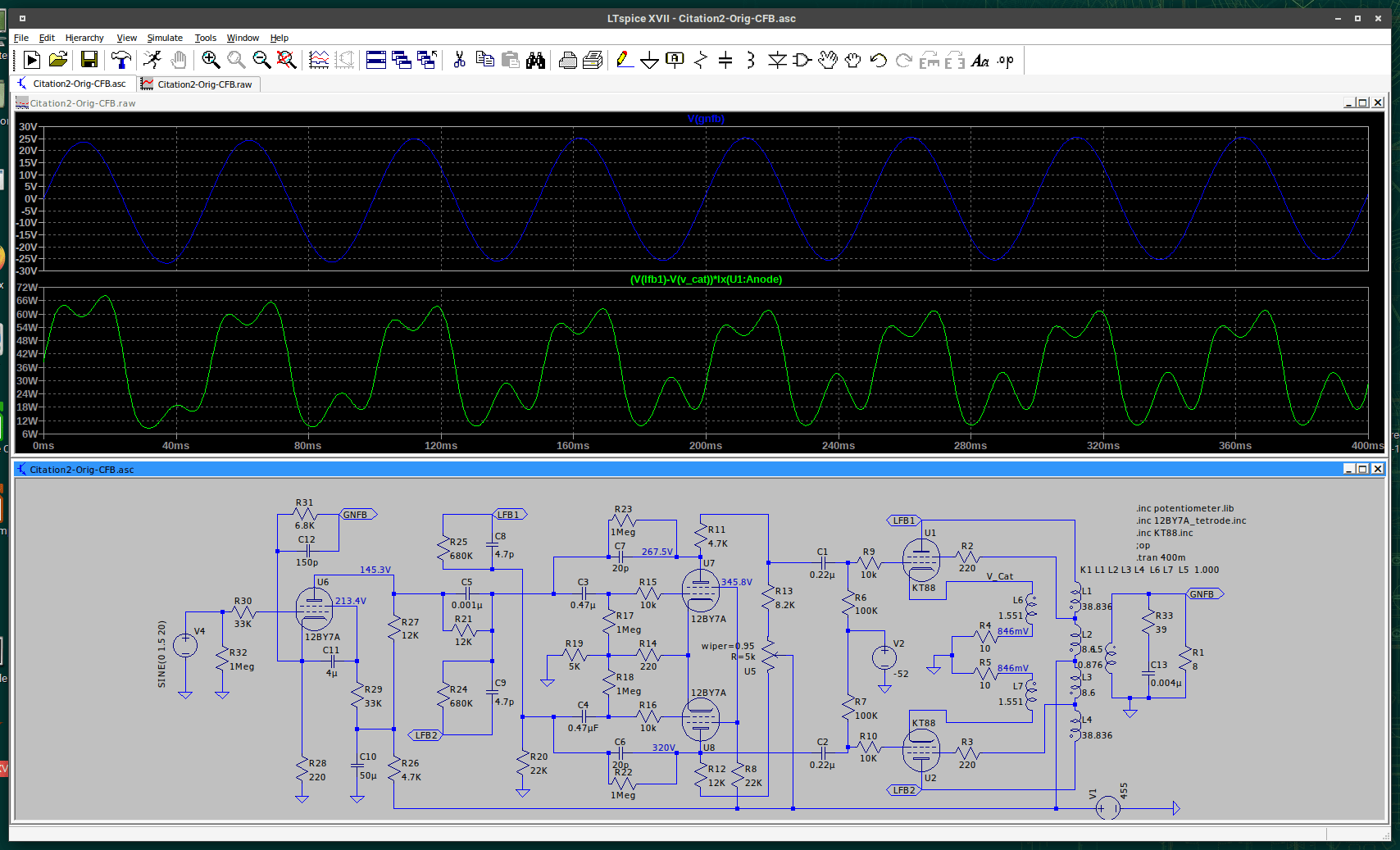

I have some difficulty to evaluate output tube dissipation power. KT88, 455V B+, 85mA idle current, ~38.7 power.
In LTSpice model I(anode) shows peak 330mA. How max anode dissipated power not exceeding 42W?
What am I missing in this particular case?

Peak current happens when the anode voltage goes down. Plot in LTSpice (anode voltage - cathode voltage) * anode current.
And that peak dissipation will exceed 42 watts. Semiconductors are subject to instantaneous VI limitations, tubes are not. You only need to worry about maximum average plate dissipation - about B+/(2.5*Ra-a) - or the idle dissipation, whichever is greater.
Peak g2 dissipation limits are sometimes given, and should be respected. Those fine wires heat up fast.

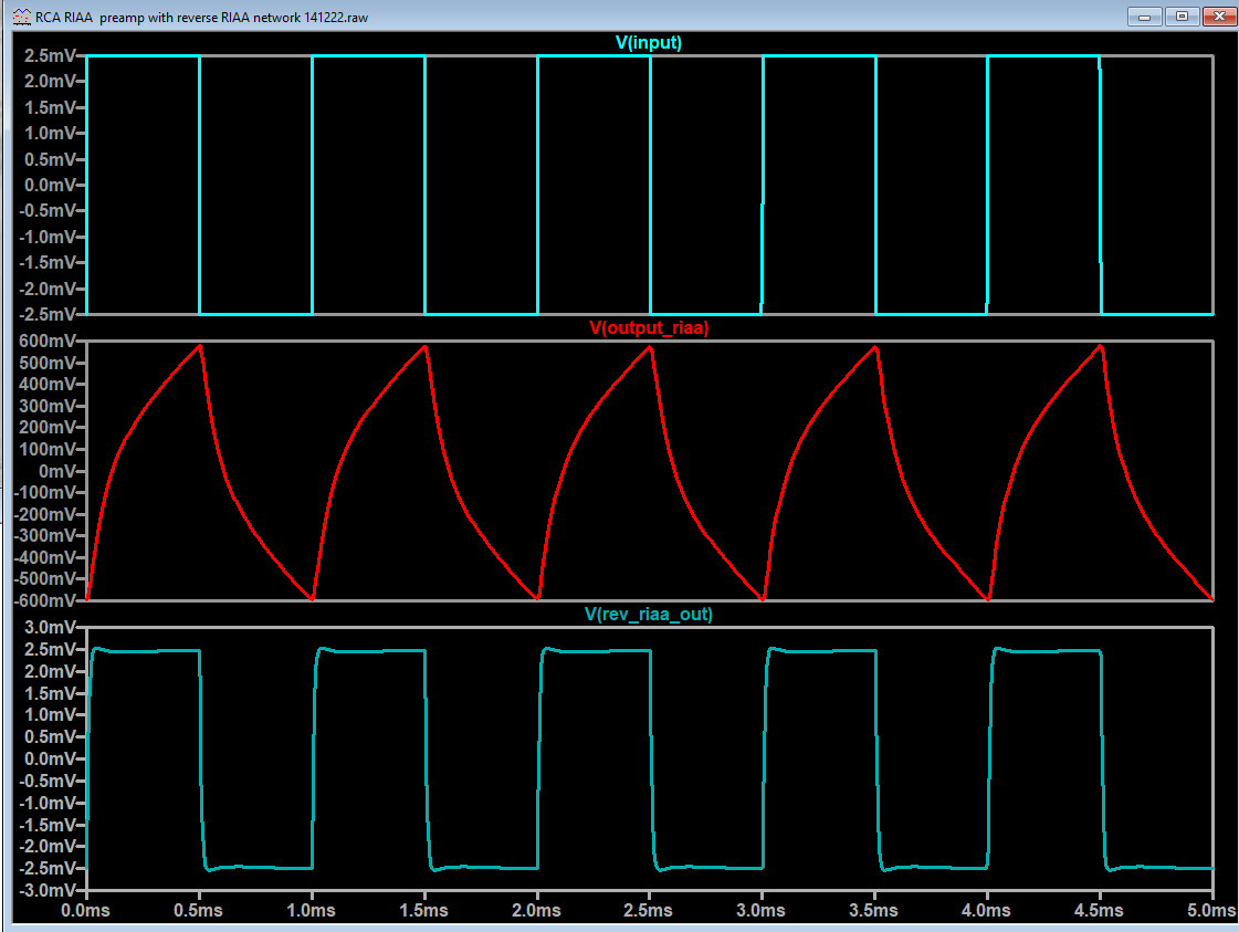

I recently did a post on RIAA and used multiple plot planes, I will repost that image here (as an example of multiple plot panes) it shows square wave into RIAA preamp, preamp output and the Inverse RIAA back to hopefully show close to the original waveform.

You should make a distinction between average power and peak power.
It may well be that with signal, dissipation peaks get above the max, but the tube max spec is for avergae power.
If you want to check it in LTspice, set the signal source to zero (or very small like 1mV) and see what the power is.

Thanks, that's what I finally did. Plot attached.Peak current happens when the anode voltage goes down. Plot in LTSpice (anode voltage - cathode voltage) * anode current.
Now press Ctrl key and left click on the power formula in green. You should get a small window showing the average anode dissipated power.Thanks, that's what I finally did. Plot attached.
If you want the total tube dissipation, then you have to add to that equation the screen dissipation in a similar way.
