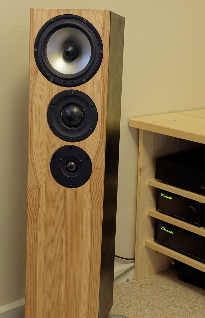

It's not really necessary; though mine are tilted slightly due to how close I am to them (small room).
The important thing is to get the offset right when designing your crossover. Get a tape measure and measure from the listening position. That will give you the correct offset for each driver.
