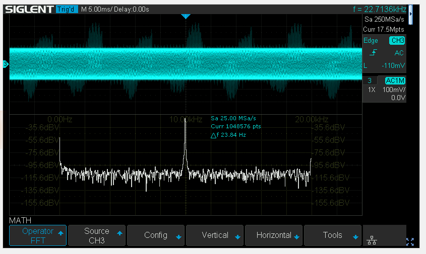

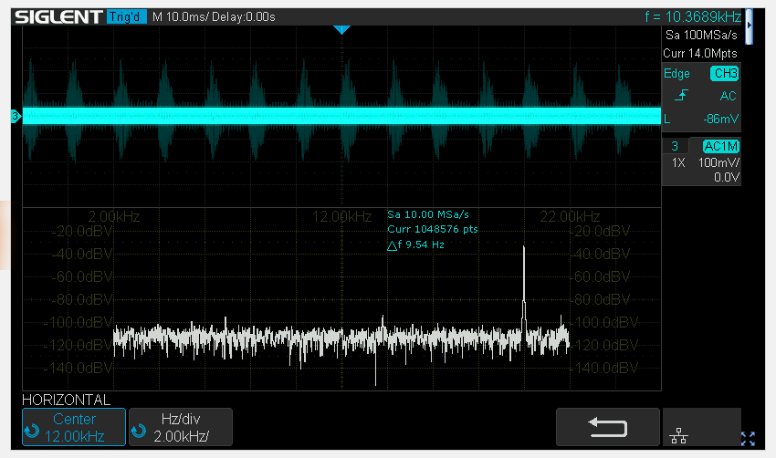

So two main improvements can be made:
First - zero crossover detection
When the data buffer is created, a zero crossover can be used - this detects the last crossover sign change and allows the data to be adjusted so that there's a seamless crossover.
Now I have the code for zero crossover in the next version, however it's not fully working because of point 2 (it assumes a start at zero).
Second - reduce change latency
When the 1104 does it's bode plot to sweeps slowly and gets faster as it gives up the logarithmic scale. The current code has a limitation in that frames per buffer is set to 44100 - ie a full second of audio per buffer fill. This means that the minimum time between the pitch changes is 1 second. Not fast enough for the 1104. So I'm trying the reduction of the buffer fill to 1/10th the size or 0.1 second. This means more python callbacks and higher CPU but less problems with the 1104.
The initial results seem promising.
The complication is attempting to keep as much out of python as possible - using only the numpy and pre-compiled code/libraries as possible. Also pre-calculating the output required for each buffer fill (as much as you can) - this has to be done dynamically at callback to fill the next set of data.
The C version of a callback has the luxury of being fast enough to conditionally fill a buffer. The python less so.
It's close but not there just yet.

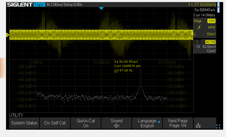

1. I've switched from 44.1K to 192K - this solved the issues further up the frequency range.
2. Did sums on paper then moved them across - I'd got confused and so this solved it all.
3. Cleaned up and added a mute although I disable it.

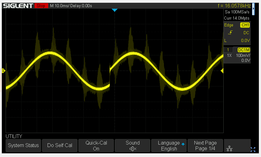

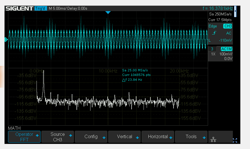

Just testing a 16KHz sine wave and this looks reasonably tidy:

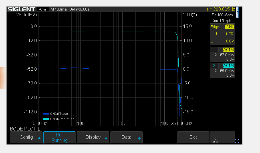

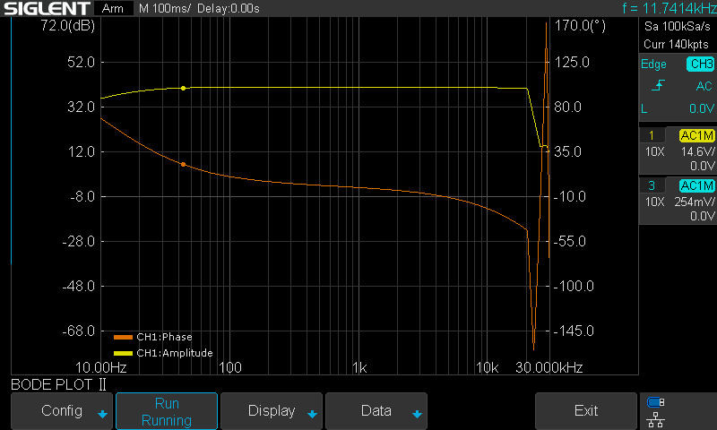

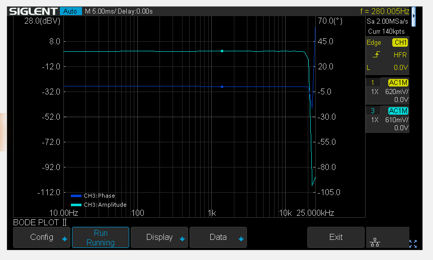

Proof of the pudding, a bode plot Vin dbV which shows the Mac mini headphone filter rolloff:

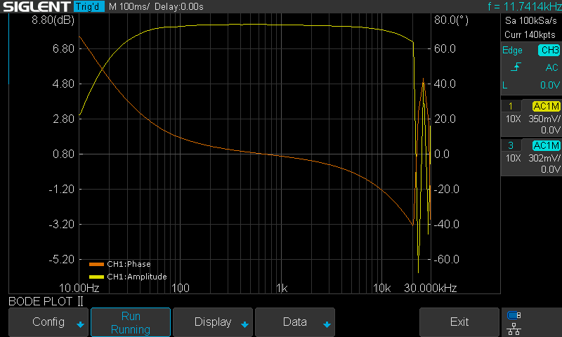

Several cycles later - it still shows the same profile:
