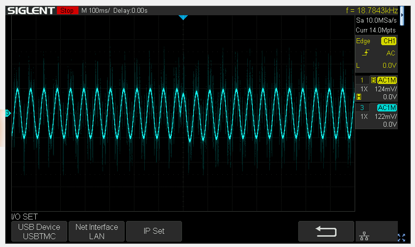

So I had the portaudio sine test example working (C) and I have the pyaudio callback codes and running but I’m still trying to get some audio output. The callback is only called once but not on an ongoing basis as expected with the non-blocking form.
I’ll have another bash at it tomorrow.
Ok so this is working with pyAudio and PortAudio.
Again - you will need to sudo apt-get install portaudio and the libportaudiodev files for your installation.
It's not perfect - the sample buffer is filled with samples to the sample rate. The number of samples (frames) per buffer is constant and fixed at stream opening. So additional work will be needed to correct for the zero point cross over for normal stream operation and for transitions.

Just looking at the waveform, it's clear that the sample start-stop needs some work 😀 (just as discussed earlier) - this may take the form of using the timing information passed on the callback to resolve this.
