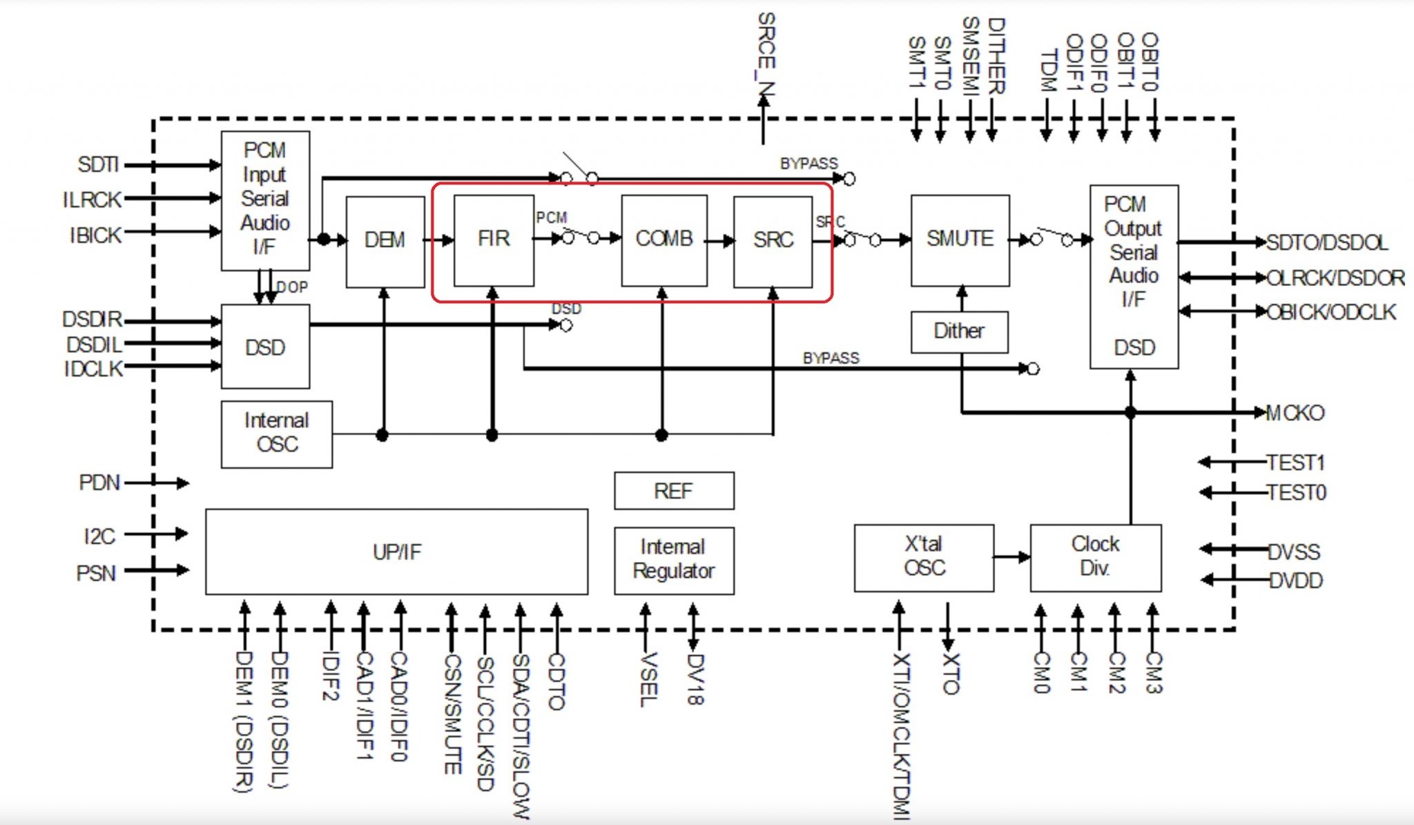

The encircled part of the block diagram looks like a sample rate converter rather than a PCM to DSD converter.

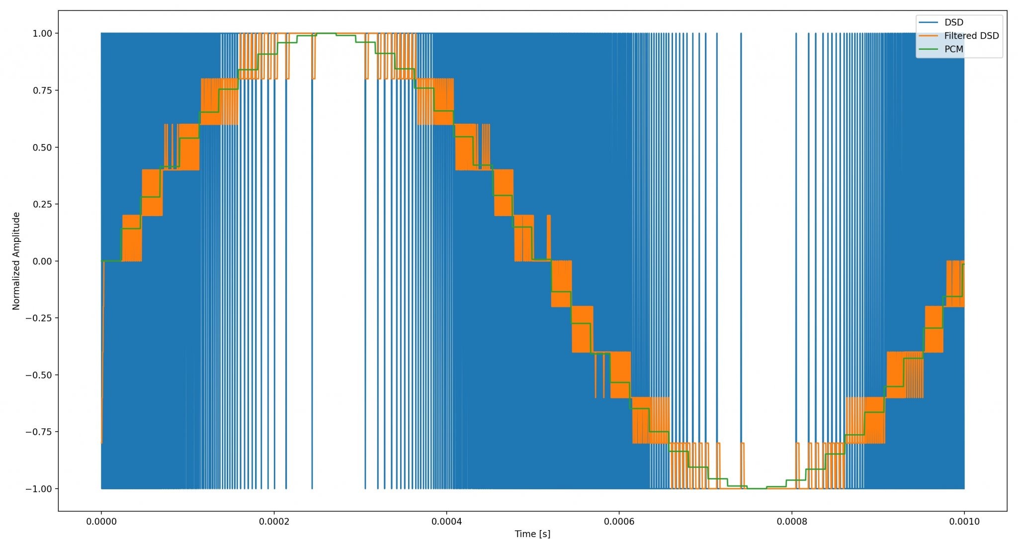

So far I found a simple DSD64 example at github:
https://github.com/AUDIY/FPGA_PCM2DSD
If anyone downloads that example and wonders why nothing happens it is because one line of code is missing at the very end. Just add "plt.show()" to the end of the module.
I guess next I will see what I need to do to improve the example. I would like to get a quality DSD256 and/or DSD512 result (starting from red book CD in a wave file format).
Can anyone suggest a processing flow that I should consider? I would like to understand this subject much better and simulate the desired result in Python before I try to do anything with Quartus and my Altera Cyclone development board.
This is the simple starting example from github:

The main issue with the simple example is that it is only first order, a first-order single-bit sigma-delta modulator with no dithering. That means not very effective noise shaping and lots of issues with idle tones and signal-dependent distortion products. It's a good place to start from an educational point of view, but the performance will be very bad.

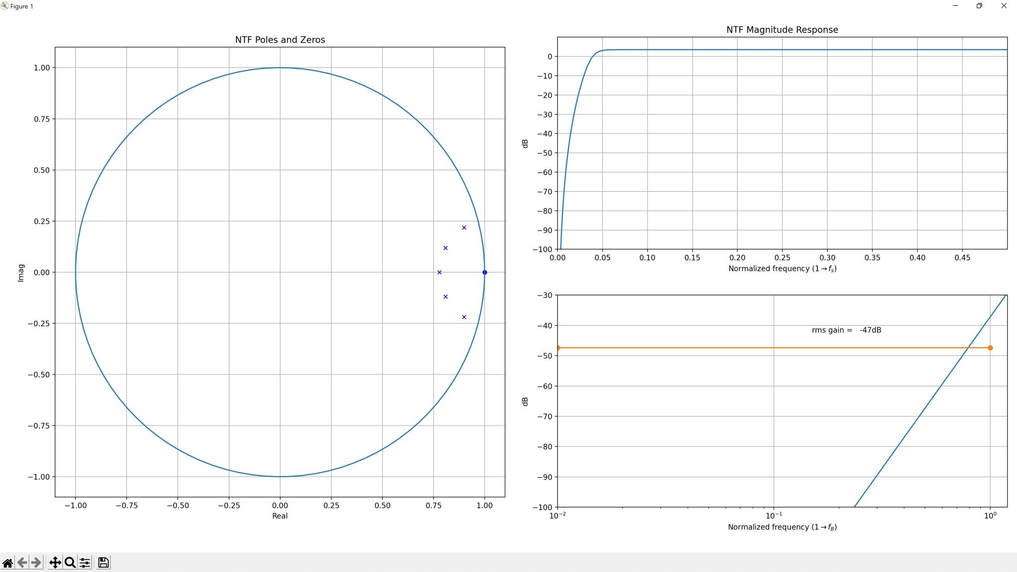

On Github there is an apparently very good delta-sigma toolbox easily installed by PIP however when I installed it I found that it did not function.
python-deltasigma
A port of the MATLAB Delta Sigma Toolbox based on free software and very little sleep
The python-deltasigma is a Python package to synthesize, simulate, scale and map to implementable topologies delta sigma modulators.
It aims to provide a 1:1 Python port of Richard Schreier's excellent MATLAB Delta Sigma Toolbox, the de facto standard tool for high-level delta sigma simulation, upon which it is very heavily based.

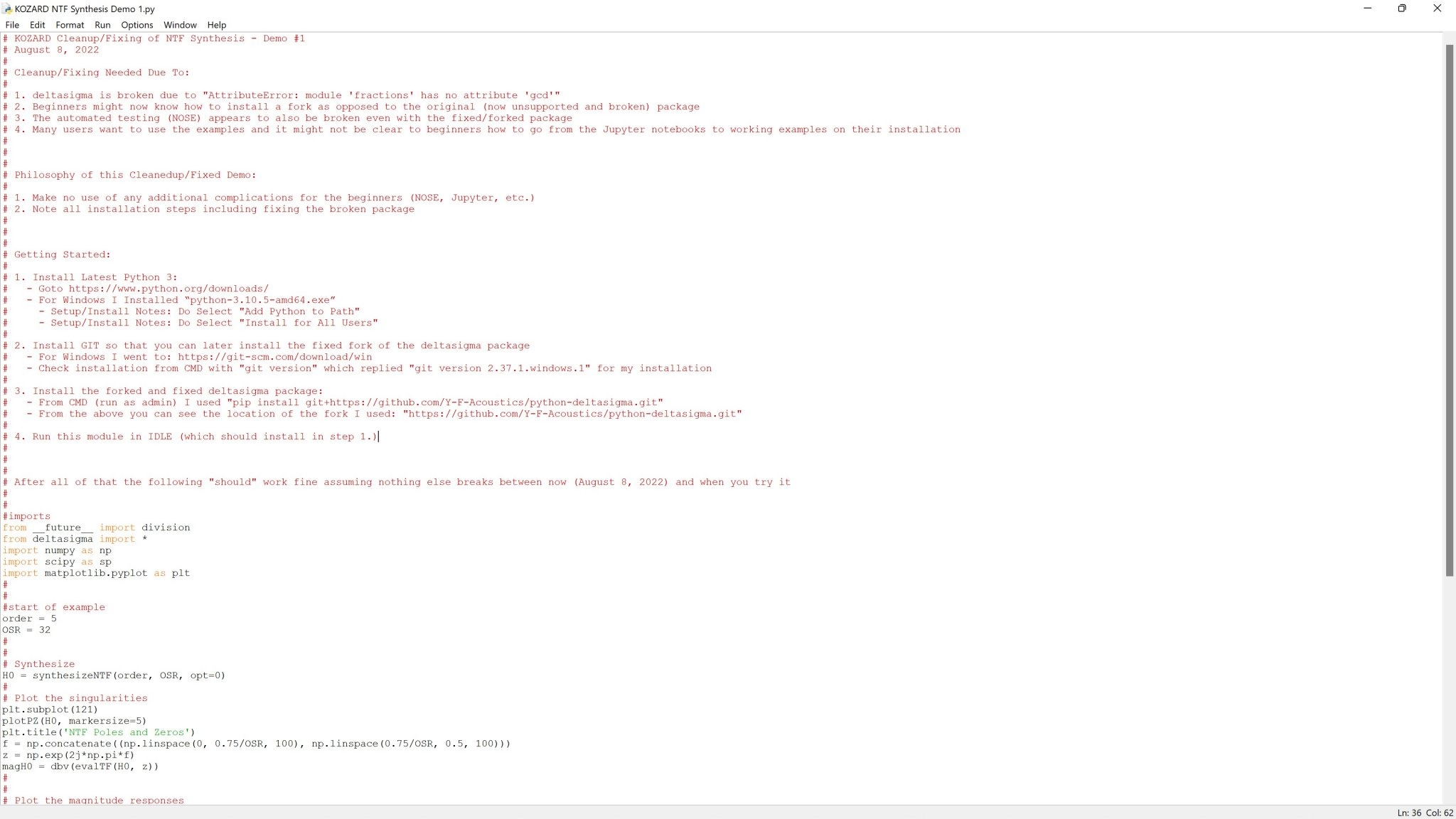

I also found that there were demos in Jupyter Notebooks. That is nice but what I really want is to be able to run code on my Python installation as part of my educational effort.
Next I found a fork of the deltasigma package which was "fixed" so I set about figuring out how to get PIP to install a fork. That turns out to be pretty easy fortunately.
Since others might want to try the deltasigma package (and run into the same little problems) I am posting this first example that I got running:
# KOZARD Cleanup/Fixing of NTF Synthesis - Demo #1
