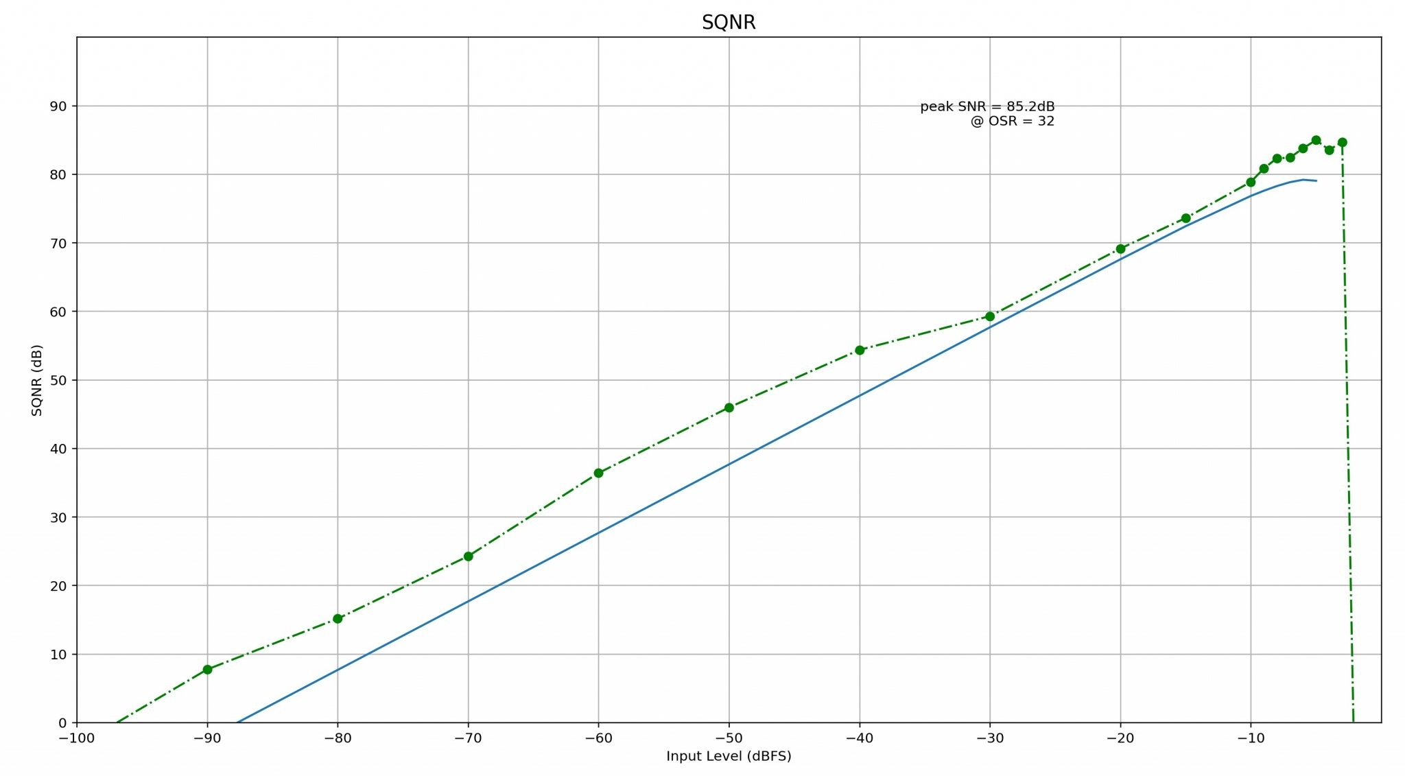

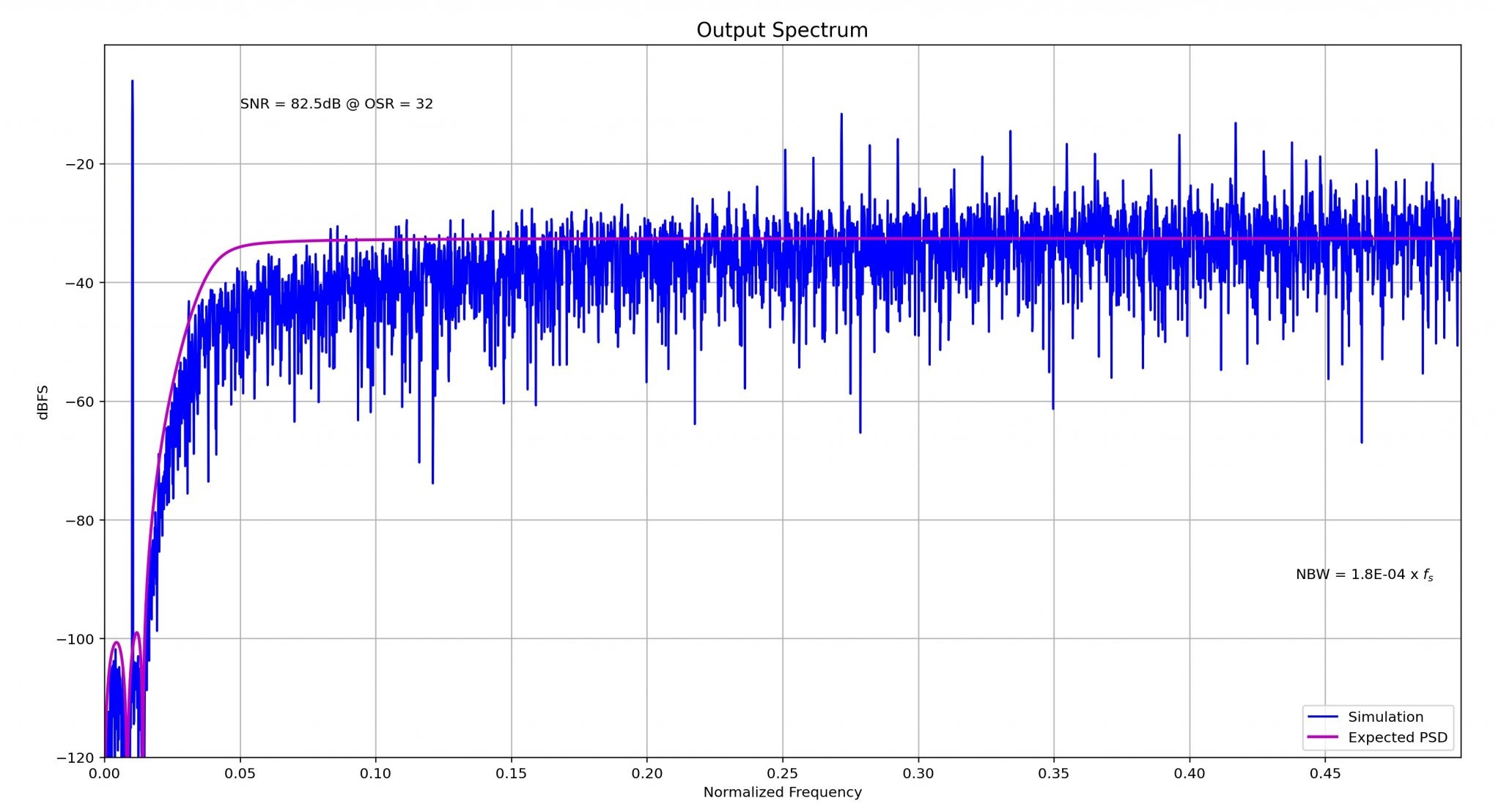

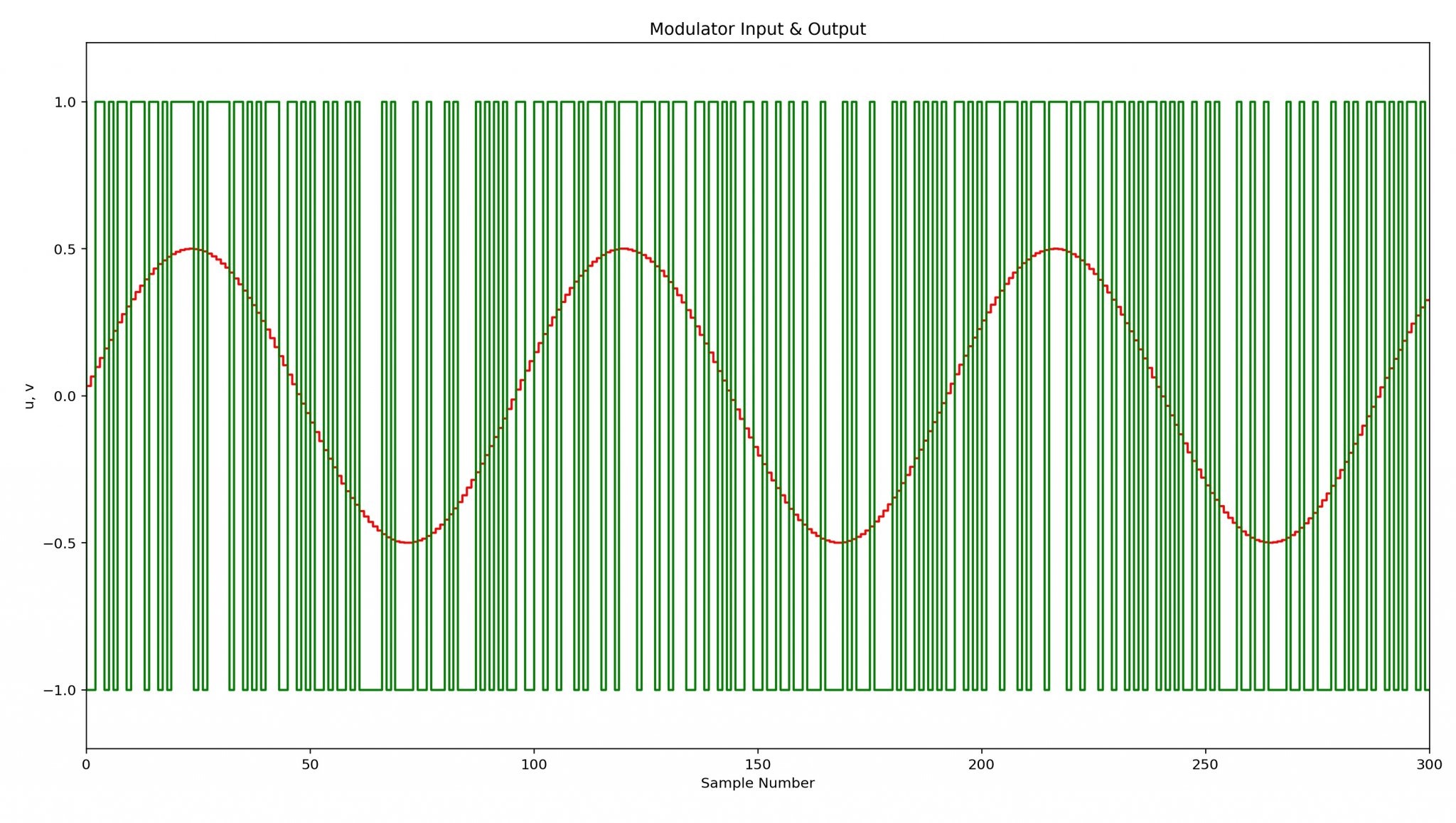

Here is the first part of the second demo: [KOZARD NTF Synthesis Demo 2A 5th Order LP Modulator]
# KOZARD Cleanup/Fixing of NTF Synthesis - Demo #2A
# August 22, 2022

# First part of example
# Time-domain simulation with simulateDSM
# Test sine wave at ftest=(2/3)fb and amplitude of 0.5
plt.figure(figsize=(20, 4))
N = 8192
fB = int(np.ceil(N/(2.*OSR)))
ftest = np.floor(2./3.*fB)
u = 0.5*np.sin(2*np.pi*ftest/N*np.arange(N))
v, xn, xmax, y = simulateDSM(u, H)
t = np.arange(301)
plt.step(t, u[t],'r')
plt.step(t, v[t], 'g')
plt.axis([0, 300, -1.2, 1.2])
plt.xlabel('Sample Number')
plt.ylabel('u, v')
plt.title('Modulator Input & Output');
# NOTICE: Please close the plot window to continue the example!
plt.show()
# Second part of example
# Output spectrum and SNR with calculateSNR
# Uses the output of the time domain simulation in the first part of the example, above
# The spectrum is computed through direct FFT of the time domain waveform and uses a Hann window
# Blue is the computed spectrum and magenta is the expected modulator transfer function in the frequency domain
# Example Fix: Replaced "N/2." with "N//2" (floor) due to TypeError: 'float' object cannot be interpreted as an integer
# Division / of integers yields a float, while floor division // of integers results in an integer.
f = np.linspace(0, 0.5, N//2 + 1)
spec = np.fft.fft(v * ds_hann(N))/(N/4)
# Example Fix (Again): Replaced "N/2." with "N//2" (floor) to get integer not float result for index
plt.plot(f, dbv(spec[:N//2 + 1]),'b', label='Simulation')
figureMagic([0, 0.5], 0.05, None, [-120, 0], 20, None, (16, 6), 'Output Spectrum')
plt.xlabel('Normalized Frequency')
plt.ylabel('dBFS')
snr = calculateSNR(spec[2:fB+1], ftest - 2)
plt.text(0.05, -10, 'SNR = %4.1fdB @ OSR = %d' % (snr, OSR), verticalalignment='center')
NBW = 1.5/N
Sqq = 4*evalTF(H, np.exp(2j*np.pi*f)) ** 2/3.
plt.plot(f, dbp(Sqq * NBW), 'm', linewidth=2, label='Expected PSD')
plt.text(0.49, -90, 'NBW = %4.1E x $f_s$' % NBW, horizontalalignment='right')
plt.legend(loc=4);
plt.show()

snr, amp = simulateSNR(H, OSR)
plt.plot(amp_pred, snr_pred, '-', amp, snr, 'og-.')
figureMagic([-100, 0], 10, None, [0, 100], 10, None, (16, 6),'SQNR')
plt.xlabel('Input Level (dBFS)')
plt.ylabel('SQNR (dB)')
pk_snr, pk_amp = peakSNR(snr, amp)
plt.text(-25, 85, 'peak SNR = %4.1fdB\n@ OSR = %d\n' % (pk_snr, OSR), horizontalalignment='right');
plt.show()

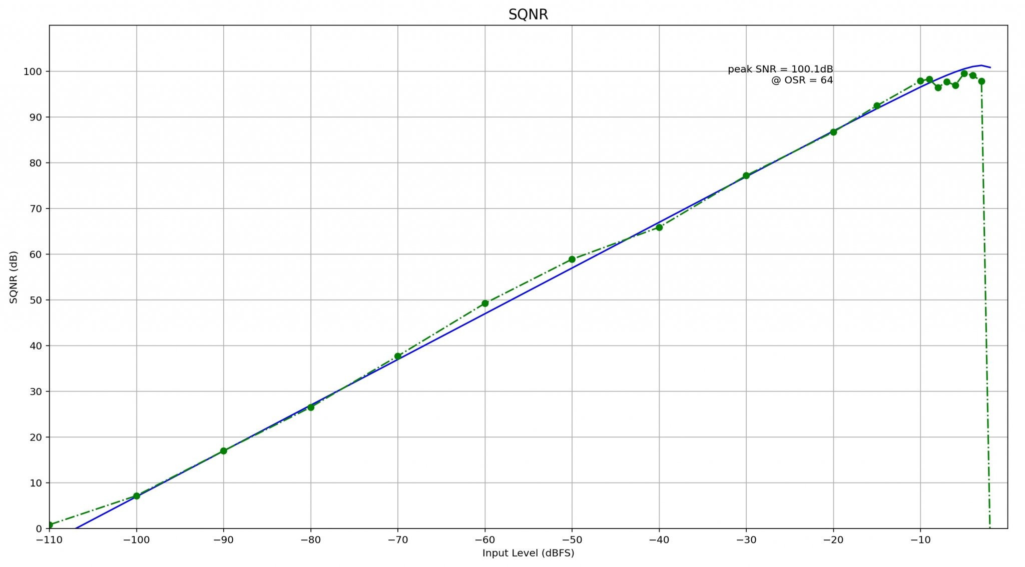

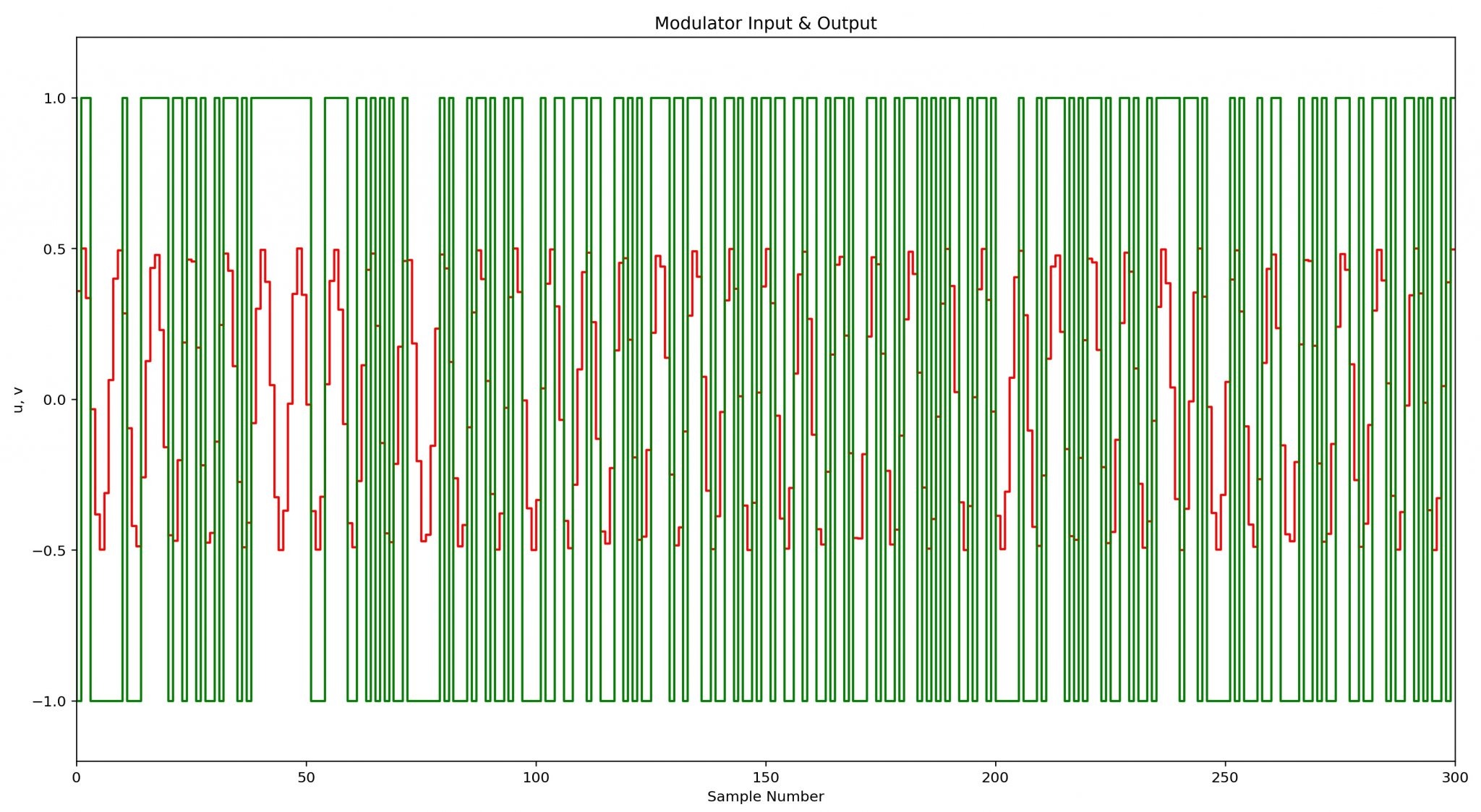

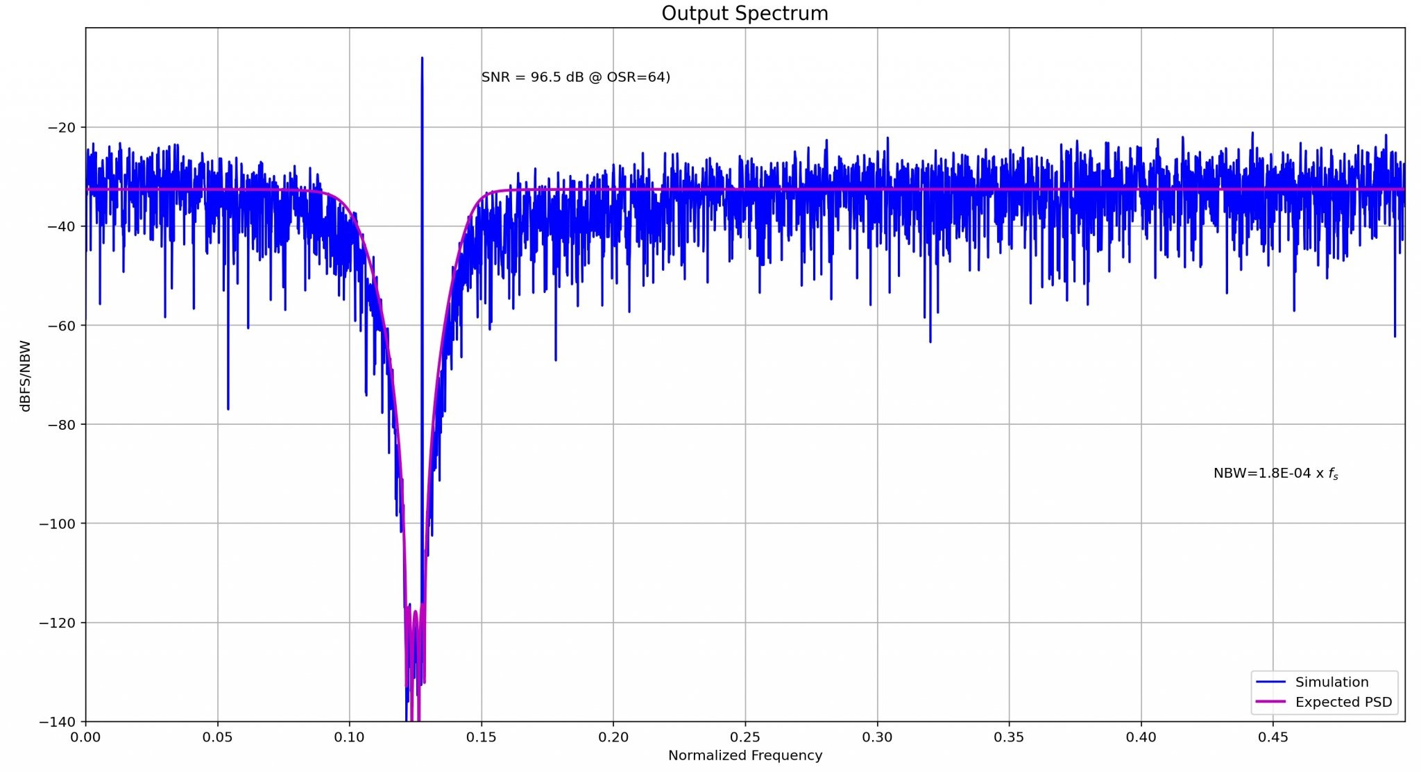

Here is the second part of the second demo: [Bandpass Modulator]
# KOZARD Cleanup/Fixing of NTF Synthesis - Demo #2B
# Test sine wave at ftest=(1/3)fb and amplitude of 0.5
N = 8192
fB = int(np.ceil(N/(2. * OSR)))
ftest = int(np.round(f0*N + 1./3 * fB))
t = np.arange(301)
plt.step(t, u[t], 'r')
plt.ylabel('u, v')
plt.show()
figureMagic([0, 0.5], 0.05, None, [-140, 0], 20, None, (16, 6), 'Output Spectrum')
f1 = int(np.round((f0 - 0.25/OSR) * N))
f2 = int(np.round((f0 + 0.25/OSR) * N))
snr = calculateSNR(spec[f1:f2+1], ftest - f1)
plt.text(0.15, -10, 'SNR = %4.1f dB @ OSR=%d)' % (snr, OSR), verticalalignment='center')
plt.grid(True)
plt.ylabel('dBFS/NBW')
NBW = 1.5/N
Sqq = 4*evalTF(H, np.exp(2j*np.pi*f))**2/3.
plt.plot(f, dbp(Sqq*NBW), 'm', linewidth=2, label='Expected PSD')
plt.text(0.475, -90, 'NBW=%4.1E x $f_s$' % NBW, horizontalalignment='right', verticalalignment='center')
plt.legend(loc=4);
plt.show()

snr_pred, amp_pred, _, _, _ = predictSNR(H, OSR, None, f0)
snr, amp = simulateSNR(H, OSR, None, f0)
plt.plot(amp_pred, snr_pred, '-b', amp, snr, 'og-.')
figureMagic([-110, 0], 10, None, [0, 110], 10, None, (16, 6), 'SQNR')
