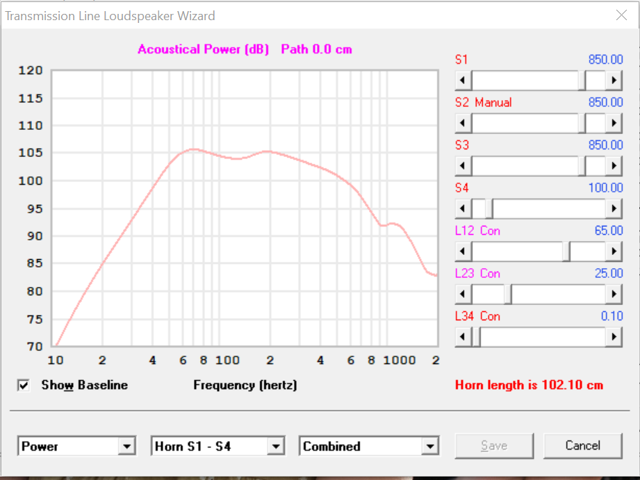

To answer my own post - I decided that it was finally time to learn Hornresp.
I modelled a SLOB using the PYLE driver, and it wasn't a great looking response - probably fairly typical for OB but it would need to be crossed over lower than I wanted to be usable.
After a bit more experimenting in Hornresp, I ended up modelling the smallest possible MLTL I could. Unfortunately the qts/small box was making it hard to develop a low end response without a significant peak. I did however start to have some success by moving the driver close to the port end, which seemed to smooth things up a lot, along with some generous stuffing.

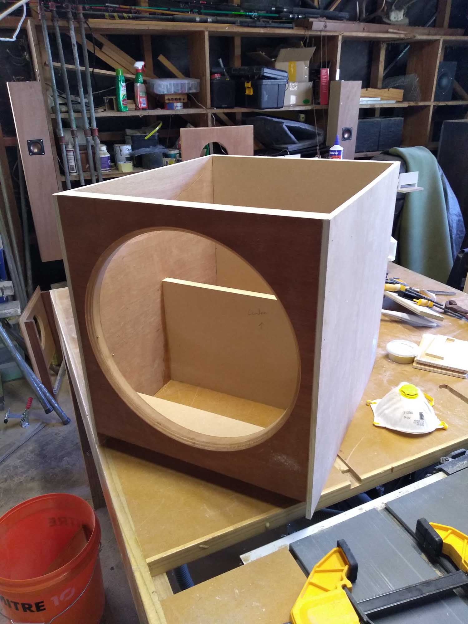

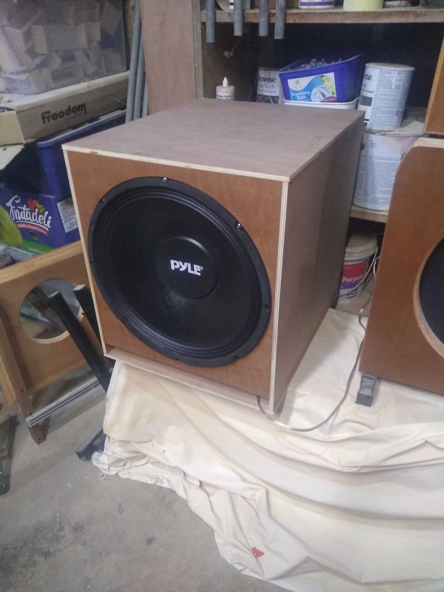

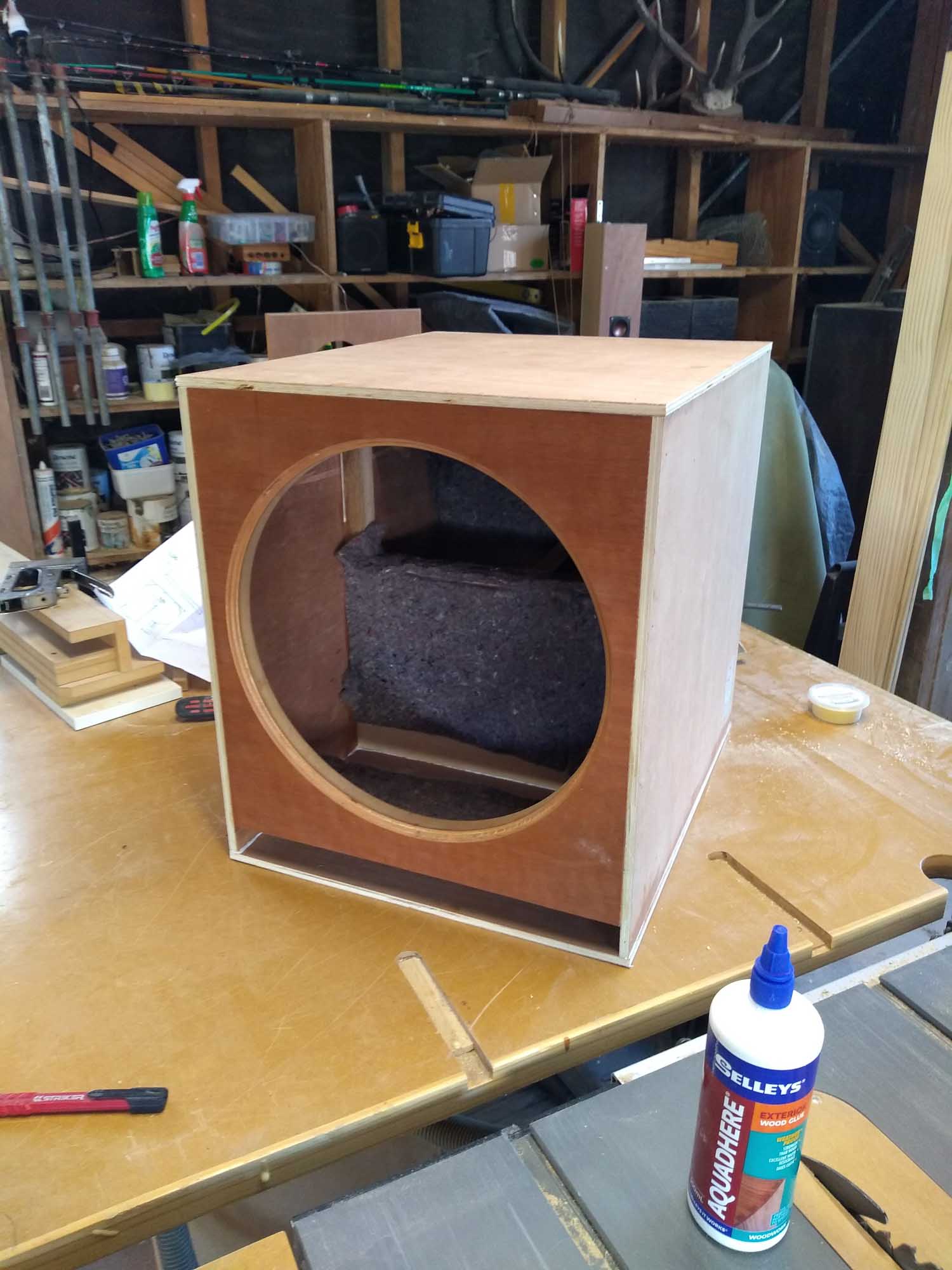

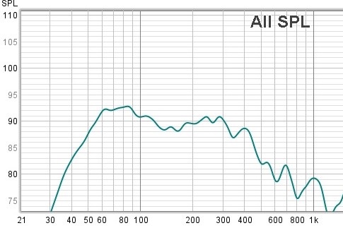

With a couple hours to spare and some scrap timber I put together a test box based on the HR model. I put a divider in the middle to in theory act as a folded MLTL. I had time to take one FR measurement at around 40cm (so includes some 'garage' effects), but it was surprisingly consistent with the modelled response. Anyway, gave me a little more confidence to move onto the next half-baked idea🙂.

Regardless, when there's no response plot and especially if there's no inductance spec [Le] to plot its HF response above its upper mass corner [Fhm], then all the BW we can count on is what the T/S specs predicts up to it where it peters out:
Fhm = 2*Fs/Qts'
Qts': 2*Fs/Fhm
[Qts']: [Qts] + any added series resistance [Rs]: Calculate new Qts with Series Resistor
[Rs] = 0.5 ohm minimum for wiring, so may be higher if a super small gauge is used as a series resistor plus any added resistance from an XO/whatever.
