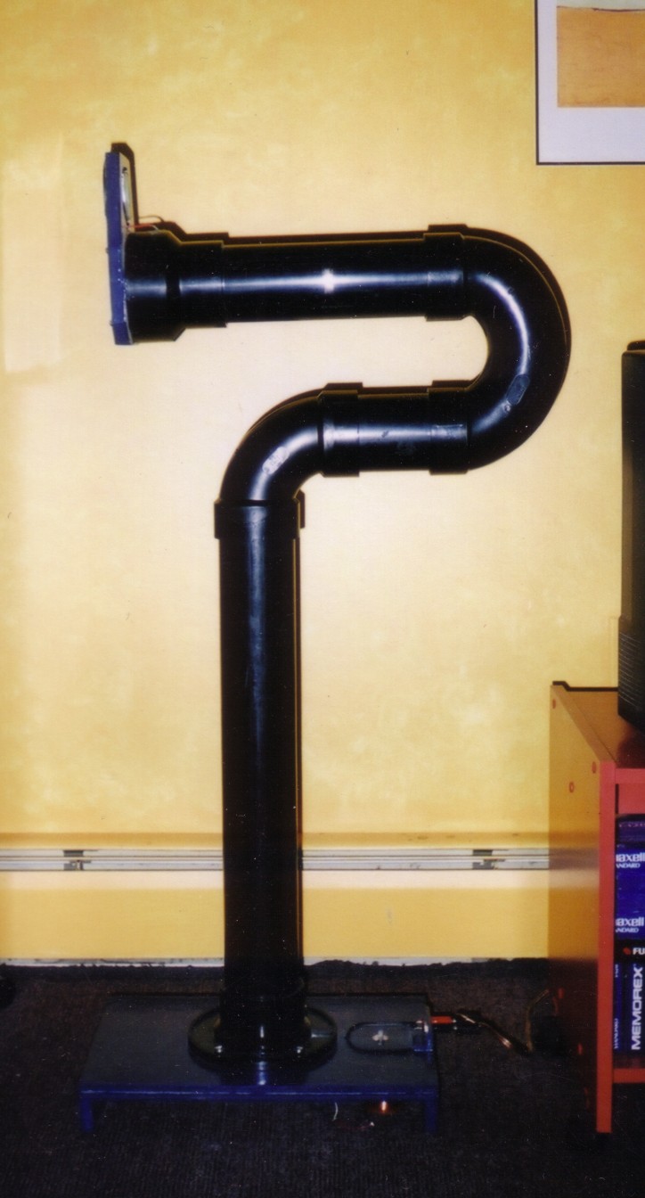

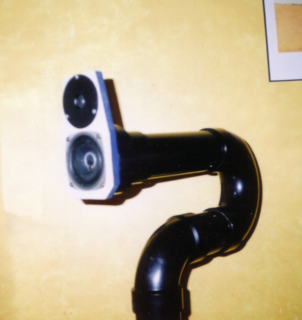

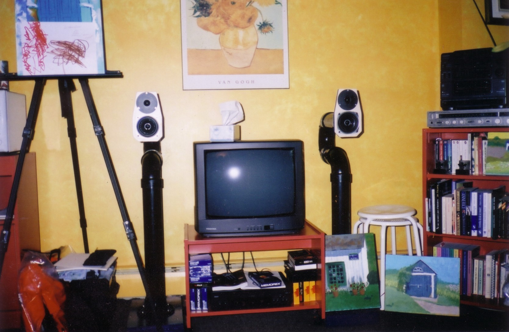

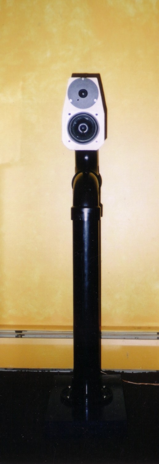

Hi all.
This is not technically a full range speaker, but sewer pipe it certainly is... I built this around 2001 with parts I had. The 'woofer' is a modified Radio Shack 40-1197 (?) with added mass around the dust cap and cone painted with diluted white glue (not the surround!). Tweeter are a pair of Vifa D19TD-05-08.
The 'baffle' came from a leftover piece of melamine kitchen counter (cutout for sink). It is glued with JB Weld to the larger first section of PVC, acting as some sort of chamber for the speaker. Then the main tube has smaller diameter. Not seen on the photos is that the line exit is via a hole in the 3/4" plywood base that is smaller in diameter than the pipe, unknowingly implementing some kind of mass-loading. Whole thing is lightly stuffed with pillow stuffing. The line is deliberately longer than calculations would give for the stock small woofer.
Crossover is a relatively large inductor for the 4" modified speaker, tweeter protected by a 2nd order network (3.3 micro F, 0.33 mH around 5 kHz) attenuated by an 8 ohm L-pad. In other words, very inefficient. But in my then girlfriend's apartment, small living room (photos) with a 20 W/channel receiver I gave her, they made some nice music. Since she moved overseas, they are likely gathering dust in her parents' garage...
I might build something like this again, once hardware stores reopen: I have a few 4" drivers on order... Cheers!
--Christian
