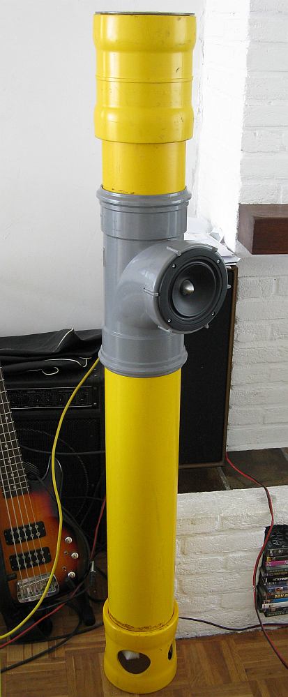

I've been searching for some designs with PVC sewer pipe, and would be interested in any designs and listening experiences. In terms of options we have commonly available (all internal measurements):
110mm - for CHR-70, Alpair 7, Fostex 103E etc
160mm - for JX92S, Alpair 7, Fostex 168E etc
200mm - for Alpair 12, Fostex 208E etc
There are various accessories as well - T junctions, 90 deg. bends, stoppers, access pipes etc which would facilitate a speedy construction.
The other interesting possibility is to put a pipe within a pipe and fill the space between with sand. So 110mm inside 160mm, 160mm inside 200mm, 200mm inside 250mm. Should be pretty inert!!
So how to proceed with this? I can't see it being possible to taper the pipe, so bass reflex is an obvious option. But what could I do in terms of a tuned pipe - ideas?

I've been looking into this some more. I like my idea of 2 coaxial cheap PVC tubes with sand in the middle. An alternative would be the high pressure type PVC tubing = walls from 7mm to 12mm. But this gets expensive, alas. Sand is cheap!
I'm looking at suppliers here in the UK. Debating how to mount the forward pointing speaker - I can see a few options here! 110mm square hopper looks good - gives you a nice square front tapering down to 110mm pipe - very easy to bolt on a baffle. I'm thinking tall and thin, so thinking of a t junction 2/3 way up rather than a 90 degree bend at the top. Early days! But I'm getting restless to go out and get some tube to play with. Rob Sampson calls it "audio Lego"!

I've fund a nice website in the UK which looks good value. Current thinking is to use 160mm pipe. T junction triple socket to mount the speaker unit forwards, cap on top and plain pipe going down, then some sort of base. This could be enclosed in a square box section with sand in between. Cost for a pair of these - pipe plus T plus cap on top - is £71.10 plus VAT.
Given the above I'm thinking bass reflex, and estimating about 21 litres. Drawback with this is that something like a Jordan JX92 or a Alpair 10, which fit into a 160mm pipe, don't really require 21 litres. An Alpair 12 which would be nice doesn't fit into a 160mm pipe! Back to the drawing board, but I smell a very non-resonant enclosure here and quick to make - no need for internal bracing etc. Just have a top which can be unscrewed to have access to the interior.

Beats the hell out of bose cubes!
Terry

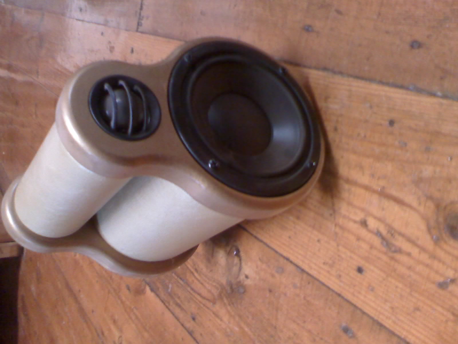

I bought 4x 8" full range driver on ebay for £3 ea with postage, and was experimenting with using traffic cones as rear tapering tubes.
In an effort to partly imitate the B&W nautilus tapering tubes (albeit on a next to free budget)
The small cones fit an 8" driver almost perfectly and the large ones a 12" woofer. The ends are open, so can be closed, stuffed or extended.
I still haven't got round to getting any testing equipment, but the basic project cost under £15 and sounded pretty good.
Has anyone else tried this, or seen it done?
