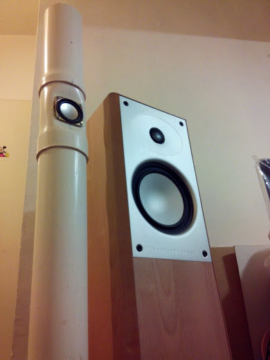

This is my 2" PVC quarter wave TLs project. The sound is amazing and bass is comparable to my Floor-stand speaker! 😀
The most tricky point in this project is to determine the driver offset. I tried various offset ratio and found that between 1/5 to 1/3 (may be @ 1/4) are most optimum in sound.
However, until now there are no clear direction on determine the optimum offset ratio and I still need further studies 😕

can you tell the materials you used for this proyect? is a 8 inch pipe?
My woofer pipes are huge at 76" tall! I stuffed each one with a Dayton Audio RS225-8 8" Woofer.
