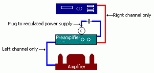

Listening power supply
With feedback free stage, every variations on power supply flow directly on the output. It is interesting to listen it. For this try, I plug CD only on left channel preamplifier, turn sound control at maximum, use capacitor (10uF) to link regulated power supply to left channel input and send to the amplifier only left channel output. (see picture)
After this try, you understand that using regulator for each channel could enhance sounding.
The Conrad Johnson 'Premier Ten' preamplifier does it.
