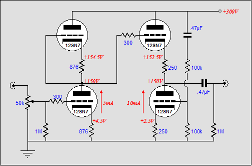

Puzzling SRPP input stage on 300B SE amp
At first sight what you draw is not an srpp but looks more like a mu follower ( maybe it is an error in the sketch because 2,2K resistor is coherent with an srpp but it is not located where it should be EDIT: maybe not after all. I'm used to see same value for cathode and 'in between' plate cathode resistor on srpp. So the resistance should be 2,2k on both. Mu followers have more parts used... so i don't know what kind of circuit it is. ) .

front end is identical with the "Aikido" input stage, except for C1. To get the top and bottom tube non-linearities to cancel, leaving linear mu/2 gain, the calculations require no C1. So we have two non-linear 12AU7 sections in a linearising circuit, that is unbalanced again, to be non-linear. Maybe by some miracle it is cancelling 2nd Hamonic distortion of the 300Bs. Or maybe they just needed a little more gain.
Anyway, for hum, the 1st thing to try would be changing the front end V1 and V2. Maybe some heater to cathode leakage in one of them.
Aikido from Broskie's site:
