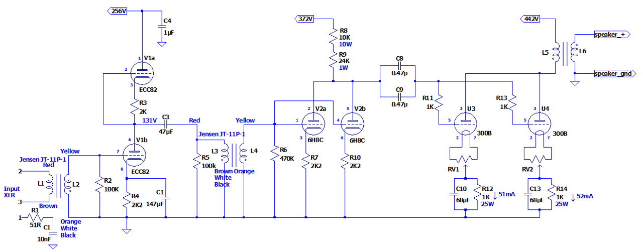

Looks like a half fast implementation of an active plate load. I've seen the same thing donw, but with FETs. Probably more of a solid state guy who doesn't understand that triodes don't make good constant current sources the same way FETs do. As for the rest of the design decisions, I have nom idea.Hi,
At first sight what you draw is not an srpp but looks more like a mu follower ( maybe it is an error in the sketch because 2,2K resistor is coherent with an srpp but it is not located where it should be EDIT: maybe not after all. I'm used to see same value for cathode and 'in between' plate cathode resistor on srpp. So the resistance should be 2,2k on both. Mu followers have more parts used... so i don't know what kind of circuit it is. ) .
No reason for the second jt11p but maybe designer wanted to have it's pre stage galvanically isolated? Maybe he had an humming since start of built and though an interstage could solve this? Or he liked the sound of jt11p ( which doesn't really have a sound ime)?

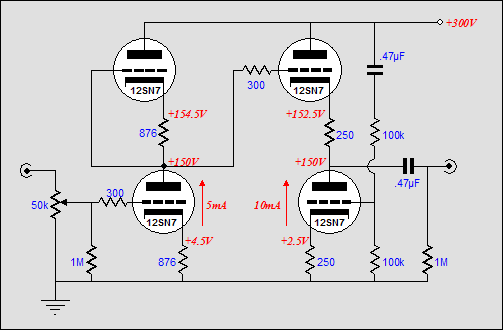

This may help. From Valley and Wallman, Vacuum Tube Amplifiers.Looks like a half fast implementation of an active plate load. I've seen the same thing donw, but with FETs. Probably more of a solid state guy who doesn't understand that triodes don't make good constant current sources the same way FETs do. As for the rest of the design decisions, I have nom idea.
Looks like the schemo from the first post was incorrect, and it was an SRPP after all. Interesting article.

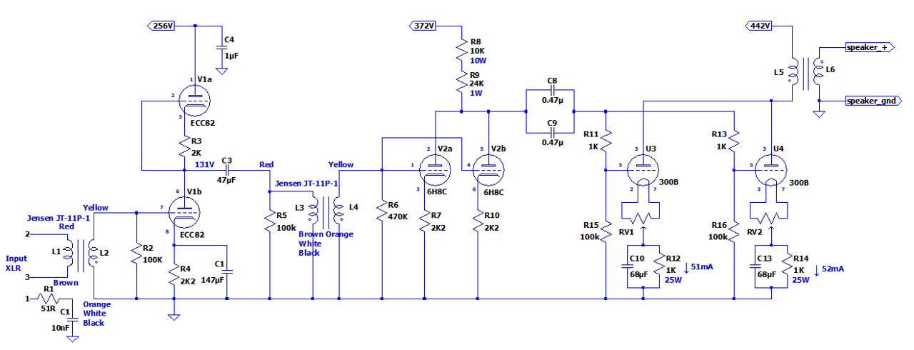

@jan.didden: Have you modelled SRPP? Have you had correspondence with John brosky on SRPP? You do not want to bypass the top cathode, distortion goes up considerably.
Back to the issue: Is the filament of the ECC82 elevated? You may have exceeded the Vhk and there is h-k breakdown.
Unless you also bypass the bottom cathode, then the low distortion is preserved.@jan.didden: You do not want to bypass the top cathode, distortion goes up considerably.

Thanks for this explanation. I’ll try swapping V1 and V2 with ones in the 2 good amps that I also have. There are 4 of them. Only 2 are humming.front end is identical with the "Aikido" input stage, except for C1. To get the top and bottom tube non-linearities to cancel, leaving linear mu/2 gain, the calculations require no C1. So we have two non-linear 12AU7 sections in a linearising circuit, that is unbalanced again, to be non-linear. Maybe by some miracle it is cancelling 2nd Hamonic distortion of the 300Bs. Or maybe they just needed a little more gain.
Anyway, for hum, the 1st thing to try would be changing the front end V1 and V2. Maybe some heater to cathode leakage in one of them.
Aikido from Broskie's site:
One other thing I haven’t seen before is that the builder had custom mains transformers built with 400V-0V-400V and 350V-0V-350V windings. Each of those is rectified by a GZ37 and CLC filtered with 47uF/10H/47uF. 442V from the first one feeds the 300Bs. 372V and subsequently 256V from the other feeds the 6SL7 and 12AU7. Usually the voltages for the first and second stages are derived from one set of windings.
I wondered whether the heater of the 12AU7 might need elevating but but it has a Vhk max of 200V.

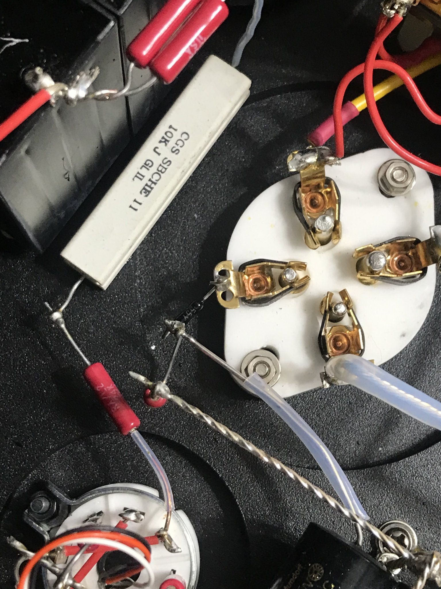

The 2 of the 4 amps that hummed really badly had bad joints in the very badly constructed earth bus.
After fixing them and re-wiring the earth bus in all 4 amps, I realised that all the amps were noisier than they should be. The original builder had put these huge fancy caps in the power supply that were actually only 47uF. I've added 560uF in parallel and all 4 are now much quieter.
Not only were the cases of the line input transformers screwed to the chassis but the white case wires were also connected to the earth bus creating a couple of loops.

As connected the upper triode of the first stage is just a diode. No Rk.😉
There should be at least a One K cathode resistor to make it a mu follower.
