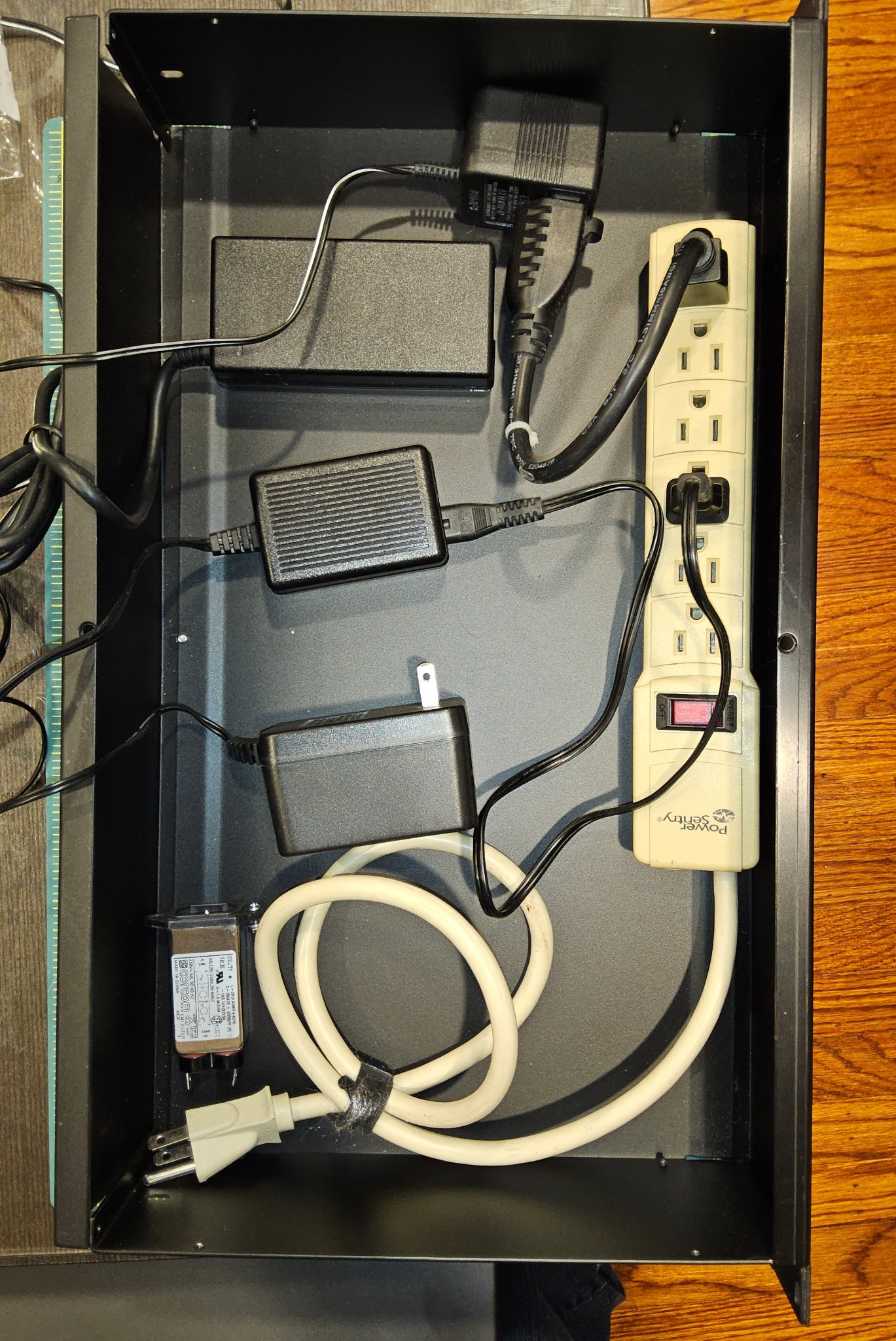

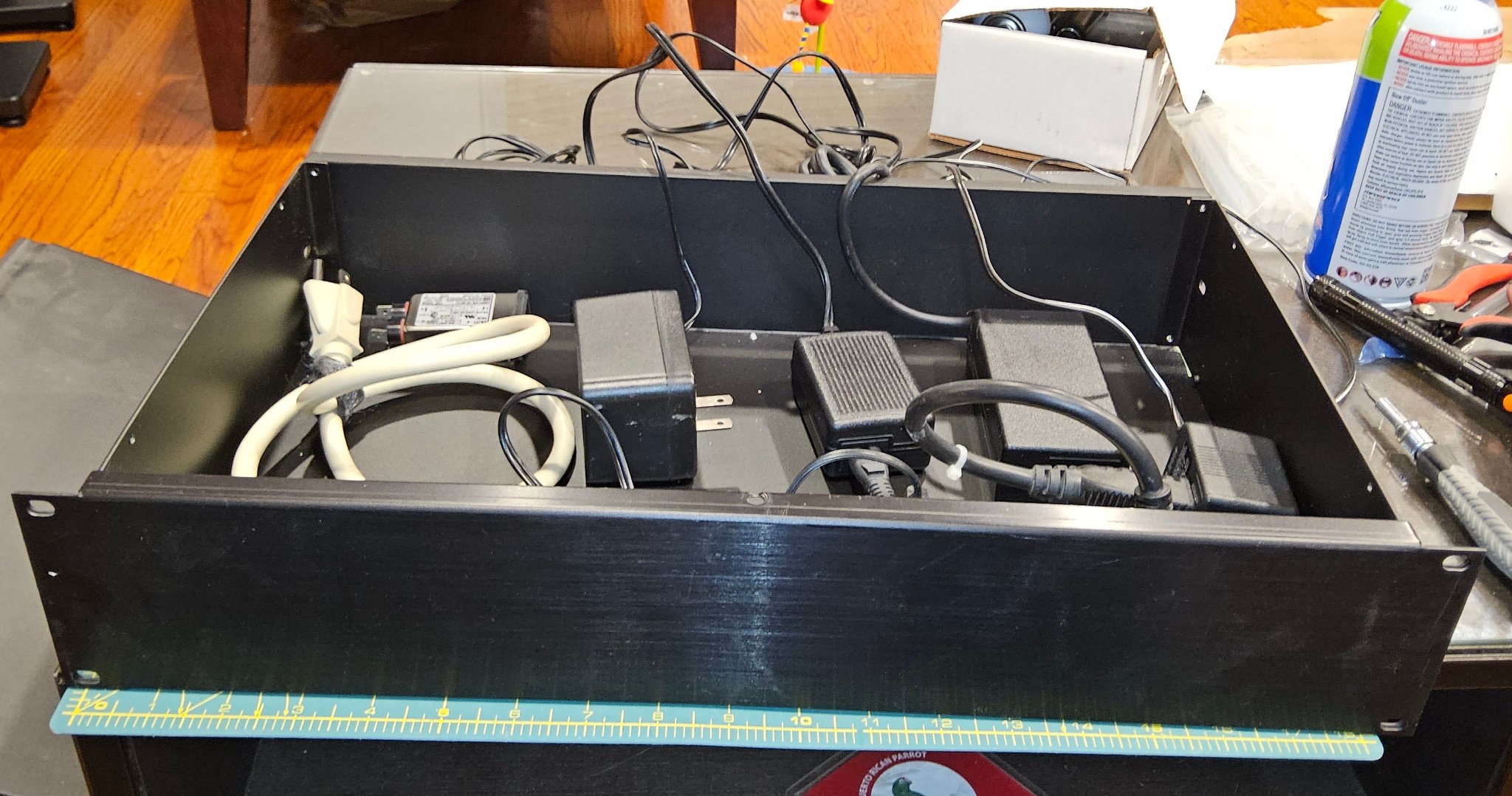

Here's the mockup. Plan is to use the iec inlet with attached filter, i had one lying around. I'll cut the power strips cord, attach to iec with crimp connectors. Ground from iec goes to case. Ground from power cord goes to same spot on the case. I may have to mount the power strip so the outlets are horizontal. The DC outs will go through holes that have rubber grommets.
I may use a lighted switch on the front.
Do you think I should put a fuse in it?
I would use a fine mesh in a frame as a front door, for ventilation, and keeping bugs out.
And the power strip: open it out, see the sockets are of good quality, or else do what I did, basically a wall outlet set in a conduit box. That will be more rugged and longer lived than a power strip.
Fuse AND breaker, essential, no doubt of that.
Fuse in a location that allows easy replacement, put a fast or slow blow as per your judgement.
Lighted switch, or LED indicator, use what you like...
Solder and heat sleeve the strip wire instead of crimping, fast and no chance of crimp ageing.
I thought best practices dictated crimp on ac mains. It's the way I've always seen it on hundreds of builds here. And it's never soldered on home ac wiring, at least here in the US, although that will get into a debate of wire nut vs wago, which I don't care to engage.

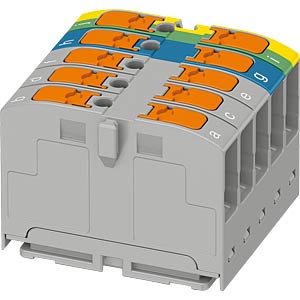

A DIN rail with connector blocks is the usual way here. Very reliable. Quality stuff. Power strips and wire nuts are not OK for this purpose. Normally the PSUs are clamped with clamps to the casing. As written earlier (but no reaction) the casing will need either minimal ventilation or outright cooling vents both in the bottom and in the upper or back cover to have sufficient air flow. Only way to know what is needed is to dry run and measure temps. The reliability of the average wall wart/adapter/SMPS depends for a large part on the temperature. If it would be my distributor I would even use standard open frame PSU modules meant for case mounting.
A fuse is necessary. Always. Multiple fuses so per PSU can be done too but seems a bit overdone. On the other hand selectivity can be built in then. A switch is just clever to add in case you sometimes leave the home and stuff stays unattended. When stuff is not done right your insurance will have an issue with you when the house burns down. Usually these are of the precise type of people with little laissez faire mentality.

Contact blocks with springs to clamp the wires instead of screws are sold by many contact makers.
They claim better reliability, as screws may come loose, but springs do lose tension if they get hot.
I would add to the suggestion made by Jean-Paul, simply use different colors (computer SMPS style) for +5V (red) and +12V (yellow) for example, for the contact blocks.
