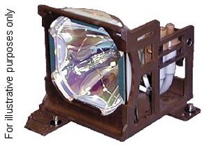

I have done little more research now and I have found out that it´s impossible to find a cheap uhp-bulb that can be placed in the old uhp-reflector-module, they just don´t sell them. Not to mention that the uhp-bulbs can explode just by looking on them.
More interesting is that the price of different uhp-lamp-modules vary with over 2.5 times the cheapest lamp. This opens new opportunities, if you know the wattages, voltage and the shape of your old lamp, there are big chances that you can find a cheaper lamp-module and change the "reflector-lamp" and place that in the old plastic-cover. There are many projector-modules that use the same "uhp-lamp-reflector", they have only different platic-cover and then they charge 2 times the price for the same lamp, I think this is a damn bad way to fool people.

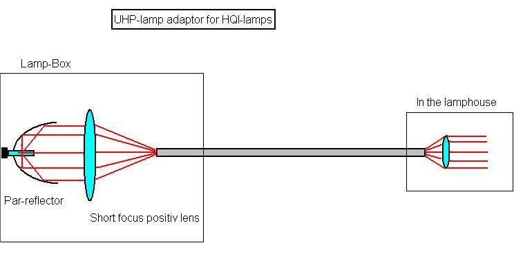

Here are my lastest thoughts about puting a HQI-lamp in a commercialprojector. The biggest problem with this is that a HQI-lamp is very big compared with a uhp-lamp and a big lamp with a large arc need a big reflector to use all the light from the lamp. The smallest lamp available to normal users is the HTI 150W lamp with an arc size of 4-5mm but it only last in 750h and is not so cheap and it´s still to big. To place a big HQI-lamp with a big reflector in a small commercialprojector is not so very easy (impossible) and if you make changes to the case it´s hard to sell the projector later if you want to do that.

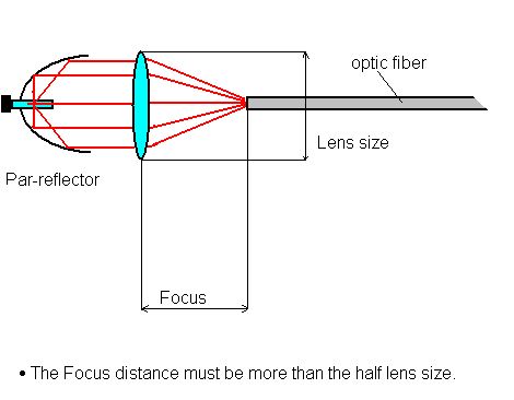

I think the best solution is to use a separete lightbox with fans and use fiberoptics to led the light to the projector. In this way you can use what type of HQI-lamp you want and you don´t have to worry about the heat.
I have done some tests with fiberoptics and it works very good, but we need a thick fiber or many fibers because it´s hard to concentrate the light from a HQI-lamp to a small fiber.
I forgot to mention what I mean with short focus positive lens on the lamp side. The incoming light must have smaller angles than 45 degrees from the fiber axle, otherwise the light will not follow the opticalfiber and you will lose a big part of the light. So the lens must have a focus length that is more than the half size of the lens or reflector size.
This is an interesting idea Mathias.
I see no reason why it would not work in theory. I think fiberoptic cable would be to hard to work with unless they make it in large sizes. Because the angle of incedence of the light inside the tube is so high there can be high reflectance even for a white plastic tube. Yet it seems that it would be so much more efficient if you could get a highly reflective smooth surfaced flexible tube of around 20 - 30 mm size.
I have seen some white plastic tubing that is semi flexible but still hard enough to have a shiny surface finish used for some kinds of lab plumbing. I wonder if that would work.
Also because of the light loss it might be wise to oversize the light source but because it is in a seperate box it does not have to be so small. You could use a large cheap industrial 400 watt metal halide and a large reflector and a hand made large lens to focus the light into the optic tube guide.
The straighter the optic tube is the better as there is less light loss.
One other idea is to use electrical conduit and run some kind of lapping material through the inside to polish it up. Also, though it is expensive there is stainless steel tubing available and it could be polished on the inside to a high luster with a rotating lap turned with a drill.

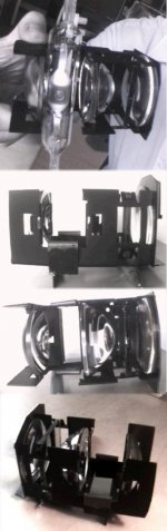

I did some testing with the lightengine...
When I first got the new diaprojector lightengine I didnt try it out of my projector, I just put it into the projector in a way that it worked. Today I took some of the projector apart for another reason but I also decided to research the light engine bit more.
First I tried it as it was, just testing how the position of the lamp affects the beam... well.. the thing seems to pretty much project image of the flame :B Position made it bigger and smaller... Then I took the second condenser lense (the thin last one in the setup) away and now the beam was much more even, although it still was a bit flame imageish but not that much, and actually it looked a lot more like the beam of the original UHP lamp. Then I tested the thing without the spherical reflector... not a difference to see with human eyes... I slipped the reflector back in its place and all that it did was that it added round thingies around the beam. I think I can't get any more light with this reflector, it should be bigger one and so on, just like mathias has told. The flame is just so big compared to the reflector that it just doesnt do anything, and the outer glass of the bulb is so big too that I cannot get the flame as close to the reflector for it to work well, and sadly, the outer glass is about the same size on those single ended bulbs too :\
I think that the best option, if we dont want to use big reflectors and bigger external light boxes and light guides and such, is to just use the light that comes straight forward from the lamp. It means that there is quite a big light loss but what can you do 🙁
Many people use 250w MHs on their projects, I use 150w one and with this method I get very well viewable resultss, ok to use even in daylight with somewhat thick curtains on, so I am pretty sure that a projector retrofitted with 250w MH using this method should get pretty good results, probably even a lot like with the original 120w UHP lamps.
