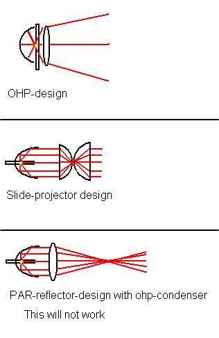

see no reason why you could not use a condenser lens with the PAR reflector.

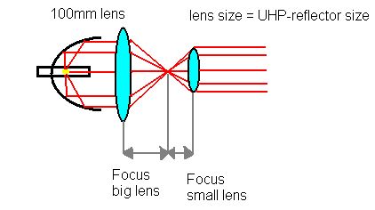

Yes I realized that, I though Ace ment another type of condensors. There are two way condensors are used, slide-projector-design and ohp-design, I think Ace mean the slide-projector thing and with that you must use a 10 degrees or smaller spreading angle reflector, because you must have parallel rays. But the slide-projector-design is just to get the light more even, it will not be stronger. In a ohp-design the condensor amplify the light from the bulb and that design will not work with a PAR-reflector.
I have never seen so big condesorlenses that you must use with the slide-projector-design, they must be atleast 100mm in diameter to fit a PAR30-reflector and forget magnifying glass, they change the color of the bulb so it looks green.
lol na the dual condenser system, condensers to work properly are actually meant to be used in pairs, they intensify the beam and can spread, even, or maintain the beam of light, pro projectors use them, the earlier ones that used the par reflector but now days u will find they use eliptical reflectors thus having the maximum light gain from the bulb and a focal point on the reflector to a single condenser system, the last par design u have draw will work but i would certainly hate the see the focasl of the frensel needed, it may be ok for a small lcd but u would want the reflector the same size as the lcd at at the right distances ofcorse.

sorry mathias i mis read your last pic very true it wont work with a ohp condenser, the only condenser to use for that would be somthing like a double convex and all that would realy do is intensify the light coming from the reflector, once again ok if u have a lcd the same size as the reflector and if u had that kind of a distance to the frensel wich no doubt would be long, even with that said u could ajust the light rays that are coming from that type of reflector to not come out so paralelle to suit a shorter focal system.

Thank you for some info on condensors.
The last design has a big problem and that is why I say it´s not working, you get a sharp picture of the reflector on the lcd, even if you get it out of focus, you can still see the reflector. I have tried that and it´s a really bad solution, don´t use it, it´s a waste of time. If you try to focus the light in the reflector and put a single condensors in front of it, the problem remain. So I recommend using the slide-projector-design.

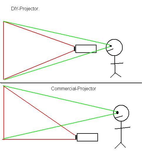

Here is a problem with the diy-projector, and this was the first thing I noticed when I switched on my commercial-projector, In all diy-projector-designs I have seen here no one have solved this big problem. You can place a commercialprojector on a table and it´s not stand in the way for the picture. This is why you can mount a com-projector in the roof, without touching the keystone.
