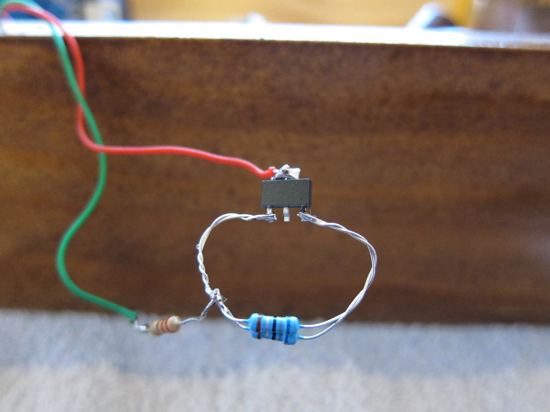

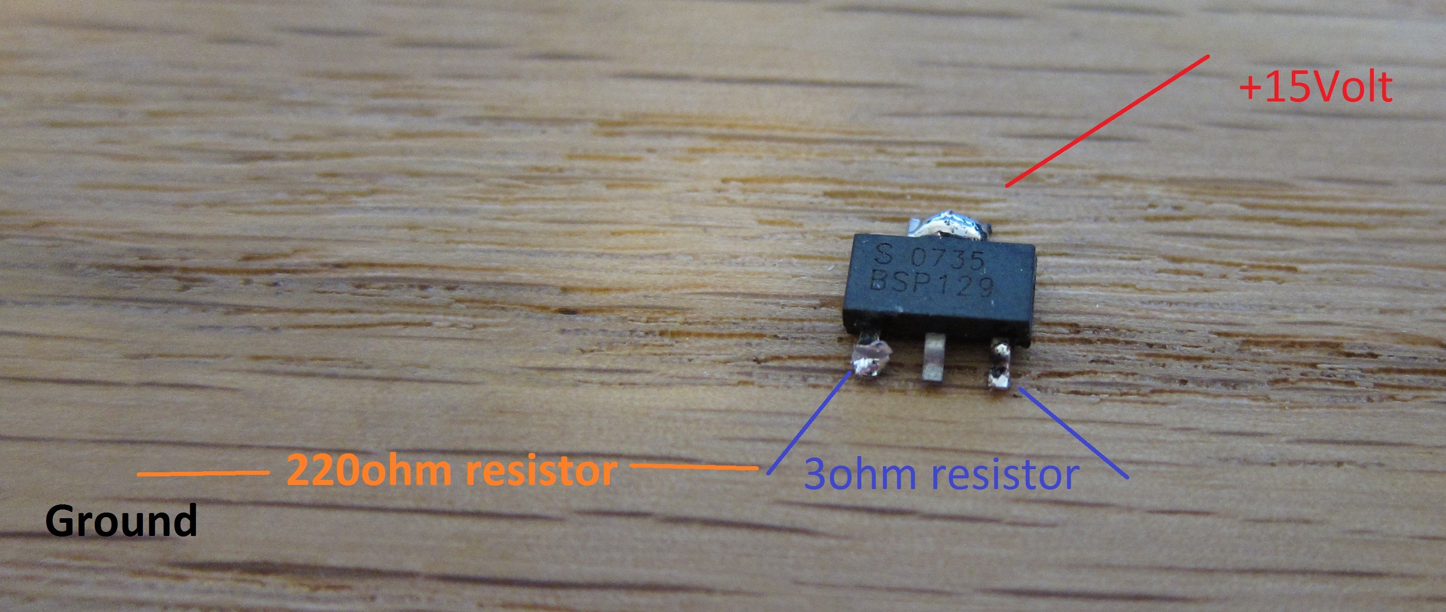

Hi Guys,
Still have the same problem... i tried again a brand new BSP129.
I made a simple test setup as in the picture. Still zero current so no voltage over the 220resistor.

Hi Guys,
I can assure you that this circuit when completed exactly as designed does work, and very well in this DAC.
I can only reiterate that your best chance is to *complete the entire circuit as shown by Peter* using the correct value components, and unless the components are down on spec the results must be OK.
I did mention earlier that resolving problems when there is a departure from the published design is not what I wish to spend my time on, but looking back at your original comments that placing a finger on the device seems to enable it to pass some current, suggests to me that you may have some stability problems here.
The added capacitance to ground resulting from the applied finger could be affecting this instability, although I have not experienced any such problems with any of these BSP129 devices myself - unlike the associated AD811 which is very sensitive to stray capacitance through poor layouts.
In this regard (and I don't wish to be overly critical here) that layout you show is rather a mess anyway, and when constructing the entire circuit you will need to keep all components very tightly together with minimal lead lengths etc, or you will have all kinds of problems for sure.
It is now after 1.00 AM here in the UK and I need some sleep now, but please don't expect others to resolve your problems for you unless you are fully-prepared to take the sensible advice given to you.

You need to build the regulator circuit exactly as posted, the complete version, then we can discussed the results.
Thanks for your inputs. I build the entire DAC and regulators as posted. When i turned it on the first time there where no voltage showing up on all 3regulators, that's why i build a dummy current source with the BSP129.
After further investigation today i notice that my BSP129's don't perform as the INFINEON or Siemens datasheets says. Both are different from each other. For both of them they can work with a 0 Vgs and still show current (Ida) between 80-150ma depending on the brand. My ones which i don't know the brand of unfortunately does not perform this way and needs a positive Vgs.
Any suggestions on where to get the infineon BSP129's?
Best regards,
Best regards,
I am sorry to hear this, especially as you said that you have 50pcs of them. In view of what you now say they must be fakes, which on reflection is perhaps not too surprising, because a 'genuine' BSP129 does not behave like that.
Had you mentioned earlier (when I first commented on the other reg components) that you had already tried 3 complete reg versions with identical problems, it would have saved some time and head-scratching perhaps, and I would have asked about their source as I did suggest the possibility of devices being out-of-spec.
For some obscure reason, since I have been using these depletion mosfets I have noticed worldwide shortages from time-to-time, a matter I mentioned to Peter when I first suggested that he might like to try this circuit in his DAC. At that time he also found they were not readily available, and the lead times at the UK distributers I checked for him were all for several months delays.
Around the time when I first used BSP129s I was involved in a commercial design with a tight deadline, and I had to abandon my intentions to use the devices as none were available and lead times were unacceptable then.
I obtained a batch of the only practical alternatives I was aware of, Supertex DN2540, but on checking the entire batch their parameters varied so much that the current-setting resistor would need to vary by 200% from the two extremes! This would result in the unacceptable complication and additional costs of measuring each individual device and selecting resistors on test, so they are not my preferred choice for this requirement.
IIRC, several of their parameters were substantially different as well from BSPs, and as an example I recall that the current-setting resistors needed to be considerably higher values for similar currents than the values I use in the BSP-based regs.
During the time when I have been using BSP129s, I have never seen any genuine devices offered for sale other than the Infineons, and I have done a lot of searching around. Accordingly, I would be wary of anything of unknown pedigree as it seems that whenever any devices are scarce or still popular after their discontinuation, there are unscrupulous vendors around who will take advantage of the fact.
Some years ago Peter, myself, and many other Forum members were 'taken-in'
with a group buy of discontinued dual J-Fets, but due to the integrity and efforts of the organiser who had himself been duped, most of us received most of our money back.
Hopefully, you will be able to recover your outlay, but as a favour to other members please tell us where they were obtained so they can avoid falling into the same trap.
