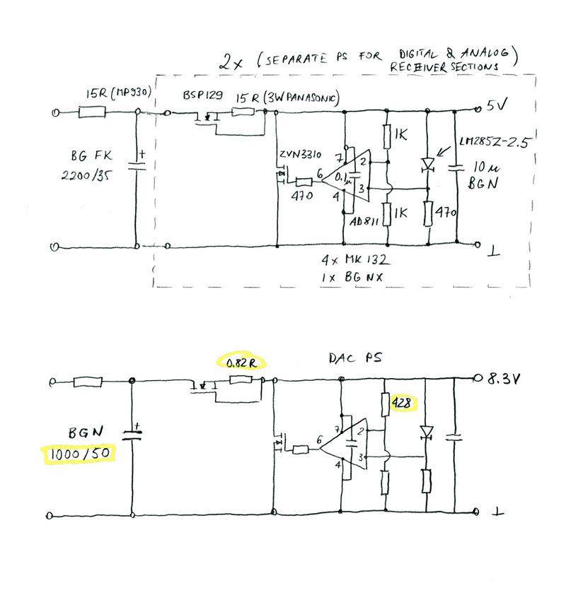

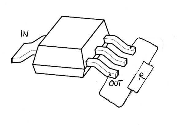

I'm trying to get the voltage regulator to working. For some reason the BSP129 Current source does not work. The BSP129 are new but give zero current.
Also tried to connect the gate and source together with 15v at the drain still same problem.
Pin 1 is gate

If as you suggest here there is is no output after the depletion mosfet, unless the connections are not correctly arranged, this implies that the mosfet is damaged.
This arrangement with a resistor and a depletion mosfet is a text-book implementation for restricting currents, and being so simple and with merely 2 components involved it is difficult to understand how it can go wrong otherwise.

Hi Bob,
Thanks for your input. The fets are out of a reel of 50 i tried 2 with the same result. I just connected as followed now: 15v at the Drain, 10ohm between gate and source, then 220ohm from the gate to ground. There is 0Volt over the 220ohm resistor.
If connect the 220ohm resistor at the source and then to the ground. and i hold my finger on the gate then there voltage of around 8volt over the 220ohm.
Can't figure out what the problem is yet.

I don't know why you are trying a resistor from gate to ground as it is not part of this circuit, unless this is intended for a dummy load. You also don't make any mention of installing the other components at this stage, and if these are added you don't need a dummy load because the resistors between output and pin 2 (of the AD811), and pin 2 and ground, are adequate for this.
I suggest that you follow the entire circuit as Peter has shown adding all components (if you haven't already done this, because you don't suggest the other components have been installed yet) and unless the mosfets are damaged which now seems unlikely, the results should be as predicted.
The resistor between gate and source determines the max current, and for circa 8v output which is determined by the ratio of the resistors connected between pin 2 and output/pin 2 and ground this needs to be in the region of 3R for the necessary current and 10R is too high in value here.

Yeah i used the 220ohm as dummy because i had some problems. The dac is currently not connected until the problem is solved.
