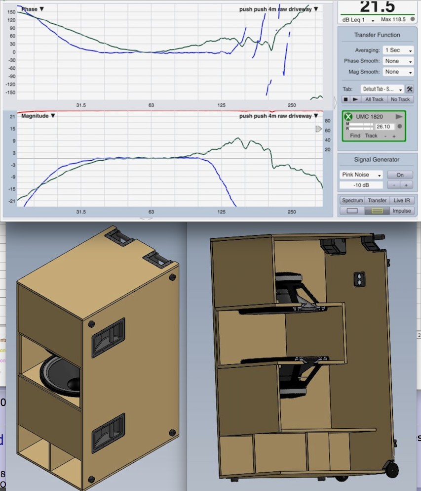

I've had some good luck with push pull speakers.
The pictures and graph above are from a push-pull project I did. One enclosure is a front-loaded horn, one enclosure is a tapped horn. We see the following:
  • The low-pass effect of a front loaded horn is really nuking distortion at high frequencies
  • push-pull seems to be making a noticeable reduction in distortion (look at 2nd versus 3rd in the range of 100 to 400hz)
  • If you look at the entire bandwidth range, the tapped horn has more output at the expense of higher distortion. Note that in the real world we would likely use a larger driver with the TH than with the FLH, which would reduce distortion
Here's a B&C 8NDL51 for comparison's sake. I'd say the push-pull Auras do pretty well, particularly since they're under $80 a pair.

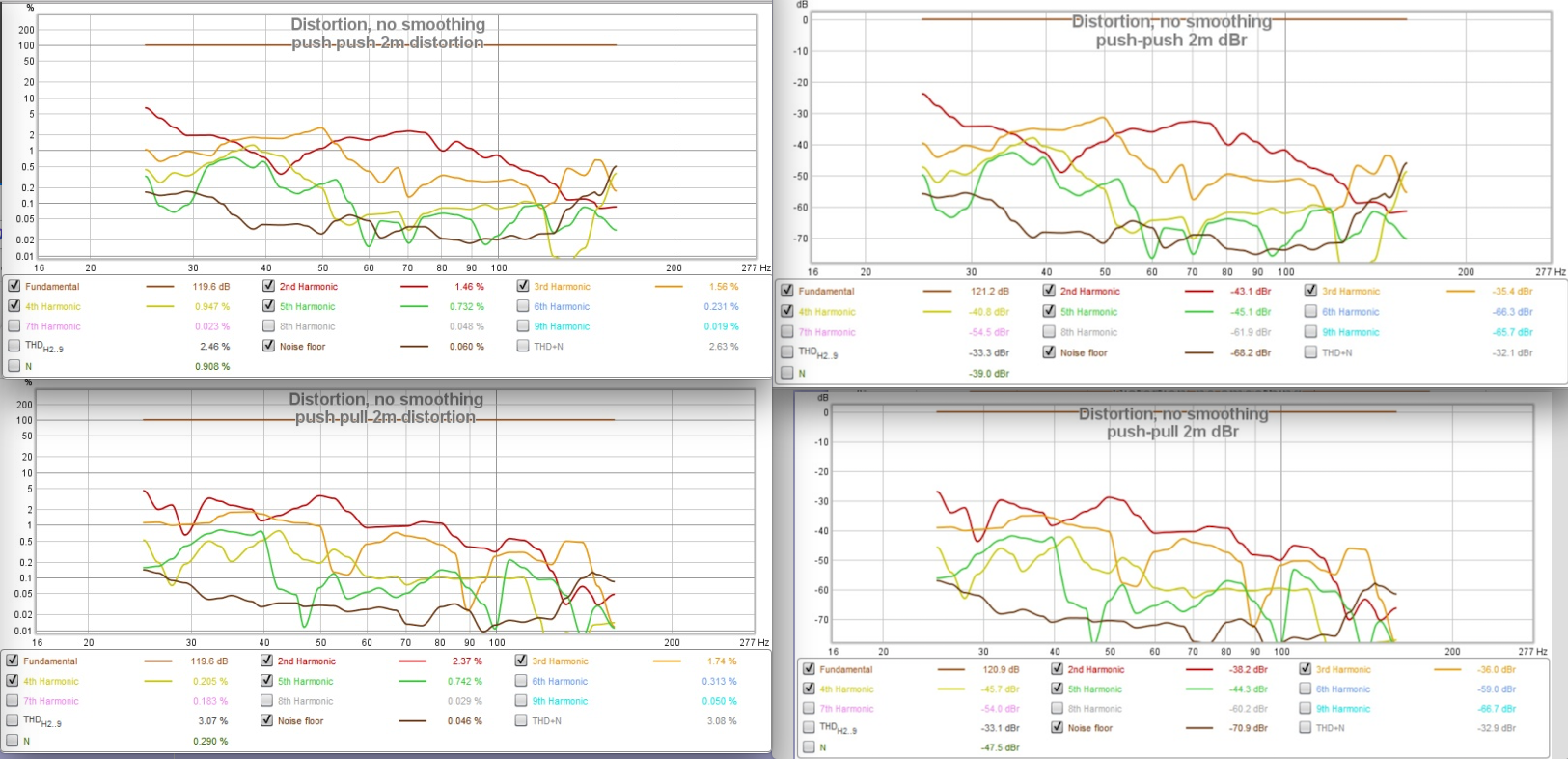

Since comparative push-pull and push-push distortion measurements are hard to locate, thought it would be good to reference Mark100's work here too:
A Thread for those interested in PPSL enclosures
post #758 Mark wrote:
"Since the whole idea of push-pull is 2nd order harmonic distortion reduction,
I decided to test push-pull inverted, vs push-push (clamshell) using the same box.
First plot is push-pull.
Second is push-push.
Both were at 2 meters, so add 6dB to SPL.
I don't see enough of a clear case for push-pull.................??
Plus, the suspension and coil vent noise below 35Hz, was much louder with the pull driver when exposed in the plenum, than when the driver rests in the cabinet as a push driver like its brother.
So, I'm going with push-push.
This gives the vibration reduction (which is dramatic vs a regular dual 18), and allows for a very easy rotation of drivers to get over the horizontal sag stuff.
Last plot is a transfer for the push-push. Dark green is raw, blue is processed.
My SPL Leq method of finding sensitivity gives 101.3 dB 2.83v at 1m, with the processing in place.
THD hit 10% right at 130dB 1m.
Happy camper!!"
His direct comparison using a pair of BMS 18N862 indicates how little distortion changes between push-pull and push-push when using (very) clean high excursion drivers below Xmax.
The 2nd and 3d harmonic distortion levels at around 126dB one meter (120dB 2meters) are under 2% for the push-push (slightly more for push-pull) but rise to 10% when pushed to 130dB, likely reaching Xmax at that level.
