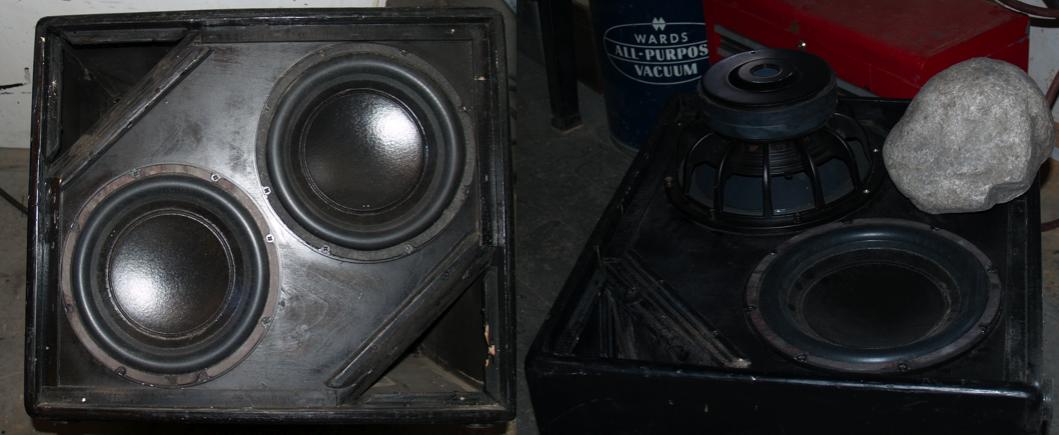

I liked your Keystone tapped horn running dual 12's
You say it puts out 6dB more than a ported sub provides? I figured it would be a little higher but every little bit helps.

The dual Lab 12 Keystone was about 7 dB more sensitive than the dual 12 half the size.I liked your Keystone tapped horn running dual 12's
http://www.diyaudio.com/forums/subwoofers/185588-keystone-sub-using-18-15-12-inch-speakers-2.html
Post #1 has the chart comparing it, post #12 goes over the distortion, which is about the same as the ported cabinet on average.
It would be fairly easy to make a "donut" adapter that would allow the dual 12 Keystone to be run in PP, if it didn't work as well as normal, it could be switched back.
I wish I would have done that experiment, but the BC18115-4 sounded better than the Lab 12s, and could take way more power and still sound clean, so I was not inclined to pursue it too much.

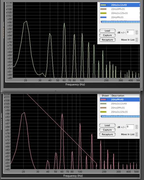

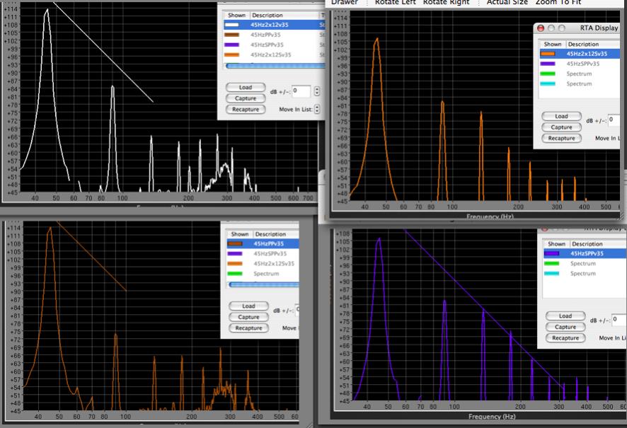

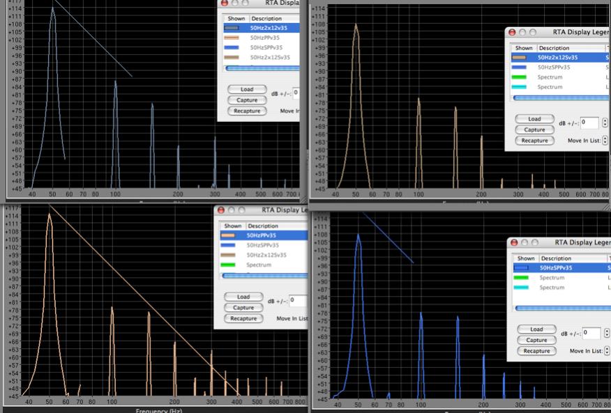

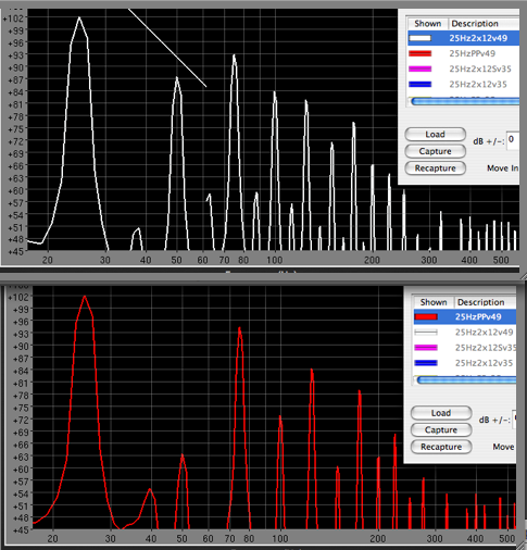

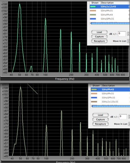

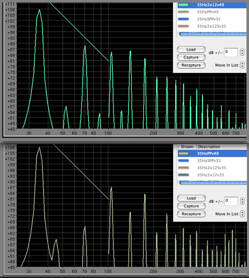

I've had some good luck with push pull speakers.

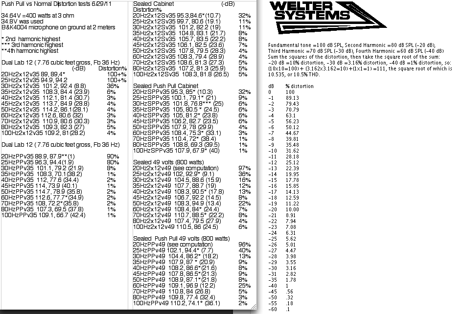

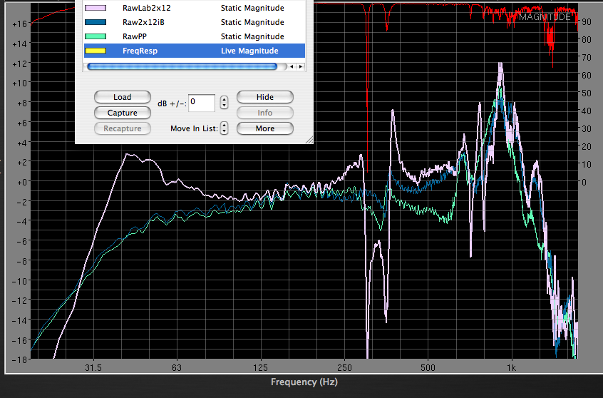

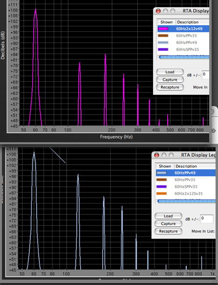

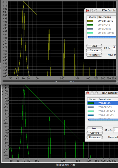

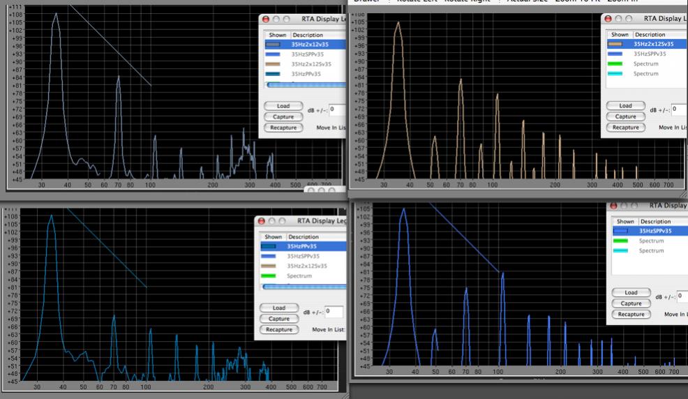

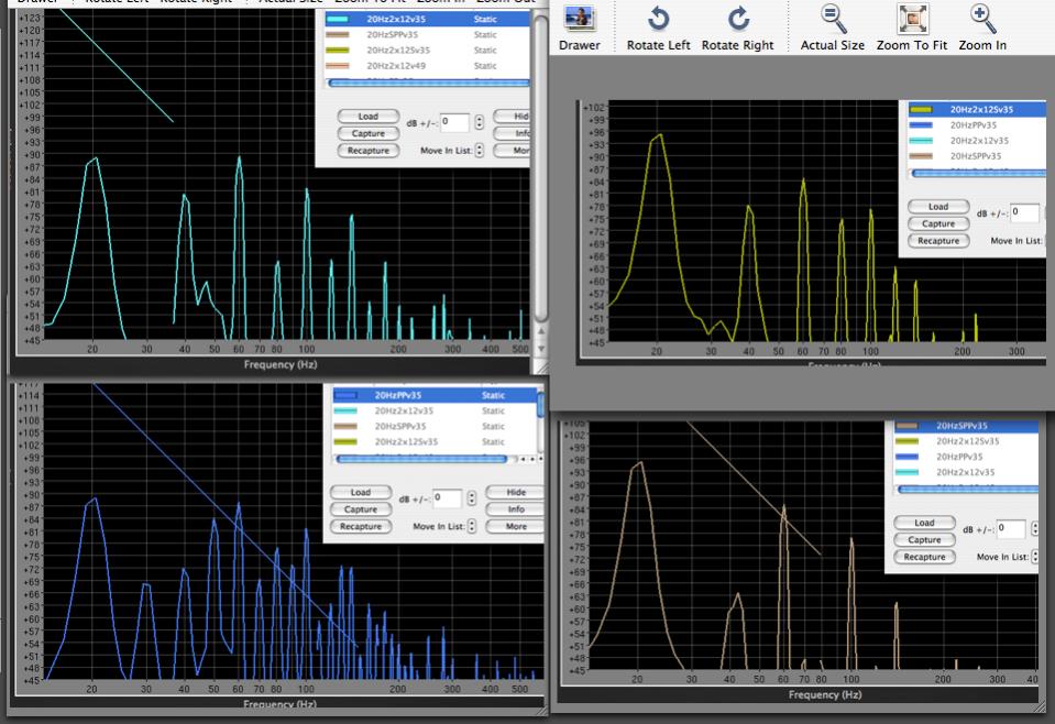

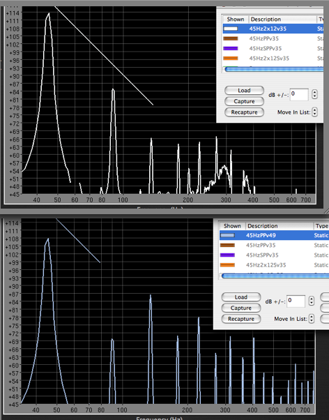

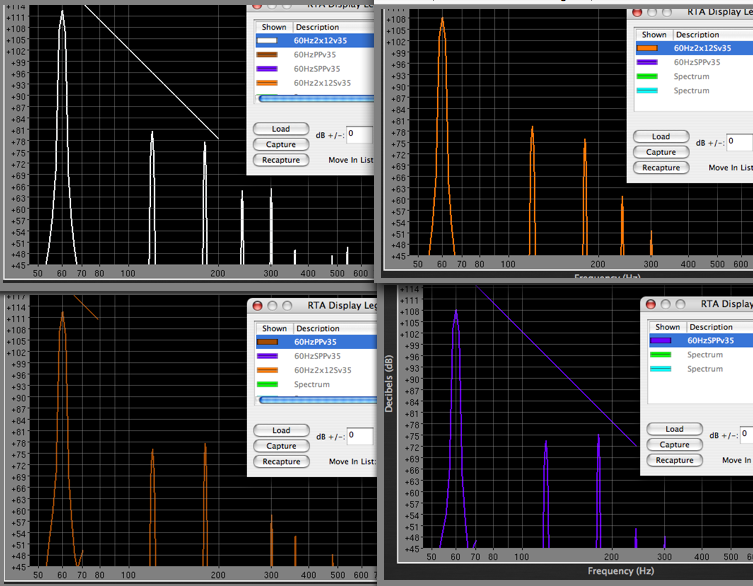

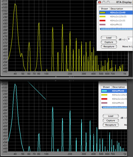

The pictures and graph above are from a push-pull project I did. One enclosure is a front-loaded horn, one enclosure is a tapped horn. We see the following:
Here's a B&C 8NDL51 for comparison's sake. I'd say the push-pull Auras do pretty well, particularly since they're under $80 a pair.
- The low-pass effect of a front loaded horn is really nuking distortion at high frequencies
- push-pull seems to be making a noticeable reduction in distortion (look at 2nd versus 3rd in the range of 100 to 400hz)
- If you look at the entire bandwidth range, the tapped horn has more output at the expense of higher distortion. Note that in the real world we would likely use a larger driver with the TH than with the FLH, which would reduce distortion

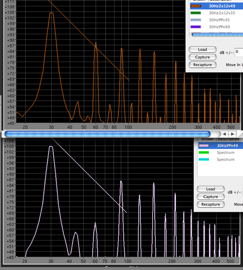

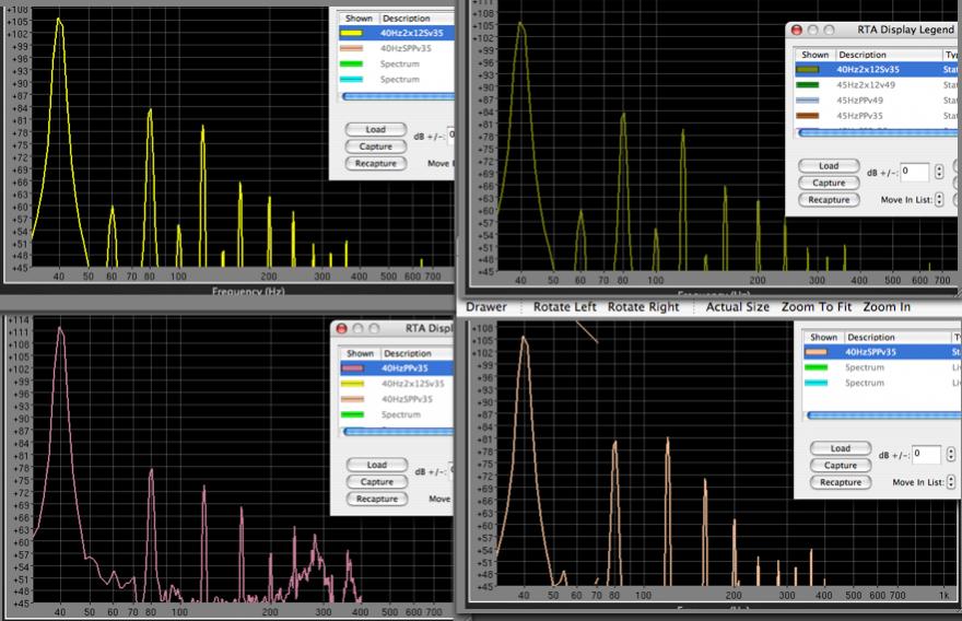

Yes, even order harmonic distortion is largely eliminated, leaving the more objectionable odd order left when driven hard.Random thought. I always considered Isobaric to be a cheat for a too small motor, but would you get the same advantage in distortion with cone-to-cone facing Isobaric?
I used a pair of $5 Sammi 10" in a cone-to-cone facing isobaric tqwp:
http://www.diyaudio.com/forums/subwoofers/206955-10-plus-wood-18hz-isot-tqwp-sub.html
Art Welter
Seems like a good match for an acoustic bandpass alignment - the isobaric loading will take care of the even order frequencies and the acoustic bandpass could reduce the audibility of the odd-order ones above the system's passband.

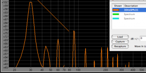

Since comparative push-pull and push-push distortion measurements are hard to locate, thought it would be good to reference Mark100's work here too:
A Thread for those interested in PPSL enclosures
post #758 Mark wrote:
"Since the whole idea of push-pull is 2nd order harmonic distortion reduction,
I decided to test push-pull inverted, vs push-push (clamshell) using the same box.
First plot is push-pull.
Second is push-push.
Both were at 2 meters, so add 6dB to SPL.
I don't see enough of a clear case for push-pull.................??
Plus, the suspension and coil vent noise below 35Hz, was much louder with the pull driver when exposed in the plenum, than when the driver rests in the cabinet as a push driver like its brother.
So, I'm going with push-push.
This gives the vibration reduction (which is dramatic vs a regular dual 18), and allows for a very easy rotation of drivers to get over the horizontal sag stuff.
Last plot is a transfer for the push-push. Dark green is raw, blue is processed.
My SPL Leq method of finding sensitivity gives 101.3 dB 2.83v at 1m, with the processing in place.
THD hit 10% right at 130dB 1m.
Happy camper!!"
His direct comparison using a pair of BMS 18N862 indicates how little distortion changes between push-pull and push-push when using (very) clean high excursion drivers below Xmax.
The 2nd and 3d harmonic distortion levels at around 126dB one meter (120dB 2meters) are under 2% for the push-push (slightly more for push-pull) but rise to 10% when pushed to 130dB, likely reaching Xmax at that level.
