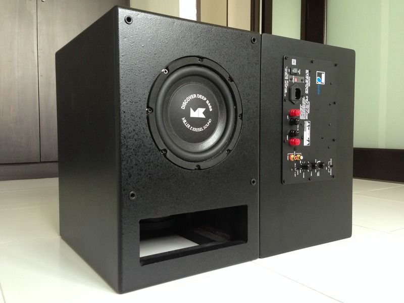

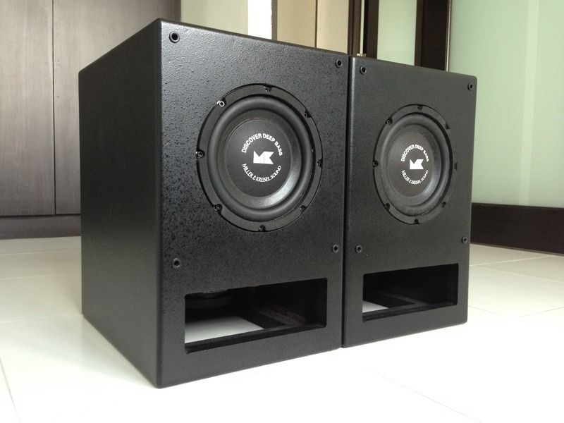

Junior,
Nice work. Are those original drivers?
Matt
I brought it second hand.
According to the seller is original as he brought it from PE.
Now I am getting the mid bass that I had been missing all this while 🙂
