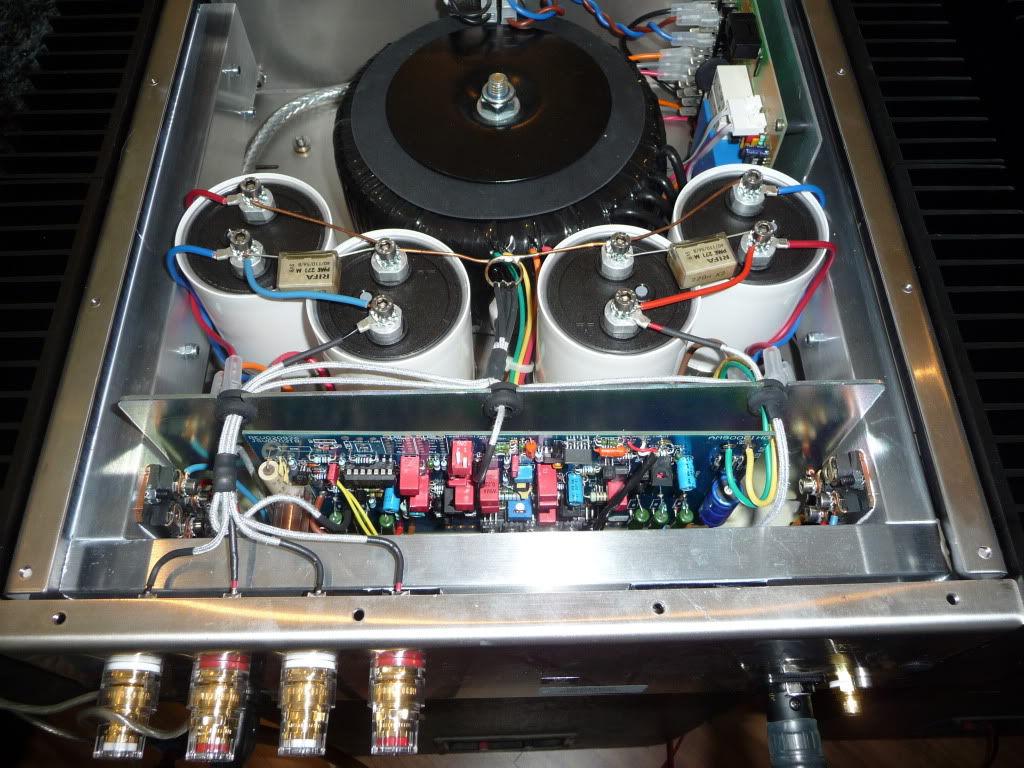

"Push-Pull" for push und "Push-Pull" for pull (like Gamnut) - whats the right name?
Last time I contact to seller. He told me that a schematic which he gave me was wrong value over 90% all of 200 pcs :-( and I've found this error,too
Such as 1K to 10k, 220k to 470k he doesn't want anyone copy him again. So I'm sorry if my schematic uncorrect, don't use its value to make any diy !
I have 2 pcs of board for spare parts but I can't send them to USA or ASIA
I am still looking to the right term of this topology, because I want to know the associated patents.
About the term "Quasi-Complementary" I don't find the appropriate informations.

Hi, tiefbassuebertr
Still try to find Gamut topology ?
As I told on my post so long time this's active load quasi complementary.
Many many quasi used only 1 transistor to bias each power mosfet but Gamut used 2 pcs of active load seem like power mosfet been to Imagin Speaker !
Look at my schematic (don't care its parts value because it uncorrect) you will see each phase are symetry and easy to understand.
