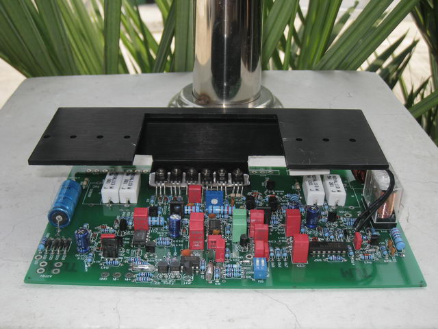

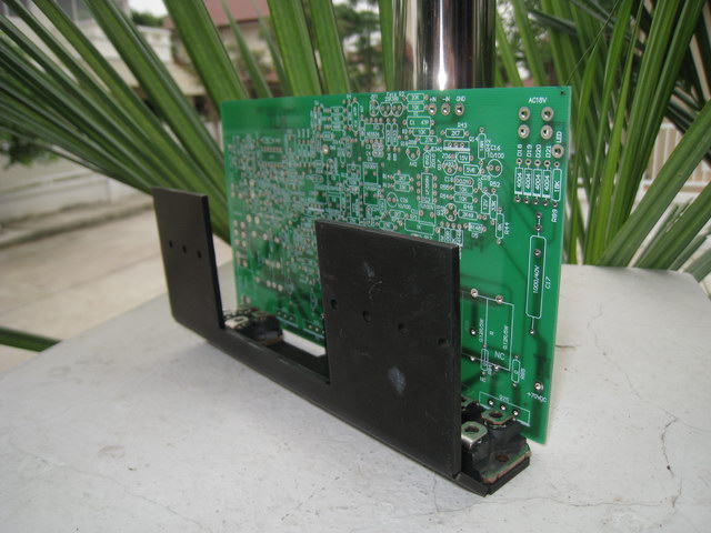

Its PCB !
I got it ! Hooreyyyyy !
Thanks for ebay that recorded very old item of this seller.
I bought them only 50USD.
Full screened label and operating test point but it used very expensive power mosfet 4Pcs (94USD a piece), how do I find APT10025JVR from Microsemi.

Do you know the influence of various OP-AMPs?This's my clony of Gamut
I used only typical TI opamp and 1% royal resistor.
Hooreyyyy asap to hear it !
Which value for the idle current through the MOSFET's you have select?
AD797, 125mA for Mosfet
I'll try to change NE5534 to AD797.
I used idle current only 125mA.

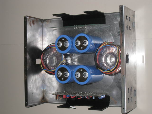

Happy !
Completed project of GAMUT D200I !
Changed NE5534 to AD797 and removed all feedback capacitor which control close loop gain and used only 4.7pF for global feedback.
Now I used APT100M50J 100A/500V power mosfet module TO-227 and set to 400mA for idle current, +/-70V supply rails.
Anadigit
Anadigit

Congratulations, that's a very nice looking amp, I'd be proud to have built that.
Thanks a lot
Now I'm very happy with its sound, so smooth with a little punchy for rock.
I have a spare parts for 2 channel and decide to build it again with mono block chassis but I may use a waste of time to build their chassis surely :-(
I have many DIY amplifier such as Aleph30, Aleph4, Aleph-J, F5, Accuphase E210, KRELL KSA-100, Cello ENCORE-50, MBL-8006 and now Gamut D200I is my fevorite suit over other DIY more than 2-3 times.
Anadigit
Are you using the APT100M50J , two per channel?
Sam
Yes, only 1Pc each phase.
