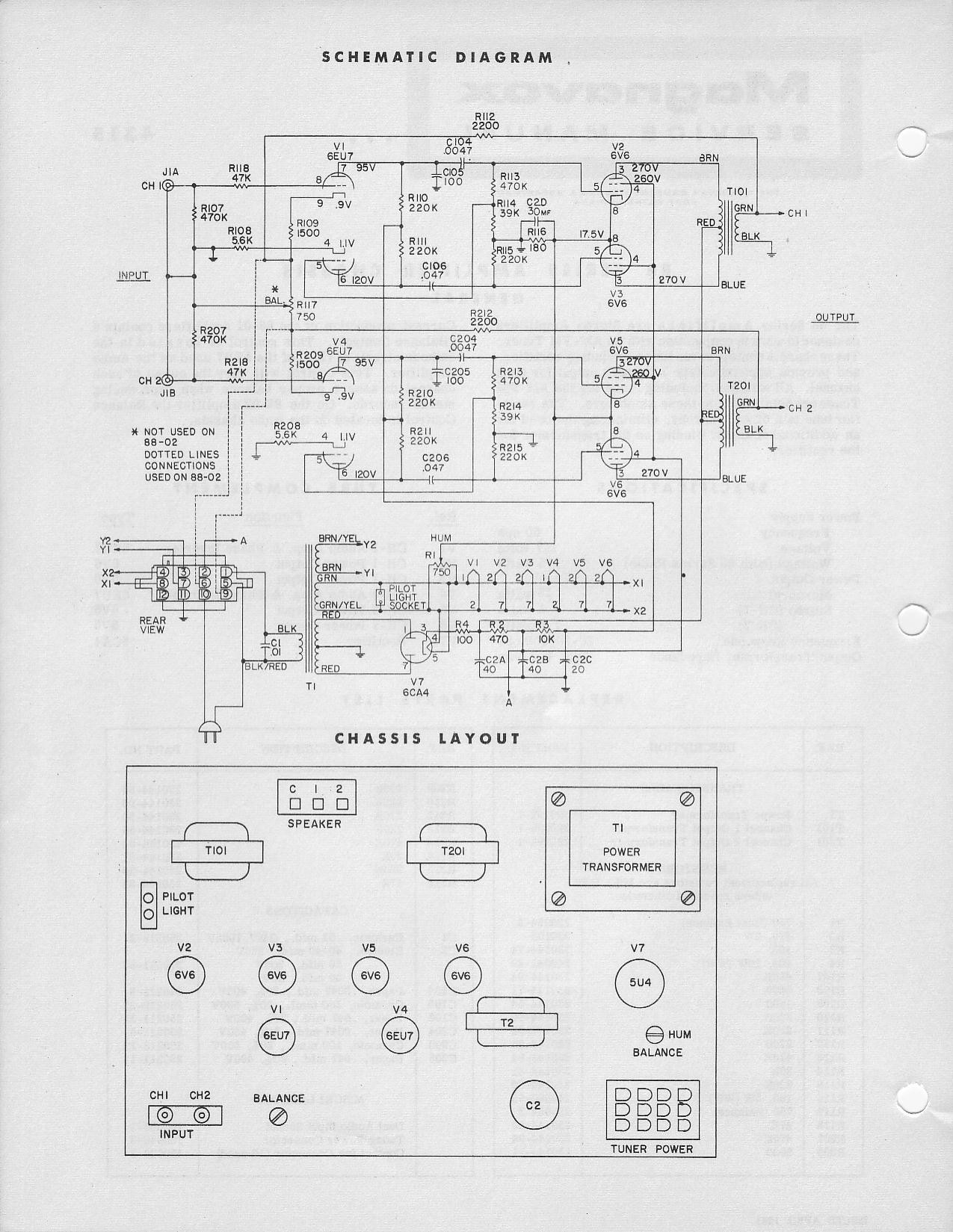

The way I described is the way manufacturers have done it for decades now.
Go look at some vintage schematics of amps, then you'll see.

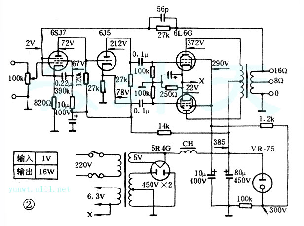

I'm talking about putting the screen B+ after the RESISTOR - THIRD cap, which should be increased to 47uf.

That's for regulation (then you should invert the resistor/Ne-tube place).Here it is to reduce the screen voltage (6L6 don't like high screen voltage) without loosing the low supply impedance.

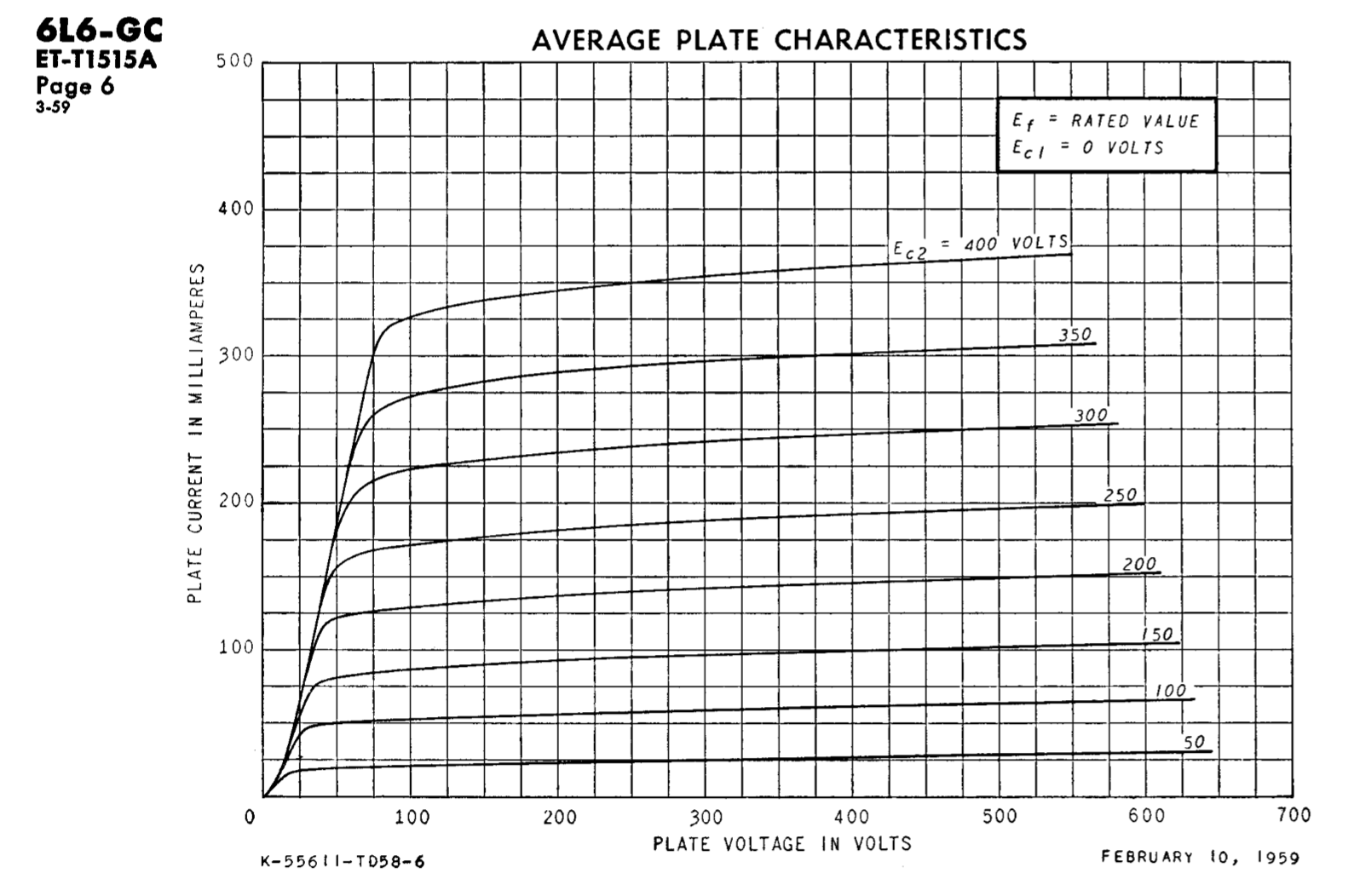

And most datasheets show plate curves at different screen voltages.
Here is one for the 6L6GC.
Triode mode = voltage controlled resistance.
Pentode mode = voltage controlled current source.

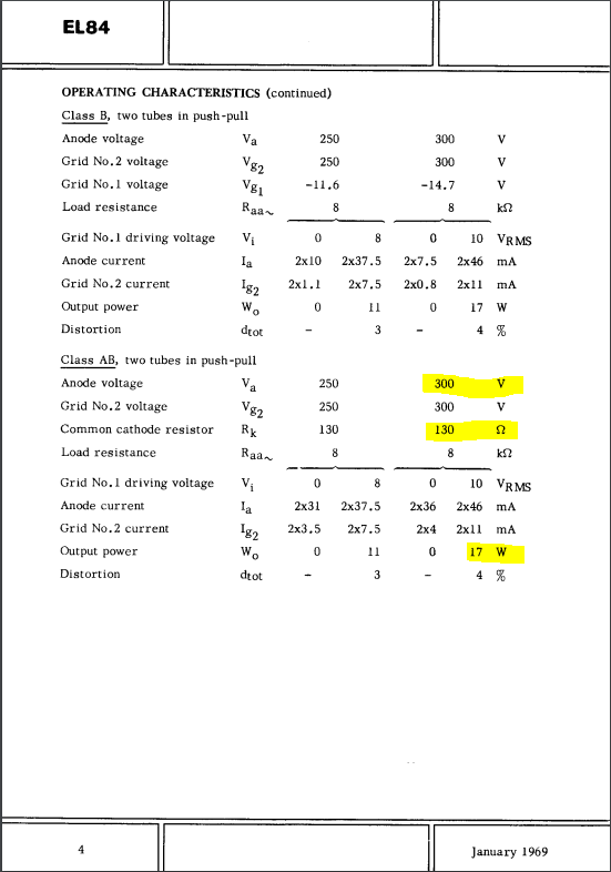

Those statistics were taken directly from the RCA Receiving Tubes master manual - so you're saying that the RCA book is not making sense?
You may have a manual handy, look up the 6BQ5 (EL84) page.

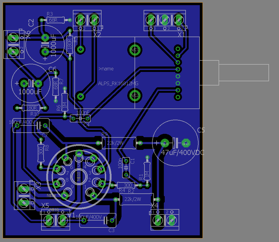

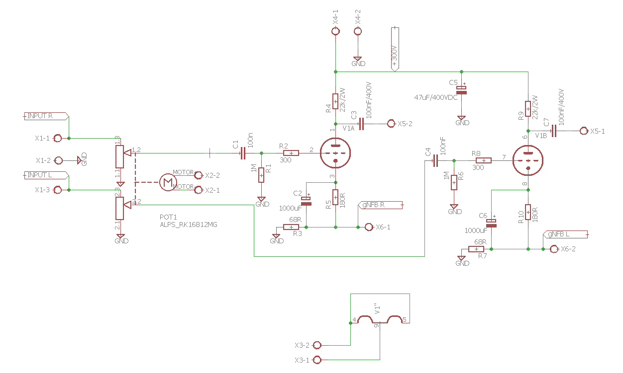

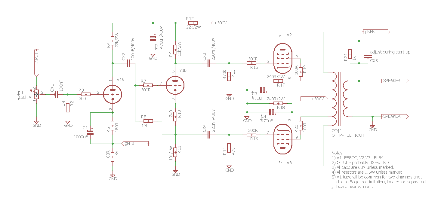

Guys, I don't want to disrupt your conversation, but I did a next small step for me (but probably not a big leap for a mankind 😀 ) and I revised diagram and created a PCB for the preamp.
As my skill in eagle is very basic (but I'm keen to learn!), it would be great if some of you could take a more experienced look at what I created.

If that pre is to be used with that power-amp no need for two volume controls and you can skip some capacitors.
The cathode resistor(s) for the EL84 is 270ohm each (better) or 150ohm for the two.
R13 is 470k not 470 😱

It's not the book but your interpretation is wrong 🙁Those statistics were taken directly from the RCA Receiving Tubes master manual - so you're saying that the RCA book is not making sense ?

Sorry guys, I did upload a wrong screenshot. May I asked the moderator to change my previous post in order to avoid the mess? A correct screenshot is attached here.
Looks good to me, but C2 only needs to be 47u or so... 470u is overkill 🙂

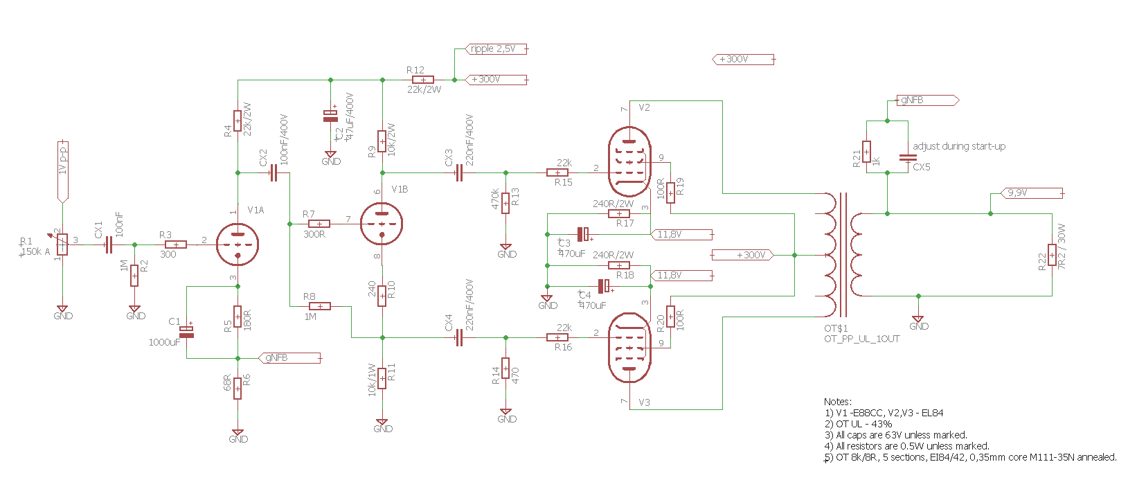

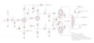

Hi folks,
as the autumn started, I had a chance to start-up the amp. Everything worked well, except output power, that seems to be a bit too small 😕 .
I followed the value from the Philips datasheet, Vb=Vg2=300V, Rk 230R (per tube). Measurements showed that cathode voltage is about 11,8V, and the signal is about 14V. Ripples at HV are about 2V. Total capacity in HV power supply seems to be a bit low - around 160uF.
I marked the values at the drawing. Does anyone have an idea of how I can increase output power? I don't really want to go higher with anode voltage, just because my labo autotransformer is already at the of the scale 😀
I know, that in this case, more doesn't mean better (higher distortion etc. 😱 ) but I'm just curious to reach the limit value. In the final solution, I switch the system to UL, what for sure decrease maximum power.
