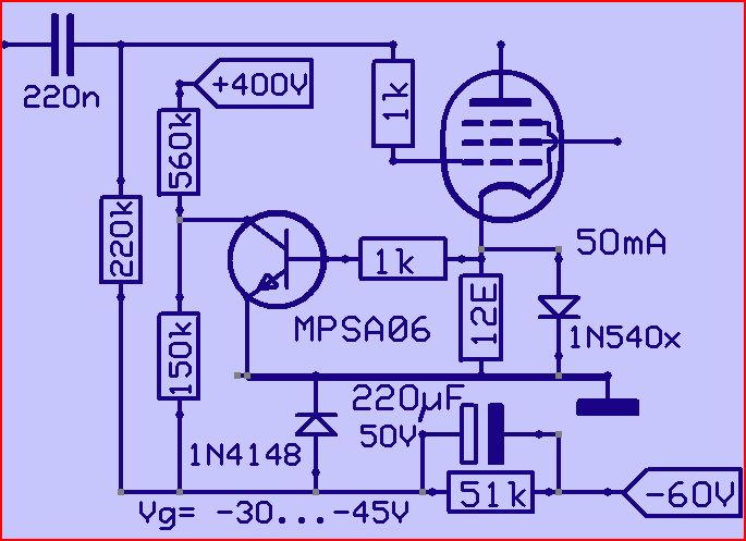

To keep it simple,perhaps like this.Just a suggestion,didn't try it.
Other tube in PP same circuit.Since the Vbe of the transistor is the reference,best glue the two together for the same temperature on both sides.For another baiscurrent change the cathodeR for 0.6V at the desired current.
Mona

The Ketje circuit is simple, I like that, but I don't think it can work in anything but strict Class A. Plus no autobalancing. But, if Class A, and perhaps augmented a bit with an OP AMP driving the MPS06 (for precision, stability and easy adjustability) instead of letting the Vbe be the reference then it will be very nice. If Class AB, the basic idea can still be made to work provided some sort of clamping is utilized so only the current inside the Class A band is perceived. One tube can be bias controlled and the other can be differentially measured with a separate servo circuit. Between the first and second servoes, both absolute bias point and relative balance can be maintained.
Or, if you are good with programming, use greenm01's idea. Depending on level of sophistication of the code, the sampling (making sure only the current immediately above and below Iq is processed), integration, absolute measurement and balancing can all be done. I would suggest one which incorporated ADC channels. Not much resolution is needed, 8 bits ought to be enough. Micro Chips has several, as does Analog. I use both in Gas/Oil drilling guidance systems.
But it will be relatively complex and likely require a good measure of R&D. I would prefer the analog route instead.
Whichever approach is used, it will be wise to limit the authority of the servo, to help prevent runaway situations. And either way, the integration interval must be quite large so only DC error correctons result.
Rene
It is better to get rid of cathode resistors in high-quality amplifiers. Especially if the circuit uses cathode feedbacks with the winding of the transformer. Therefore, it is more promising to receive a feedback signal for bias servo from the anode circuit. A very good solution with a galvanic isolation on an optocoupler is used in amplifiers Audio Research VT-130.
