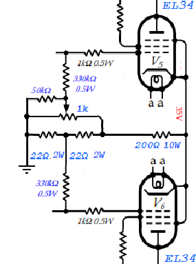

Heathkit W5M:
The 300 Ohm pot Does adjust DC current balance.
If there is not enough range of adjustment, it means your output tubes are too far from being anywhere near to being matched.
About $5 additional during your purchase gets your pair of tubes matched . . .
a very smart investment.
Do not replace only one tube of a push pull pair.
Good hobbies are not cheap, but they can be economical.
Ketje,
On the W5M, if the DC current balance pot wiper lifts, there is no DC path to ground.
That is a problem.
The output tubes will be at zero bias, and the cathodes will "head toward" the plates.
The cathode voltages will rise, and the 50V electrolytic bypass caps will be destroyed.
That is why I recommended two 1k resistors to ground, with the other ends connecting to the ends of the 300 Ohm pot.
Any reasonably matched pair of KT66 tubes will still be able to be DC current balanced.
I made a mistake, I overlooked one important point:
Adding two 1k resistors in the path to ground will raise the quiescent current of the KT66 tubes.
The fix for that is to change the series common 330 Ohm self bias resistor to 365 Ohms
(or just add 35 Ohms in series with the 330 Ohm resistor that is already there).
Changing one thing often requires 3 more changes to make it work right.
Pretty much the case here.
There is another way to balance the autobias on amps like W5M.
And you can use a simple trimmer to do the job.

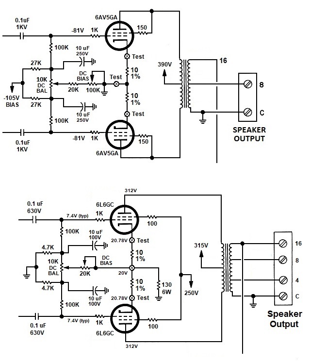

Here are two methods I've used to provide bias and balance adjustment for push pull output stages. The first is an AB1 stage, the second is a class A stage. Adjust component values to suit the range adjustment you need.
These methods offer fail safe operation in the event of wiper(s) disconnecting from track.
Thanks, your first example is exactly what I had in mind and it's good to see more application of it. On a separate topic, would that first schema be a "mixed" or "adjustable cathode" bias? I've heard of a few cases that's used, I don't think this amp will be the spot I try it out but would be interested to read more if you've got a resource (or anecdotes) on it.
The first one (top in the previous diagram) is a fully fixed bias topology, but it's adjustable.
The second one (bottom in the previous diagram) is a cathode bias topology overall, but it siphons voltage from the cathode and applies it to the grid to allow for some adjustability. The idea is not new, in fact I adapted it to work with my amp after studying the HK A500 circuit.
Thanks for the clarification. I was wondering if the bias test resistors would have any appreciable affect on the bias point, which is why i asked. The voltages I'd expect are in the range of tenths given those r-values but without asking I didn't feel comfortable just hand-waving it away.
Right, 10R at ~30 mA is 0.3V, so for all intents and purposes is negligible. The only purpose for those 10R resistors is for cathode current measurement given the adjustability of the circuit.
The 10R resistors do affect an AB1 stage ever so slightly--at full power a minuscule amount of power is lost, and distortion is ever so incrementally higher--but again negligible in my opinion, and well worth the trade off of having visibility into the DC conditions of the stage (bias and balance).
kward,
I believe your second diagram is not strictly class A.
The 130 Ohm resistor is not a true current source.
So you can start with a total quiescent current, and then you can draw more than the quiescent current at the time when signal dictates that one (or the other) tube cuts off, and the remaining tube draws more than the original total quiescent current.
During the time when the voltage across 130 Ohms rises above the quiescent voltage, the 10uF bias bypass caps keep the bias voltage at the 100k grid resistors at a constant voltage.
The signal is probably still clean and useful, but I believe it is in Class AB at that time.
If you have designed the driver to limit its voltage swing, then the amp is still Class A.
But a larger driver voltage swing puts that output stage into Class AB.
Right?
Now if the 130 Ohms was replaced with a true current sink, the current could never be higher than the quiescent value.
That would mean the output stage was always in Class A, right up to the time that the amplifier was very badly distorted (clipping).
The idea is that for all reasonably linear power levels, the amp with the constant current sink is always in Class A.
6A3,
The stage is biased so both tubes conduct a full 360 degrees up through g1 = 0V. So perhaps I should have said class A1. Certainly the conditions you describe would occur in A2.
Now in reality there is a small amount of fluctuation in current through the cathode resistor at near class A1 max power because of small differences in tube matching. A current source or just a bypass cap would address that, though. I ended up adding a cathode bypass cap in the final design for that reason.

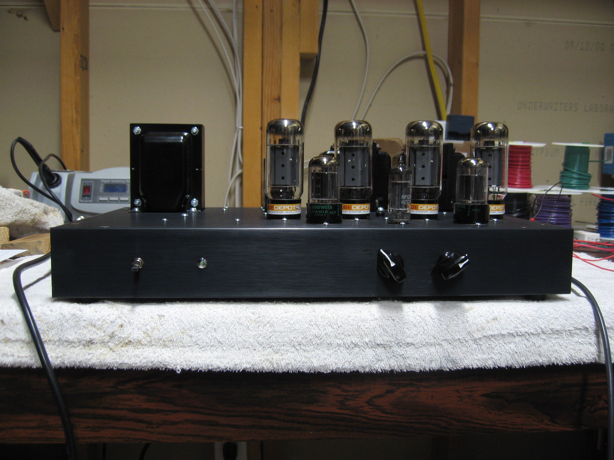

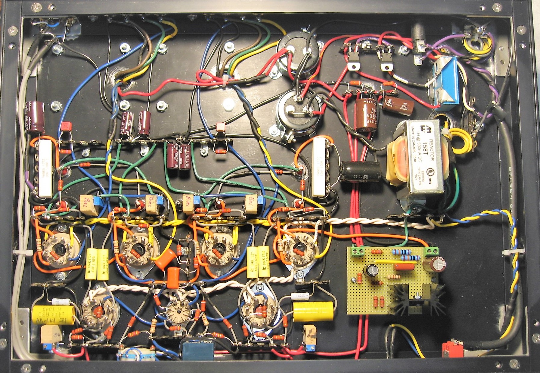

What was the plate to plate primary impedance?
6A3,
The output transformers used on that particular class A amp were pulled from a derelict Fisher TA-800. They measured 6.2k, end to end.
Max power output was 12 watts per channel, both channels driven.
Frequency response was to 35 KHz at -1 dB (with 14 dB global feedback).
Power bandwidth, both channels driven was 30 Hz to 35 KHz +0/-1 dB
THD at 12 watts output, both channels driven was 30Hz: 0.72%, 1KHz: 0.16%, 20 KHz: 0.7%
Excellent performance! But does the amp sound better than the same topology and tube compliment in an AB1 design? Not in my opinion. It was an experiment in designing/buiding a class A PP amp.
Amp shown below (7581A output tubes shown)
