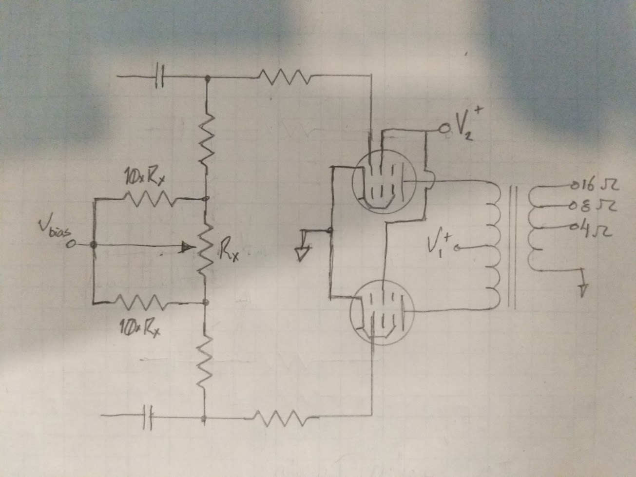

Working on a schema for a class AB push-pull. I'm leaning towards a fixed-bias design (not sold but I've done more than a few cathode bias so, whynot) and I'm trying to work-out what all I want to do for the bias circuit. I'm going the bias/balance route; one pot for overall bias voltage level, plus two more pots (one per channel) to balance i-q for each pair of output tubes.
Almost every schema i've seen just has a pot with the wiper tied to bias voltage and each tail tied to the grid resistors. I can't say I'm entirely comfortable with that, in the even that the wiper lifts. I know "it works" since...well...its been used in various spots but I'm trying to make sure i make this as "robust as reasonable" (i know...a box of worms but i digress).
I've search around (here an other places) a bit and haven't found anything real explicit. I'm thinking of taking a similar approach to the bias supply, using a "strap" resistor from the wiper to each tail so that in the event the wiper lifts on the pot, bias is pulled to whatever the overall level is and not just left floating as 0V. Each of these strap resistors would be ~10x the pot value.
See the attached; Assuming a 1k pot, would give me about 800ohms adjustment which i'd think would be enough. Is this viable? Am I overthinking this? thoughts?

jlangholzj,
You are right, having the wiper lift open can be a problem.
On the W5M schematic, the fix is to use a pair of 1k resistors.
Connect a 1k from ground to one end of the pot, and the other 1k from ground to the other end of the pot.
There will still be enough current balance range for all tubes, except for a bad tube(s) that you do not want to use anyway.

The problem with your circuit is that there is no ground connection so you are just changing the series resistance but there is no DC current flow. You are changing the driver AC loading but no DC effect.
Which is what I had suspected when first replying to audiowize. Looking at some past schematics I can see it now. My original schema had a stroke of something but most certainly wasn't genius.

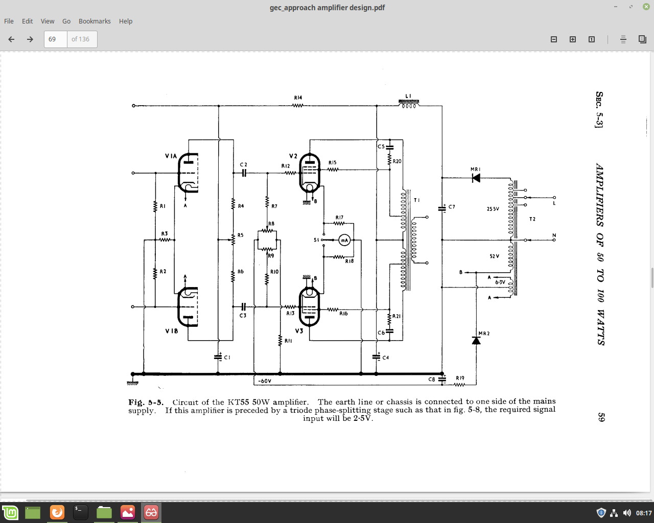

I've used a dual 10k ganged pot as in this circuit attached, this is from the GEC - An Approach to AF Amplifier Design, it's available on the net as a free PDF and has lots of good ideas in it.
Back to the schematic, R8/9 are 10k, R7/10 are 100k and R11 is 10k. R11 is stop bias going to 0v. If you make R8/9 a ganged pot wired so as one pot increases bias, the other decreases bias. To set bias on the amp put your meter on DC V, one lead to output valve V2 g1, the other to OP valve V3. As you adjust the pot the reading will go + 0.1V to -0.1v say, you want to adjust it to 0v if possible, though that's not easy with a one turn pot. To prevent a non bias situation, I used 1m fixed R's from wiper to each end of pot.
Heathkit in their amp use a 300r pot,seems a tad small. The problem with DC bias where no current (or very little) is flowing is that a low value pot gives very little adjustment. I know the pot on the W5M isn't adjusting DC balance but the same applies.
Lastly remember any pot or resistor in the bias circuit may add to the grid leak resistor, which may exceed Rg1 max, you have to be careful what values you use to keep this low.

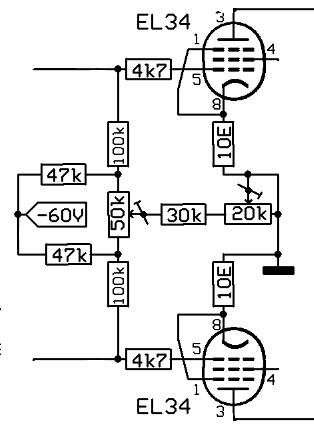

Think reverse.Not regulating the negative side but the ground solves that problem.jlangholzj,You are right, having the wiper lift open can be a problem.

Thanks for the schema, that's the exact implementation I was thinking about. Also FYI for anyone coming across this again, this is the technique I've used when replacing any "tapped" pot when i was talking about using something like virtual CT for heater wires. I hadn't even thought of that when looking at old man leo's schematics.
That's about safe measurement, not a save regulator circuit at all

Measuring the balance is part of it but a safe circuit too
