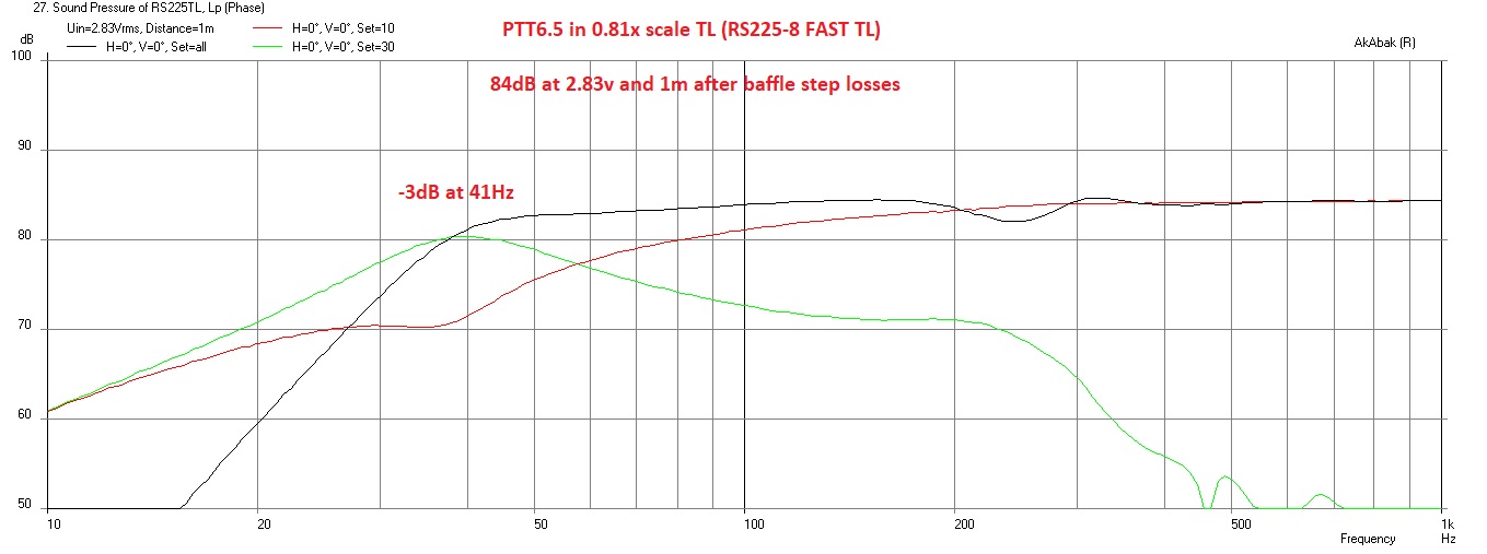

Looking forward to these drivers. Here is a simple scaling of my current 8in TL for an RS225-8 down by factor of 6.5/8 or 0.81x. This was a lazy test in Akabak to see if the Purify could even work in a TL. It’s quite smooth and flat and I wonder if people consider 41Hz F3 not low enough given all the super compact designs with very long vents.

Great to see some poeple that use transmission lines! What is your box volume; length, offset and tapper ratio?
This purifi looks like a great candidate for a high quality 2-way floorstander TL.
I simply scaled this design by 0.81x (6.5/8.0). But 80% is about right. Internal TL width in simulation was 7in, so add wall thickness for two sides. If 12mm ply then total width is 8in.
Full scale plans used 3/4in BB ply, so maybe use 12mm BB plywood all around except baffle keep at 3/4in for stiffness. 80% of 40in is about 1.3m tall.

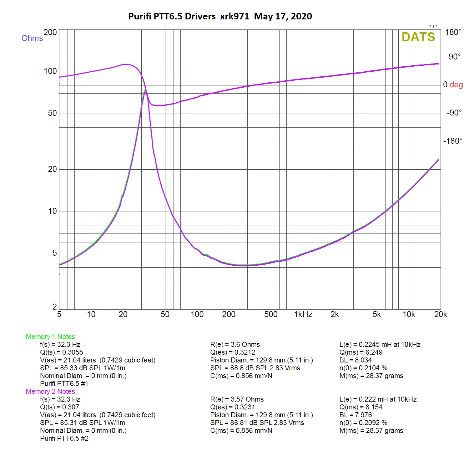

I just put my two drivers to the DATS TS parameters measurement. I used the added mass technique with 95.2g of plastic modeling clay over Blue tape to protect the cone from the oil in the clay. These are the two closest matched drivers I have ever seen - a testament to the quality control of the manufacturing. The lines basically are on top of one another and the TS parameters are very consistent.
The measured Qts is very close to the factory value, fs is very close, and sensitivity of 88.8dB at 2.83v are excellent. These are the places where values are sometimes exaggerated by manufacturers. But not this time - well done Purifi!
Driver #1:
f(s) = 32.3 Hz
Q(ts) = 0.3055
V(as) = 21.04 liters (0.7429 cubic feet)
SPL = 85.33 dB SPL 1W/1m
R(e) = 3.6 Ohms
Q(es) = 0.3212
Piston Diam. = 129.8 mm (5.11 in.)
SPL = 88.8 dB SPL 2.83 Vrms
C(ms) = 0.856 mm/N
L(e) = 0.2245 mH at 10kHz
Q(ms) = 6.249
BL = 8.034
n(0) = 0.2104 %
M(ms) = 28.37 grams
Driver #2:
f(s) = 32.3 Hz
Q(ts) = 0.307
SPL = 85.31 dB SPL 1W/1m
R(e) = 3.57 Ohms
Q(es) = 0.3231
SPL = 88.81 dB SPL 2.83 Vrms
C(ms) = 0.856 mm/N
L(e) = 0.222 mH at 10kHz
Q(ms) = 6.154
BL = 7.976
n(0) = 0.2092 %
M(ms) = 28.37 grams
DATS 2.1.1

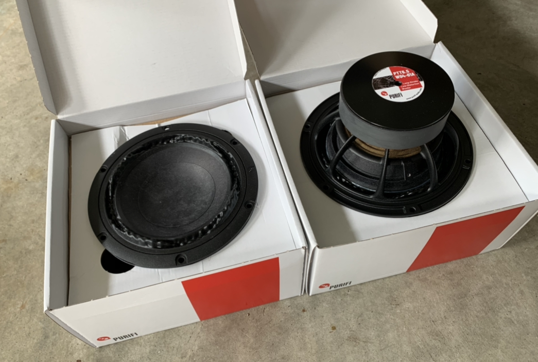

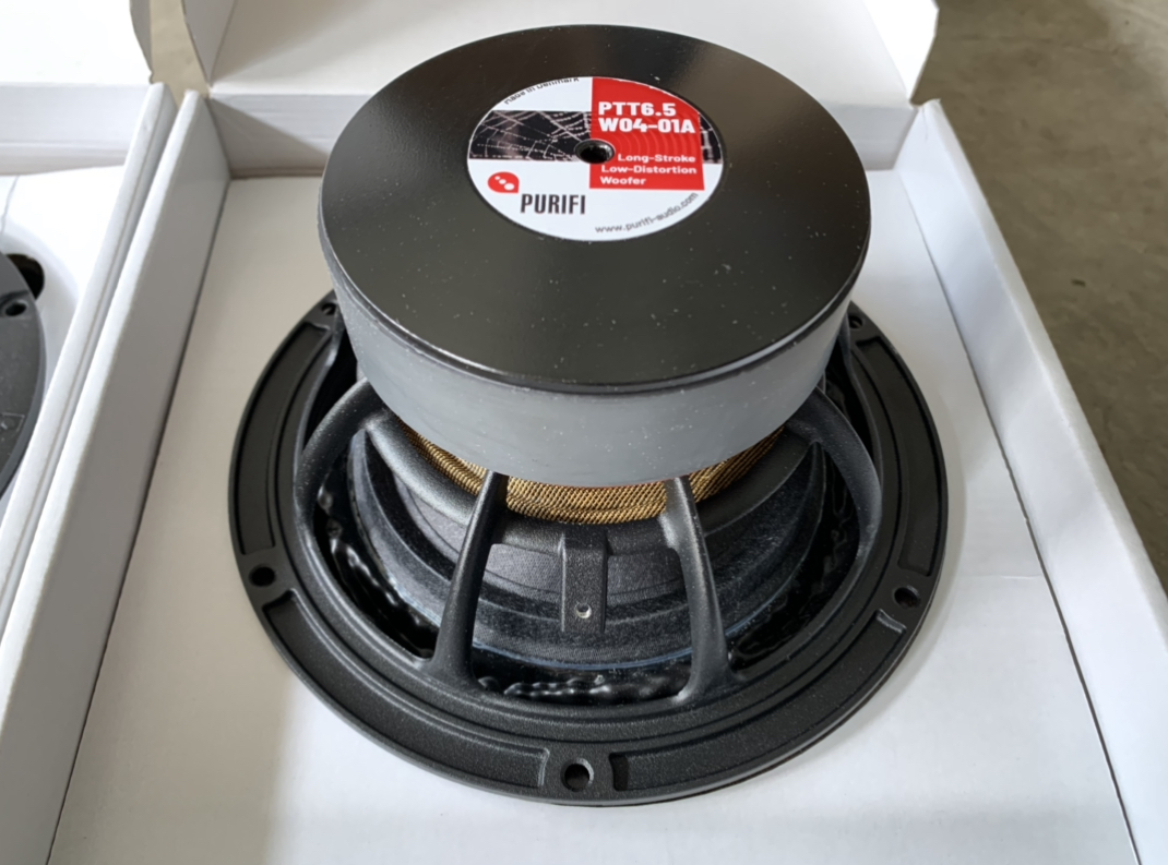

Received my woofers in perfect condition. Thank you, so much, Norman!

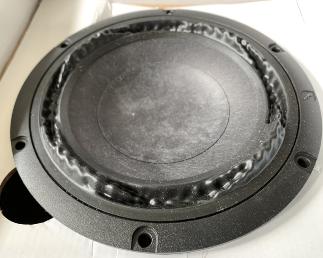

They look much better than I expected. While checking them out I noticed something interesting. They have two "cones". There is a second cone in the back that has an odd shape and elliptical holes near the spider. I wonder what this does for the design.
I think that second cone is bracing for the main cone part that contacts the surround. It keeps it light but stiff. The holes are for ventilation I presume.

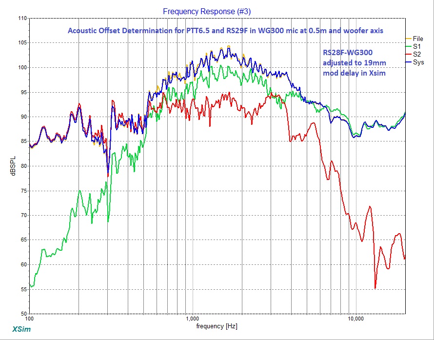

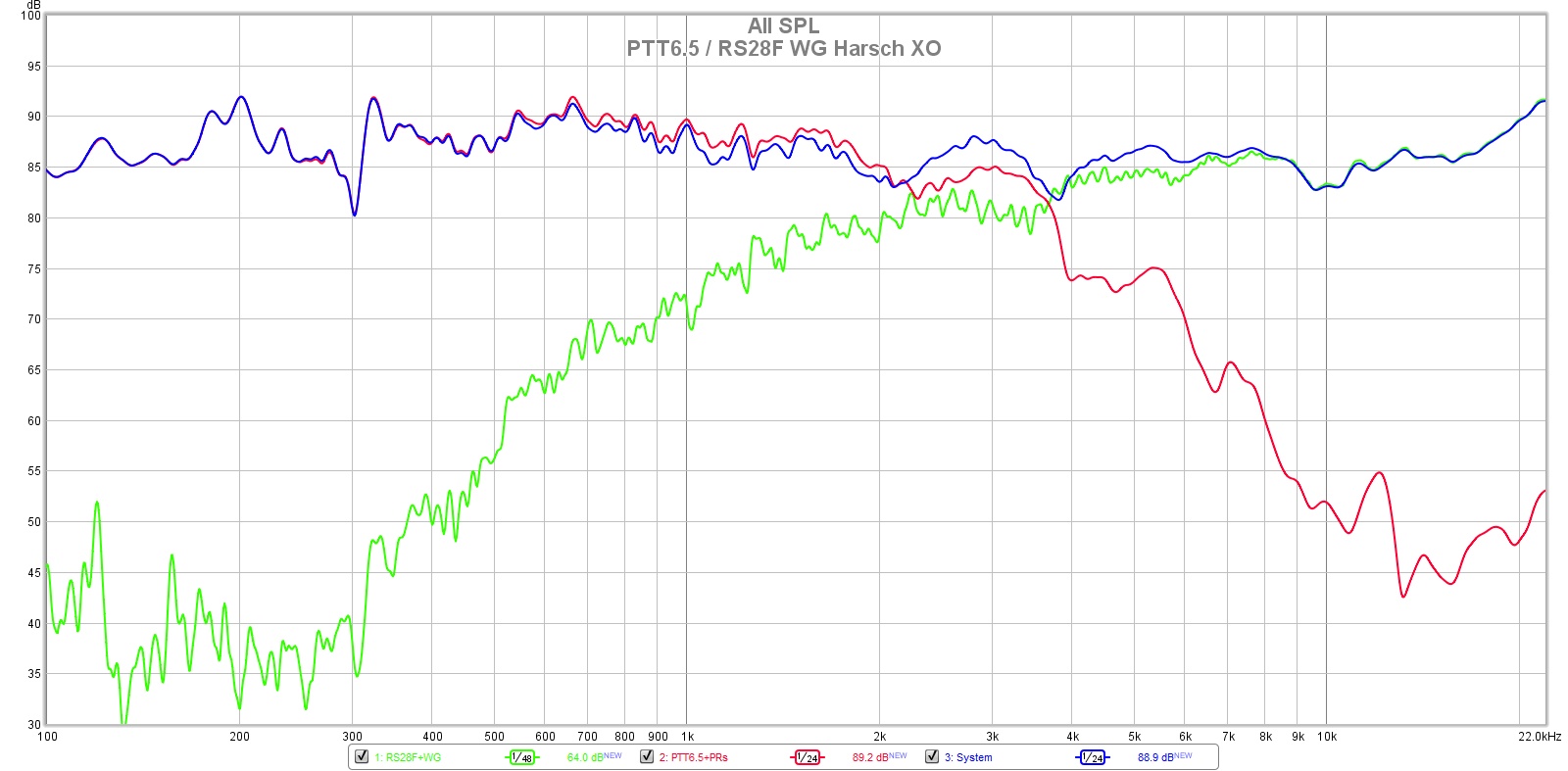

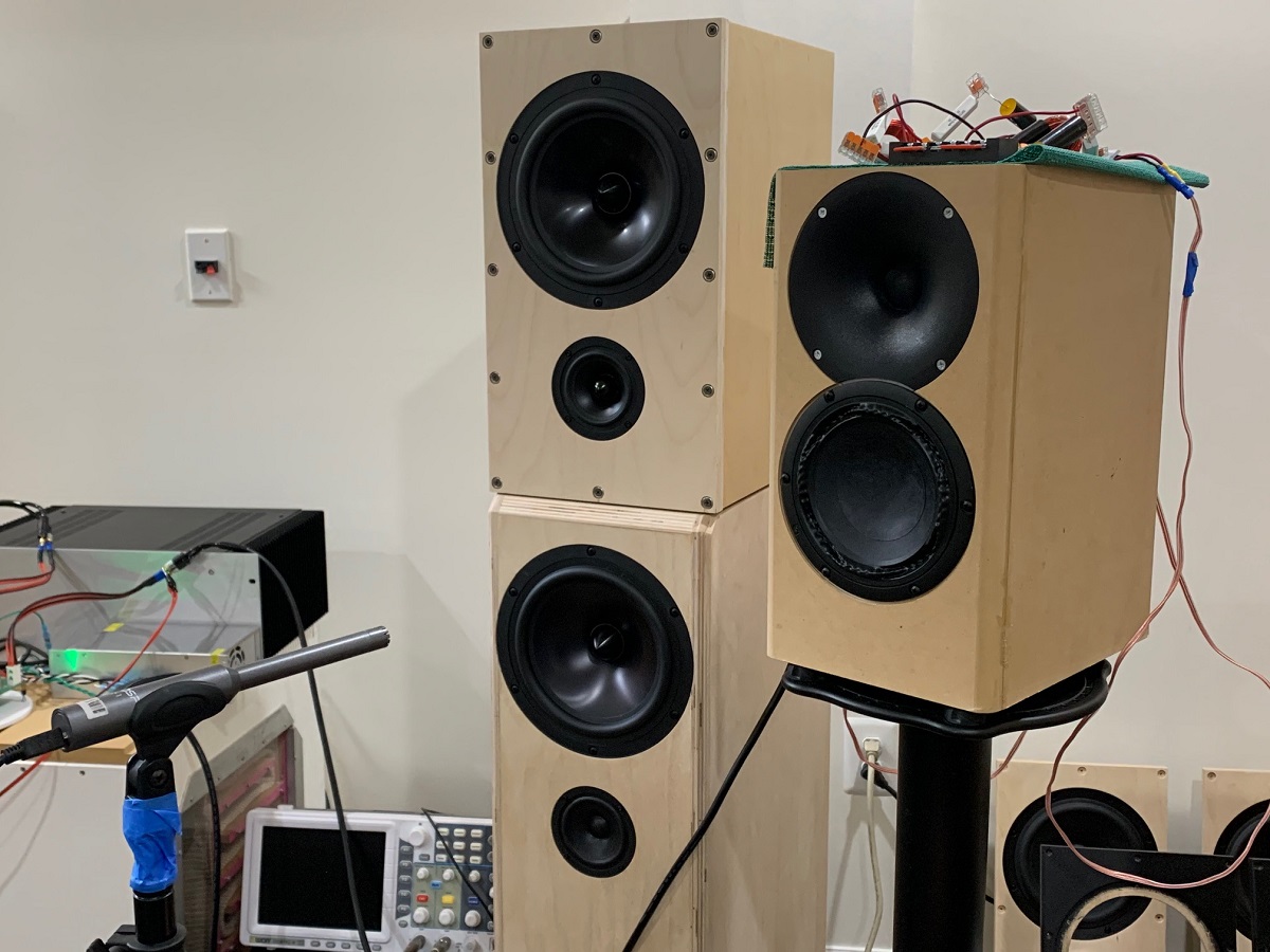

Here are the raw driver responses as measured in the box with the dual passive radiotors, and the raw response of the RS28F in a WG300 waveguide, and the predicted combined response (blue) with the measured combined response for an acoustic center offset of only 20mm. In Xsim, this refers the distance that the acoustic center of the tweeter is set back behind acoustic center of the woofer. Thanks to the waveguide and placement of the mic along the woofer axis, this helped to keep this distance very small. This data was taken at 0.5m away and with 2.00Vrms provided by my reference TPA3255 Class D amp.
Here is the setup:
Here are the raw responses (red and green) and the predicted (blue) vs measured (yellow) combined curves:
Here is the setup:

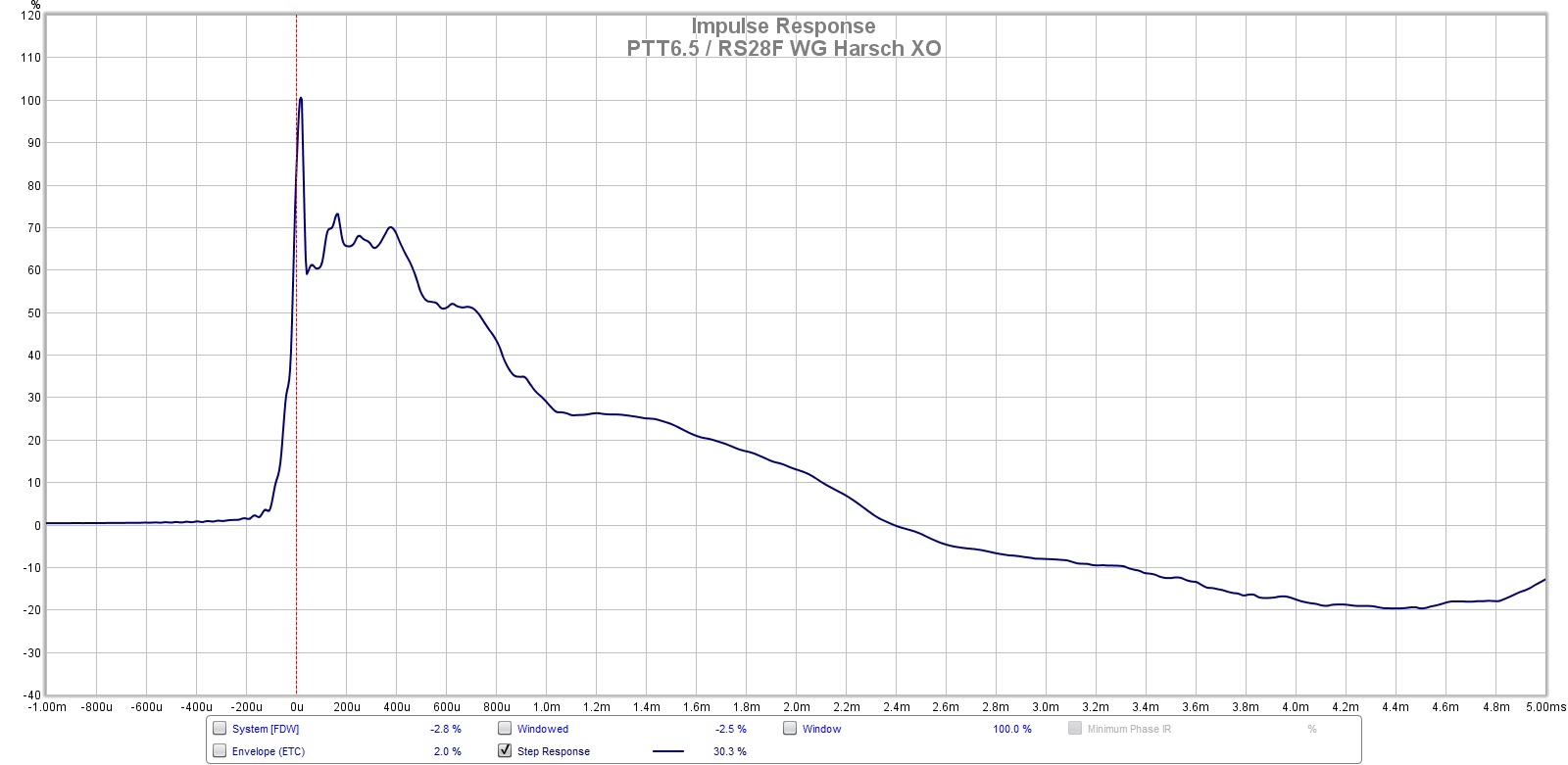

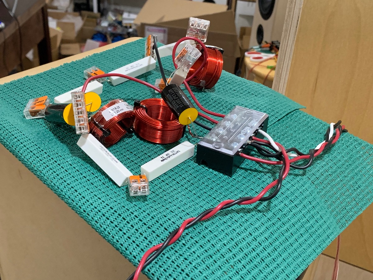

Here is my latest speaker made using the PTT6.5 - A transient perfect passive Harsch XO.
https://www.diyaudio.com/forums/mul...using-ptt6-5-rs28f-waveguide.html#post6211942
Simple XO Schematic:
Prototype XO Implementation:
Crossover Curves:
Step Response:
Crossover Curves:
Step Response:
You can see that I am either going to need better passive radiators or make a TL. The PTT6.5 can really move a lot of air - check out the video here:
