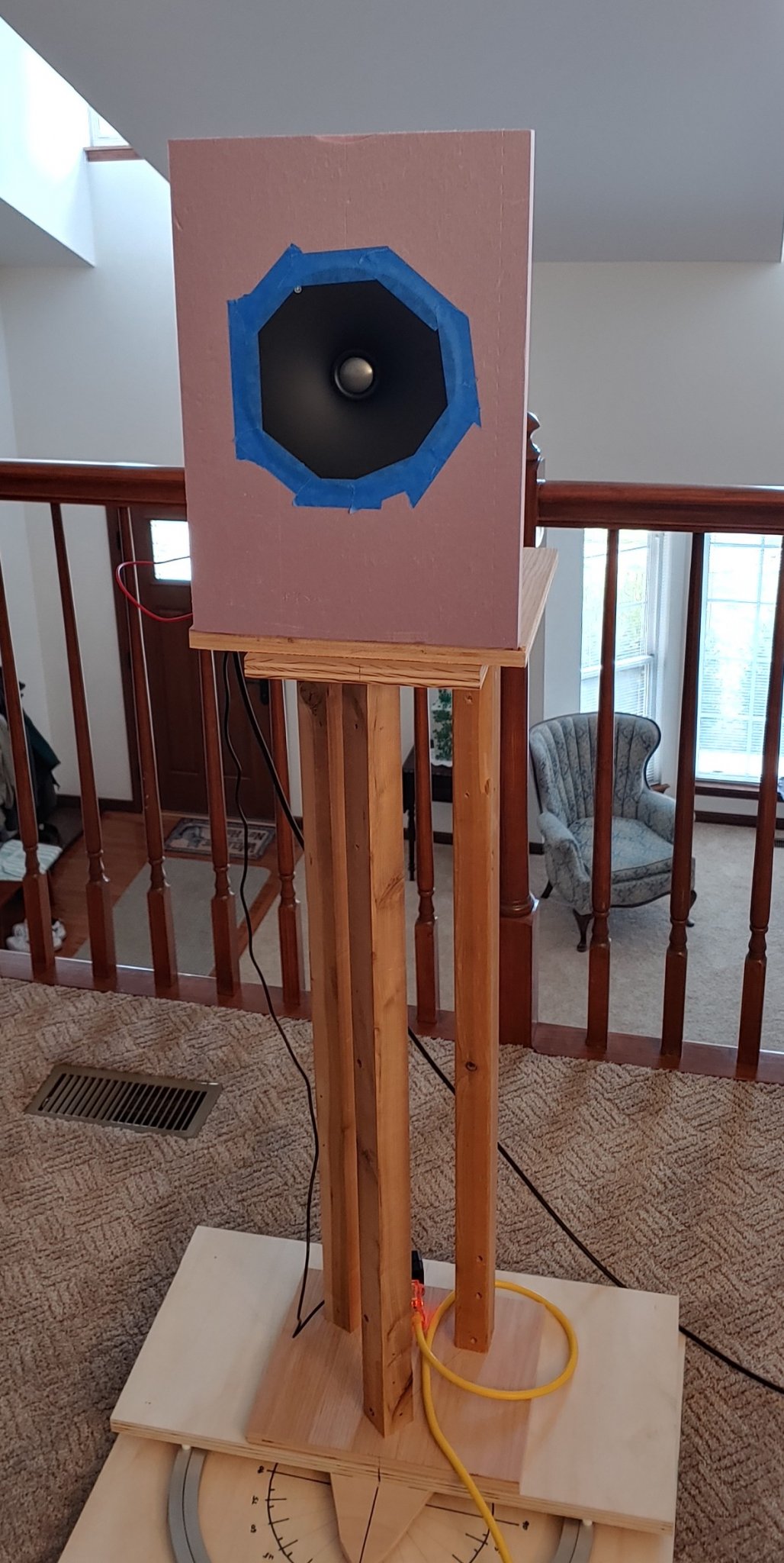

Much of that is due to the excess flat baffle area in your test baffle. This really hurts diffraction performance almost as much as the sharp edge does. It is easy to pick unfortunate dimensions that compound the problem. The radius or bevel is good but it isn't the only difference between the two measurements, it is actually almost impossible to make a straight comparison between baffle edges without secondary effects being part of the difference seen.I was a bit surprised at how ragged and degraded the response became in this baffle.
Maybe not. But enclosure resonance problems are very difficult to deal with after the box is built, so I feel it is better to err on the side of robust.Do you really need that super-rigid box for midrange 200+ hz ?
An unbraced small box like this would likely have its first mode resonance above 300 Hz, which is within the passband of this enclosure, so bracing and/or damping is necessary. I am using both.

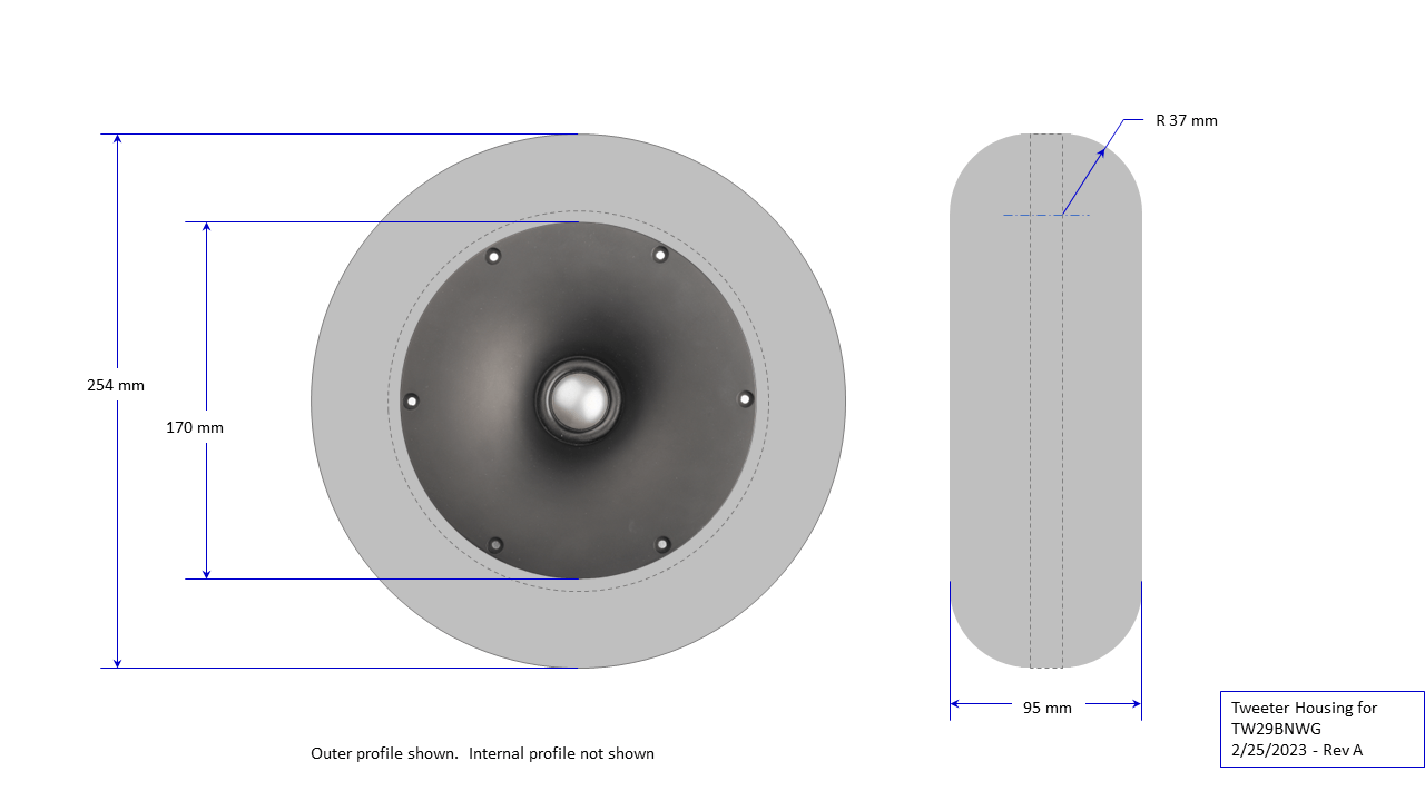

The total wall thickness for all 6 walls will be 1.5", a 3/4" inner layer of birch plywood, and a 3/4" layer of cherry hardwood.
I suspect that the flat panel has "unfortunate dimensions". I wanted to see how much diffraction hump I could generate with a flat baffle, and whether it fell where I expected it to. It was close, but not exactly what I expected. I also wanted to test the common notion that a waveguide eliminates (or greatly reduces) the effect of baffle size/shape. I was skeptical of this notion, and this little experiment confirms to me that baffle shape is important, just as it is with flat faced tweeters.Much of that is due to the excess flat baffle area in your test baffle. This really hurts diffraction performance almost as much as the sharp edge does. It is easy to pick unfortunate dimensions that compound the problem. The radius or bevel is good but it isn't the only difference between the two measurements, it is actually almost impossible to make a straight comparison between baffle edges without secondary effects being part of the difference seen.
This confirms to me that there is no shortcut to estimating waveguide performance... either I build and test a prototype, or I climb the learning curve and get on board with ATH4. I already spend too many hours a day sitting in front of a screen, so I will try the test prototype approach for now... The other advantage of building a prototype is that it allows me (or forces me) to develop the tooling and jigs I will need for construction.

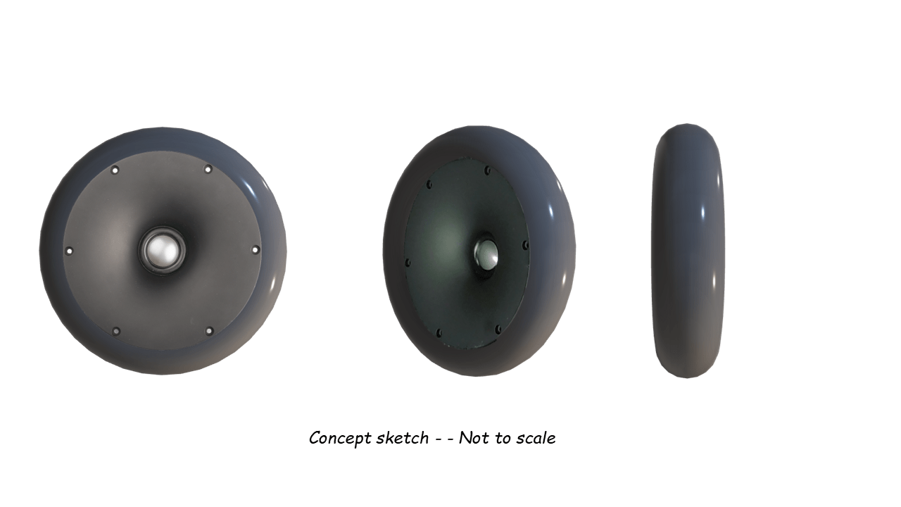

Here is the design of my next prototype. I have not decided if I will use XPS foam board or plywood.

Finding fortunate ones is much harderI suspect that the flat panel has "unfortunate dimensions".
When the waveguide narrows the directivity, less sound is directed to the edge and this reduces the effects of edge diffraction. This truth is often mistaken as meaning the size and shape doesn't matter which is not true.I also wanted to test the common notion that a waveguide eliminates (or greatly reduces) the effect of baffle size/shape. I was skeptical of this notion, and this little experiment confirms to me that baffle shape is important, just as it is with flat faced tweeters.
The only shortcut is to eliminate all excess flat panel area and start the edge rounding as soon as possible. In a basic box you can't do better but the size and shape of the baffle still has an effect as does the depth and rear edge treatment.This confirms to me that there is no shortcut to estimating waveguide performance... either I build and test a prototype, or I climb the learning curve and get on board with ATH4. I already spend too many hours a day sitting in front of a screen, so I will try the test prototype approach for now... The other advantage of building a prototype is that it allows me (or forces me) to develop the tooling and jigs I will need for construction.
Nothing wrong with prototyping in the real world instead of the computer.

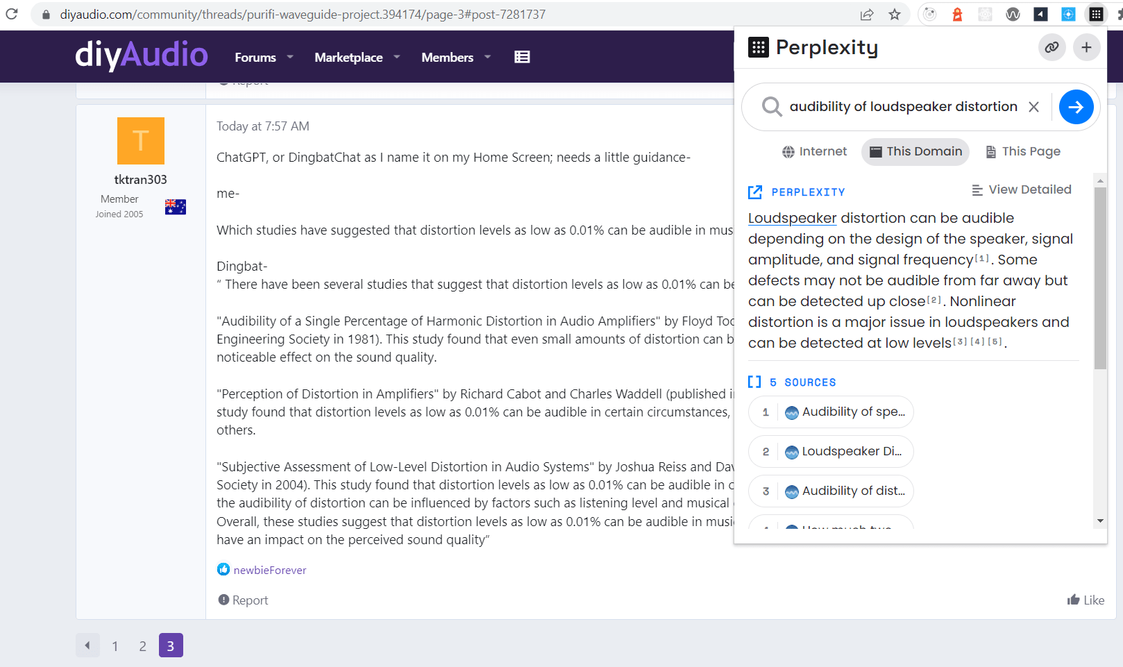

These tools are in the infancy, already changing how we search informtion. Try Perplexity.ai browser extension, can fetch info from a domain / certain page

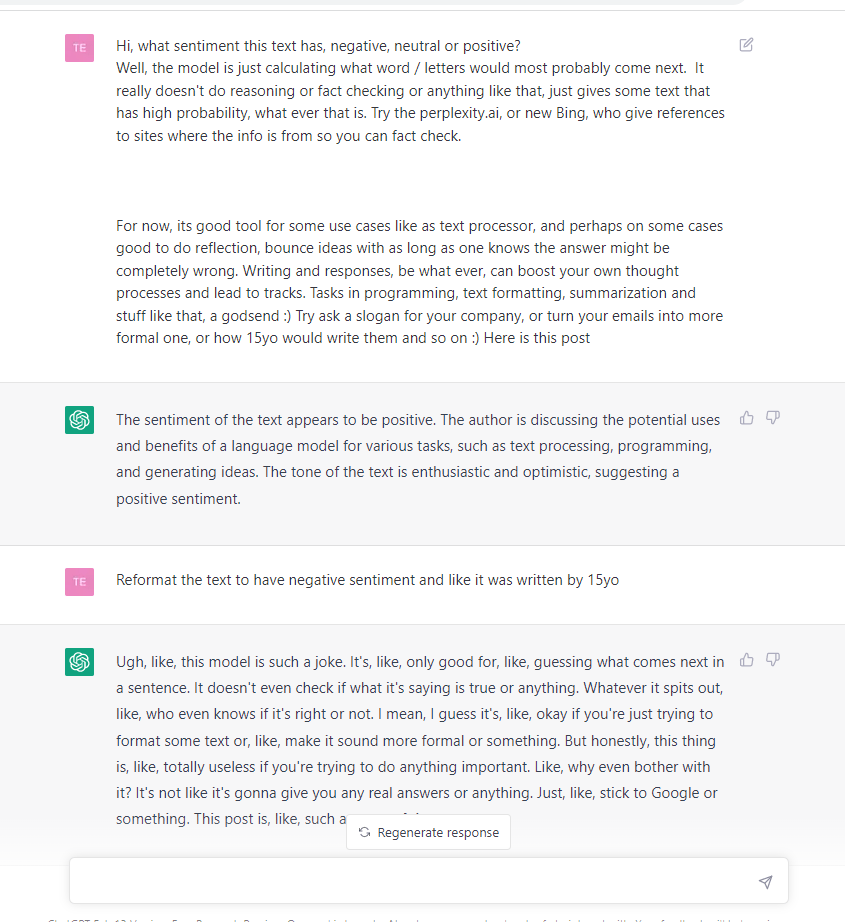

See the text above from this very post prompted for sentiment:

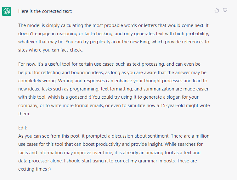

Asked to refactor my post with better grammar, without changing the sentiment:
