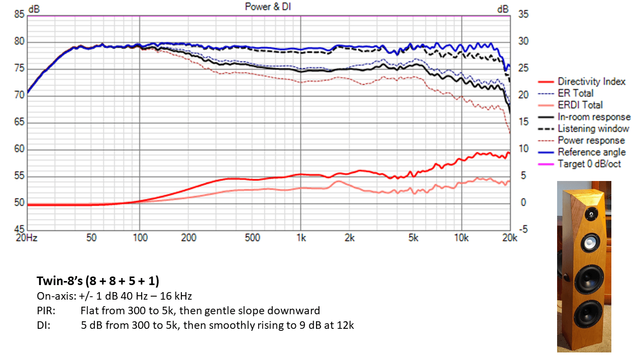

Designing crossover filters for waveguides tweeters is a little different than doing so for flat baffle tweeters. Because of this, I have been practicing with the measured response of this tweeter. It has been interesting. First a bit of background on the two earlier systems which both used flat-faced tweeters.
The first graphic shows the Power and DI response of the BT8 system. This system was designed with a minimal baffle around the tweeter, and a 1.2x wavelength CtC distance between mid and tweeter. Preliminary simulations had shown that this would work well, and it did. After collecting vertical and horizontal polar responses of each driver, the simulation demonstrated that almost any crossover topology would work well. I am showing the result with a 4th order 2 kHz crossover, but 2nd and 3rd order worked well, and any crossover frequency from 1.8k to 2.4k resulted in a good response. The goal of this speaker was a flat on-axis response, and a DI response which was flat from 300 Hz to 5 kHz, then rising from 5k up, and any combination of 2nd, 3rd, or 4th order filters from 1.8k to 2.4k achieved a +/- 1 dB on axis AND the target DI within +/- 1 dB.

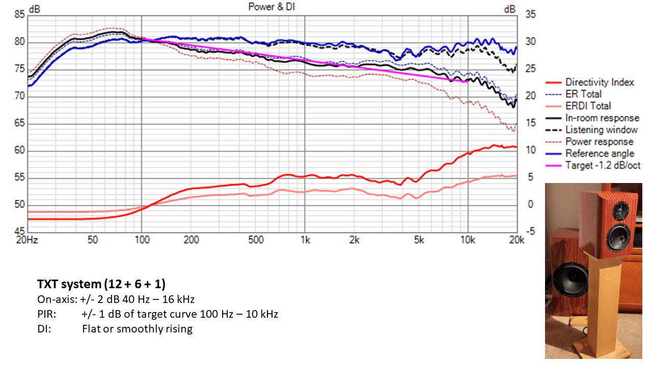

The second graphic shows the TXT system with the current crossover filter. This system has a larger baffle around the tweeter, and a CtC spacing of about 0.75x wavelength from mid to tweeter. The goal of this filter is to optimize the Predicted In Room response. The target PIR was -1.2 dB per octave, and this filter achieves that goal within +/- 1 dB. However, it was challenging to get to this point, and I had to allow some increased variation in the on-axis and listening window curves. Getting good all-aspect performance from this system required balancing a lot of tradeoffs. The only filter that really worked is a 3rd order at 1.8k.

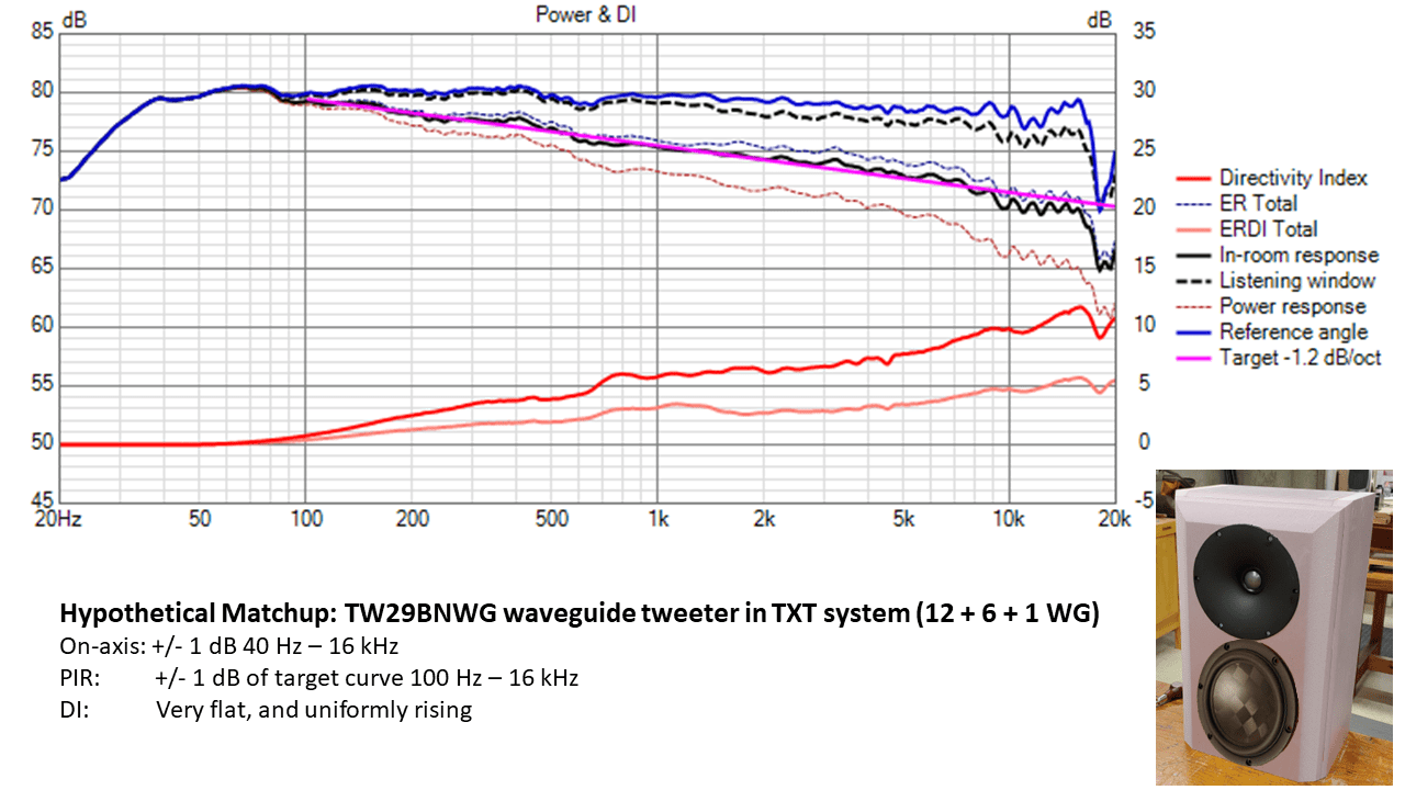

The third graphic represents a hypothetical matchup, a thought experiment. What would happen if I could replace the flat-faced tweeter response of the TXT system with the measured waveguide tweeter? The cabinet width of the TXT system and the foamboard prototype are close, so it’s a valid hypothetical.
In this case it is easy (almost too easy) to achieve excellent simulation results. The on-axis curve is very flat, and the PIR curve matches the target -1.2 dB/octave. The filter between mid and tweeter is 4th order at 1.6k but other combinations worked well. The woofer to mid is at 200 Hz as before.
Of course the radiation pattern of the Purifi will not exactly match the MW16TX-4, and the cabinet differences will shape things also. But it is an interesting hypothetical. It illustrates why waveguides have become popular among designers.

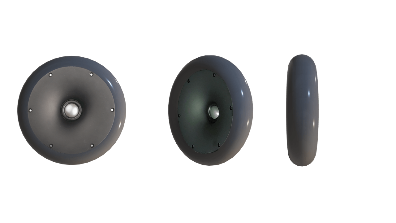

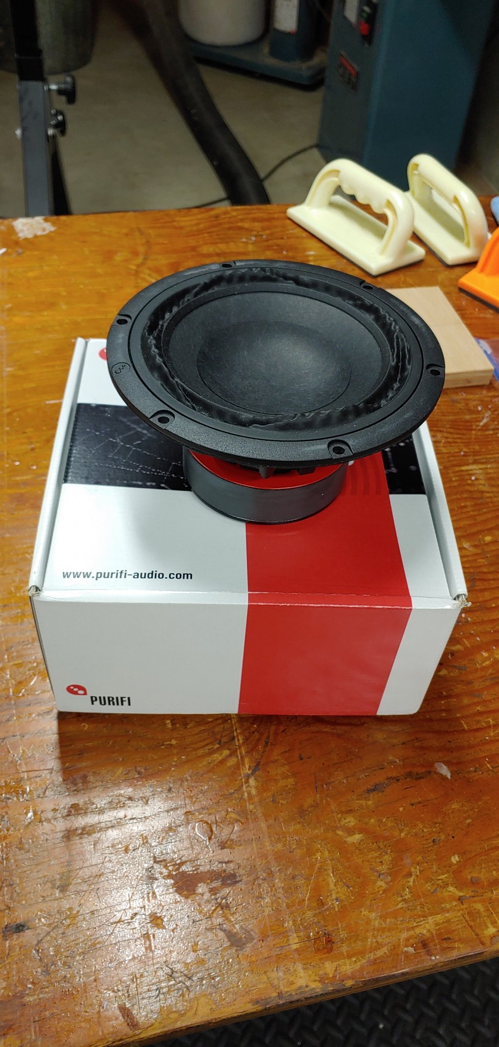

My Purifi PTT6.5M04-NFA-01 drivers arrived about a week ago. I am now finalizing the cabinet design.
My earlier sketches had the midrange and tweeter mounted in a single box. I simulated a variety of layouts, spacings, edge bevels/shapes. A lot of my better design concepts looked a lot like the March Audio Sointuva. This is a design which I have great respect for, but I did not really want to mimic this product so closely.
I am also influenced by the experimental work of @HeadShake with is naked floating tweeter. There is definitely something special about a tweeter with minimal baffle floating freely in space.
My current plan is to build a separate box for the midrange driver alone. This will be a highly profiled (rounded, beveled) box of approximately 12"H x 10"W x 9"D. Above this box will be a separate housing for the tweeter.
The tweeter housing will be cylindrical with radiused edges. The tweeter baffle will continue the profile of the waveguide all the way around to the back of the housing. The waveguide is about 6.75" diameter, and the housing will be 10" diameter, with a 1.5" radius. The cylinder housing will have a depth of about 3", and the rear will have a 1.5" radius as well.
The attached graphic is conceptual, it is not to scale. But it gives an illustration of what I am thinking at this point.

The TW29BNWG has a hole at the back of the chamber. Not sure if it is just cosmetic or it opens into the cone. And not sure if a shallow housing will have any effect.

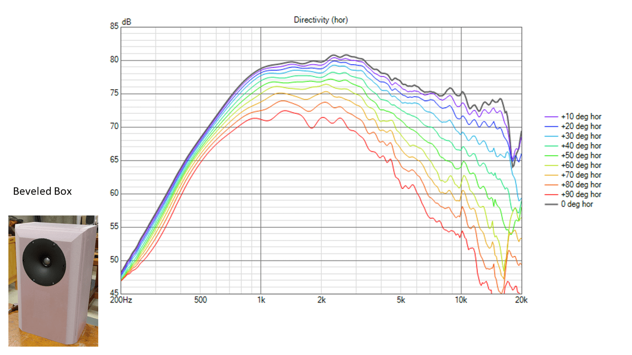

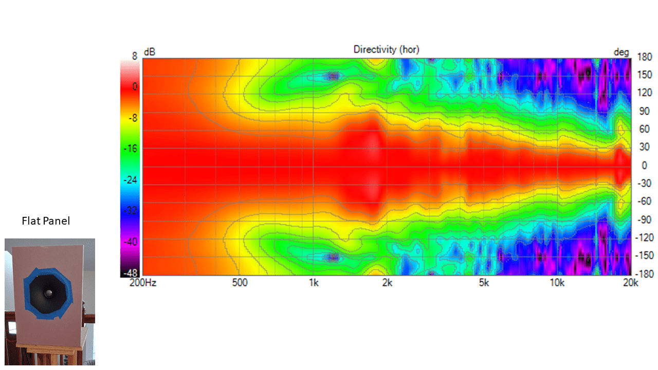

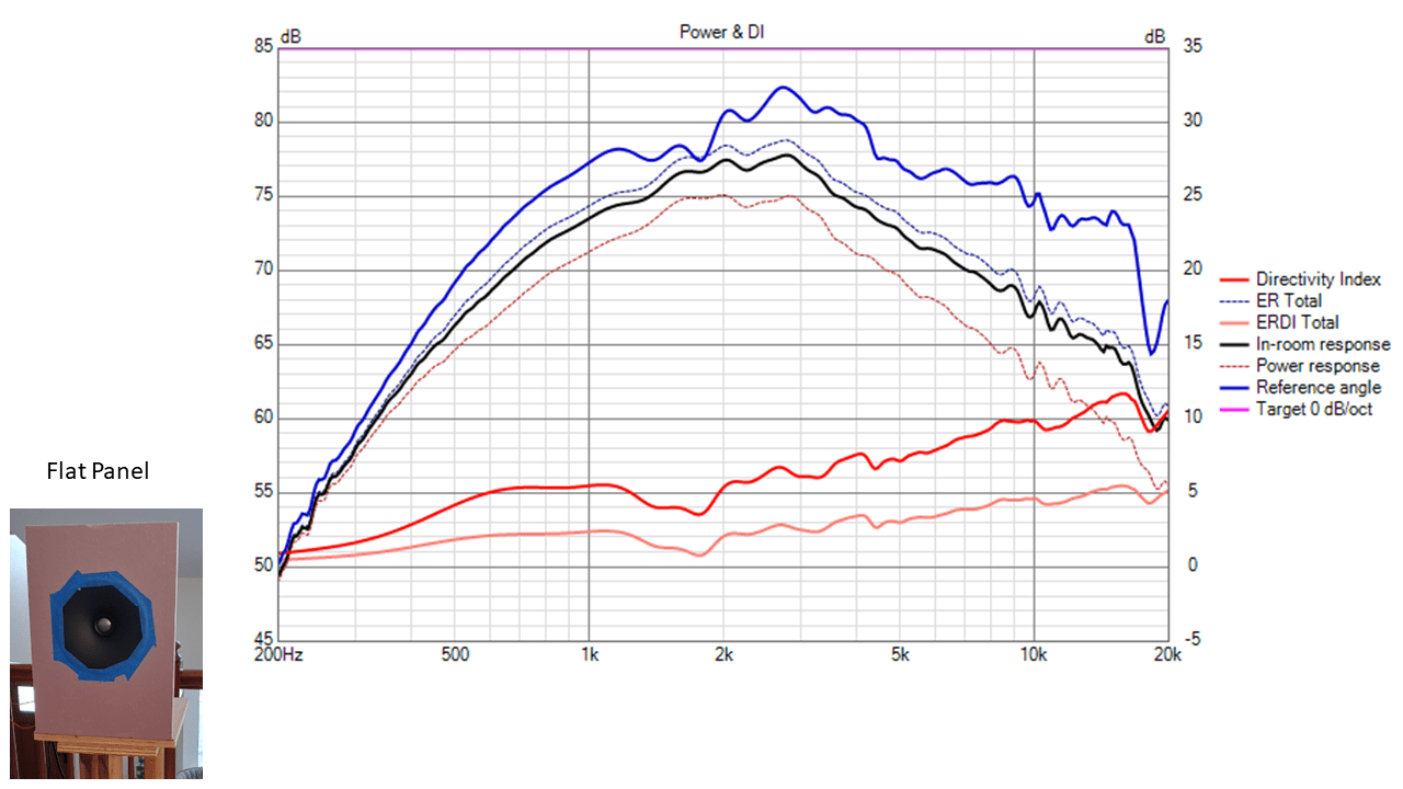

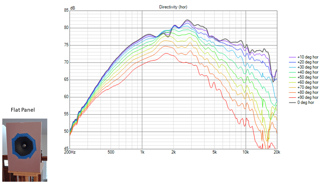

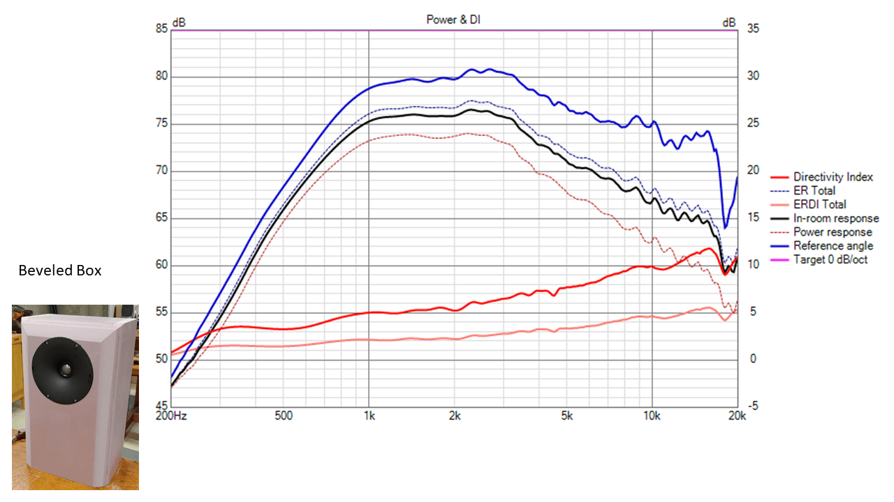

I wanted to see how much effect a beveled/radiused baffle had on the performance of this waveguide tweeter. So I constructed a flat panel baffle with a sharp square edge. The baffle was 10 7/8” x 15 ½” (275mm x 395mm). The driver was recessed flush with the surface, just as in the beveled box.
I was a bit surprised at how ragged and degraded the response became in this baffle. To see if I could improve the performance, I applied tape to smooth the small 1 mm discontinuity between the waveguide termination and the baffle. It helped a small amount, but not enough to be significant.
As you can see, the beveled box (described in post#2) has a significant performance advantage over the sharp edged baffle.
I have a few more prototypes to test before I settle on a final design for the tweeter baffle/housing. I am now considering a hexagonal shape. It might be easier to construct than a circular housing, given the tools and equipment I have. It may also be more aesthetically correct.

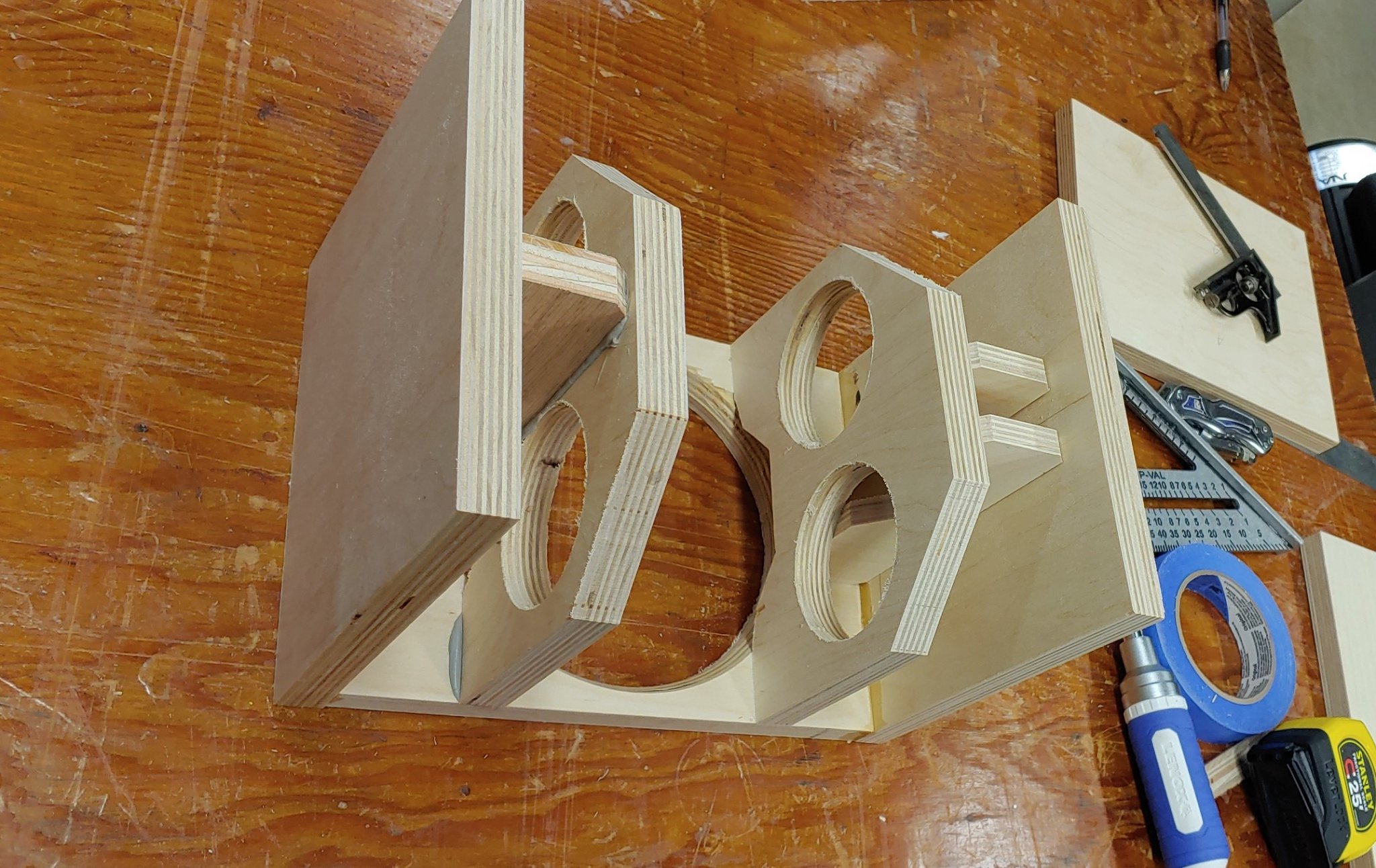

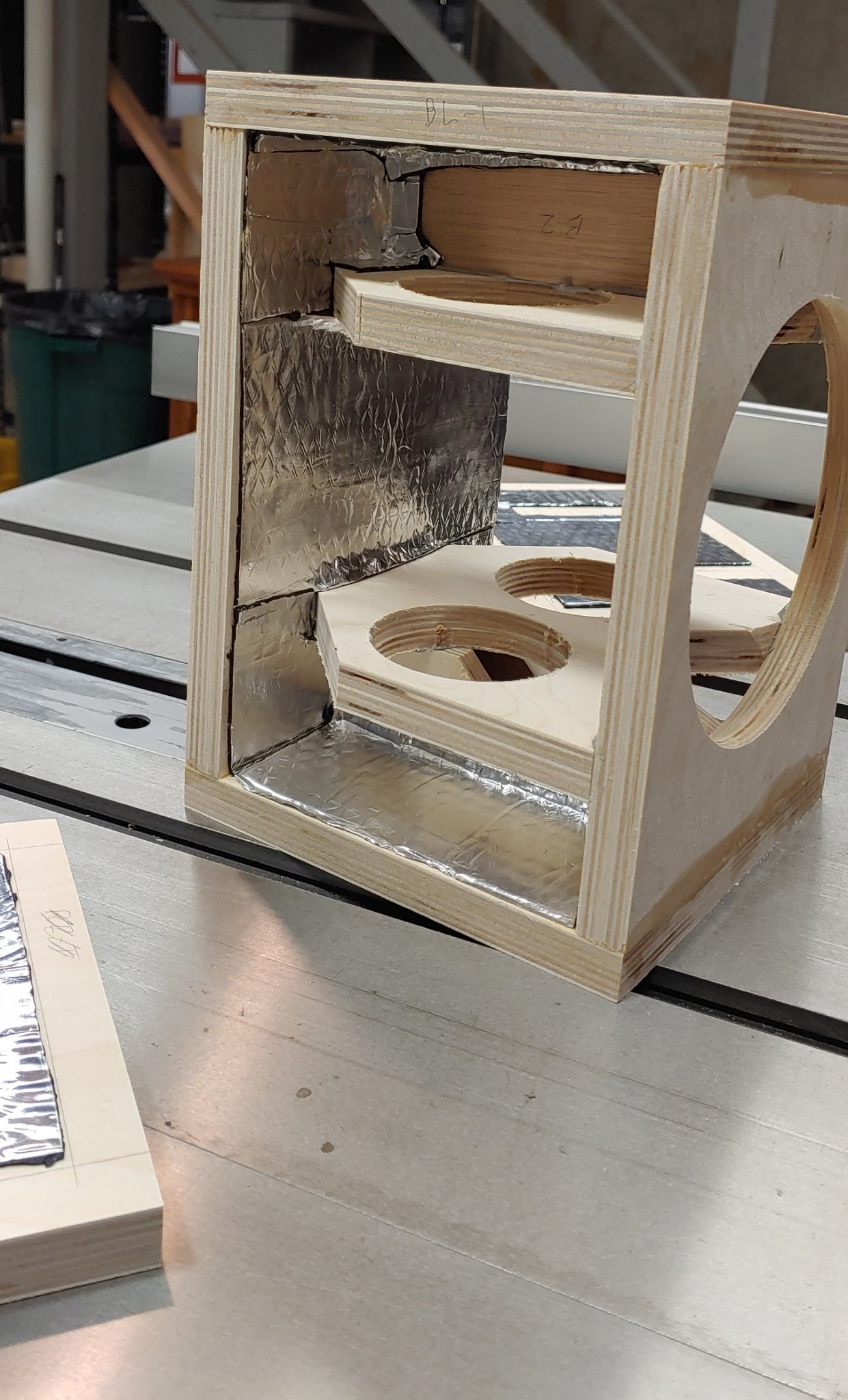

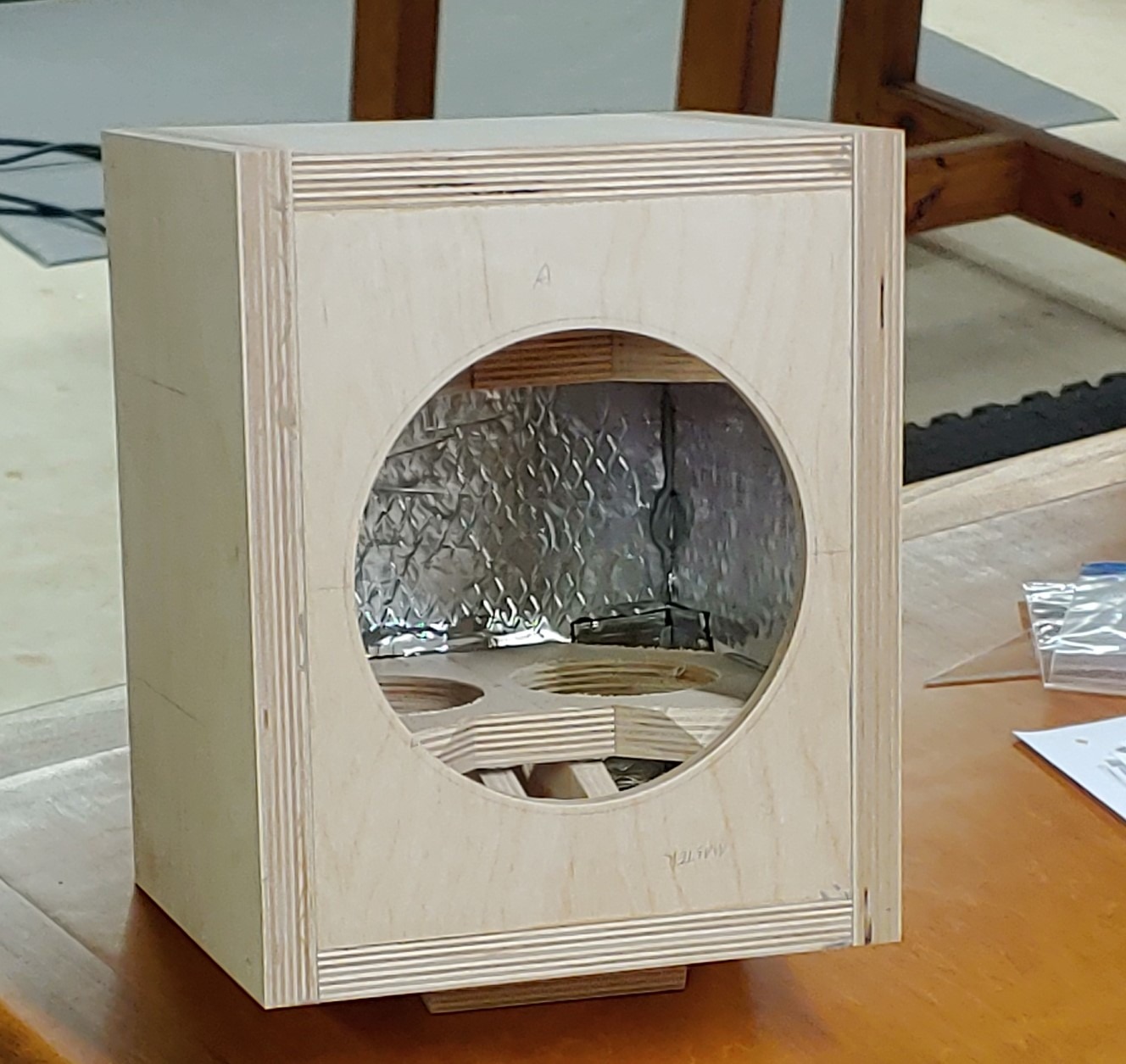

The midrange enclosure is designed. There is really not much complexity to it, given the size and the frequency range of the mid driver from approximately 200 - 2000 Hz. Since the design in complete, I decided to move forward with construction even though I have not finalized the design of the tweeter housing.
What I have shown in the pics is the inner carcass. I am using a lining of foil-backed butyl rubber damping. My last several projects have relied heavily on veneer for the cosmetics, and I am in the mood for something different. I am in the mood to work with solid wood again, so this project will be sheathed in solid wood. There will be an outer carcass of 3/4" cherry wood, and this layer will be beveled and contoured to minimize high frequency diffraction. I am looking forward to being able to shape and contour solid wood in a way that is not possible with a veneered surface.

You may want to increase your enclosure radius even more if you can. I used kerfed MDF and filled the slots with coarse fiberglass filler (aka kitty hair). The main offender with diffraction is the smaller radius based on my research. The golden ratio of enclosure dimensions may help further smooth FR out. Just a thought.
Do you really need that super-rigid box for midrange 200+ hz ?
good needlework (y)
