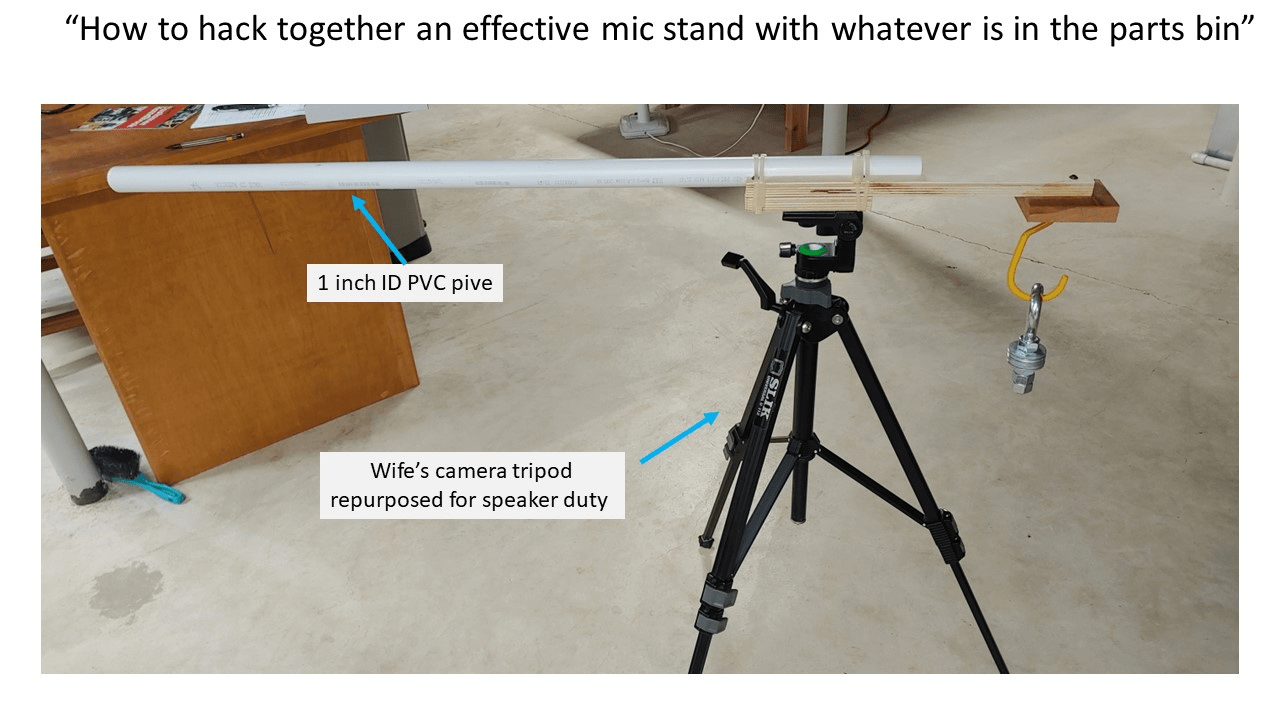

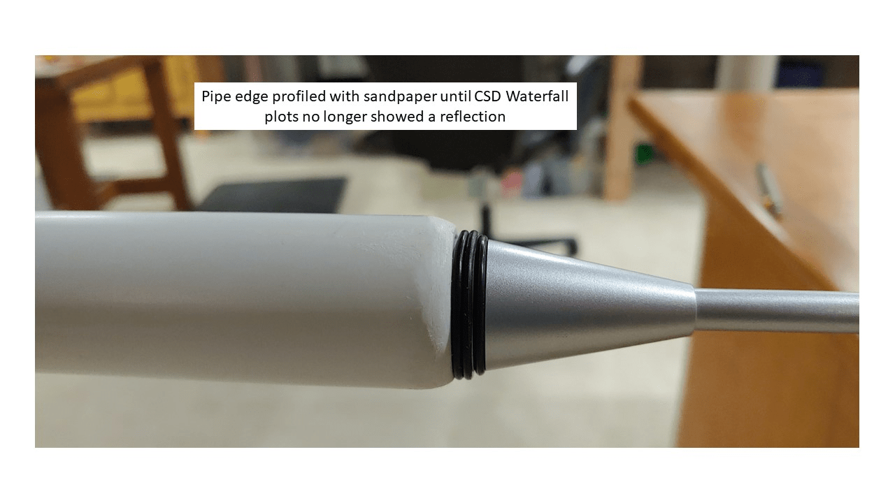

I agree the mic holder is critical.

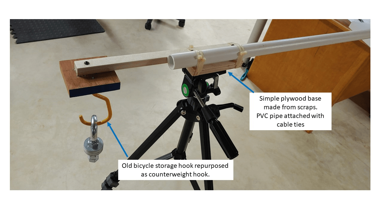

I like the 3D printed parts...I've made a mount to attach a 1 to 2m long aluminium tube onto a lighting stand
My mic stand is substantially less elegant... I threw it together one morning from scraps I had laying around...
j.
Thanks, I like your counterweight. Mine was also cobbled together out of left over bit's I had, off cut of 2040 extrusion, lighting stand was free as the shop couldn't find a price for it and gave it to me 🙂I like the 3D printed parts...

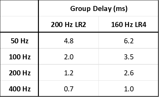

Once again, I have confirmed that for low frequency crossovers, I just do not like filter slopes higher than 2nd order.
I tried a 4th order crossover instead of the baseline 200 Hz LR2 crossover. My thinking was that I might achieve something positive by more thoroughly isolating the bass frequencies from the midrange, and keeping midrange signals out of the woofer. I tried crossover frequencies from as high as 250 Hz down to a low of 120 Hz. I thought that 160 Hz sounded best, or least bad, but it was not as good as the baseline 2nd order.
I immediately noticed a dullness on bass transients with the alternate 160 Hz LR4 crossover, particularly with electric bass and drums. It was as if the leading edge of the notes were removed. There was also an inferior presentation with nearly all bass register instruments, including double bass, bass clarinet, electric piano, baritone sax, piano, all percussion instruments. It was harder to follow the bass line in all music. Male vocals suffered.
I have noticed this before with other systems I have built. I have a theory that what I am hearing is the effects of group delay.

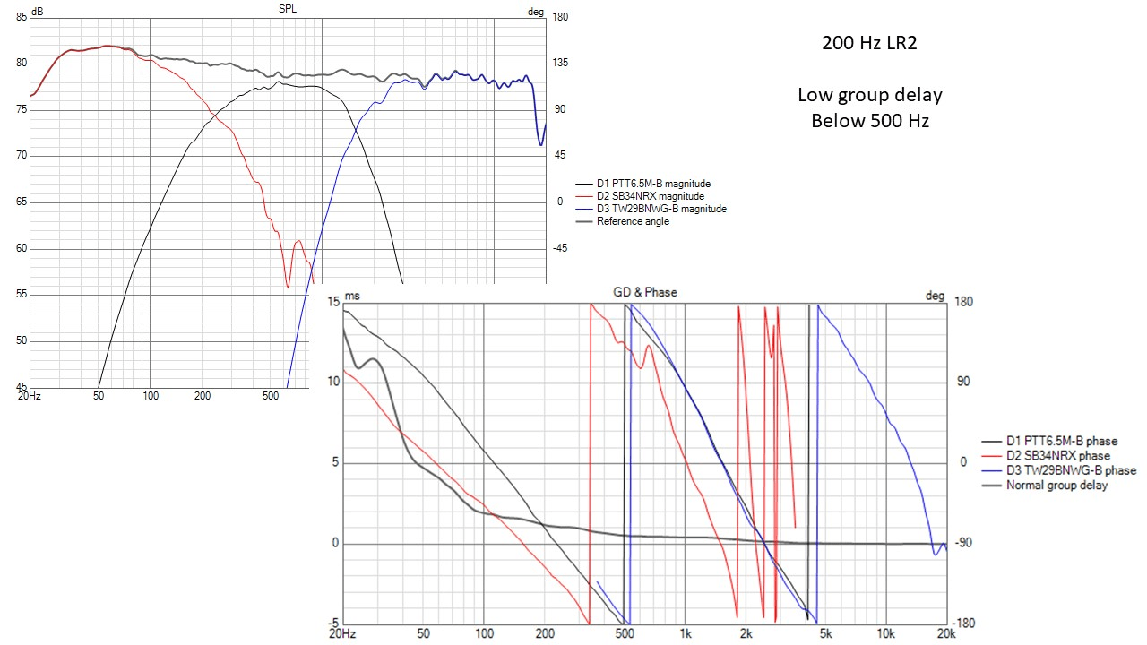

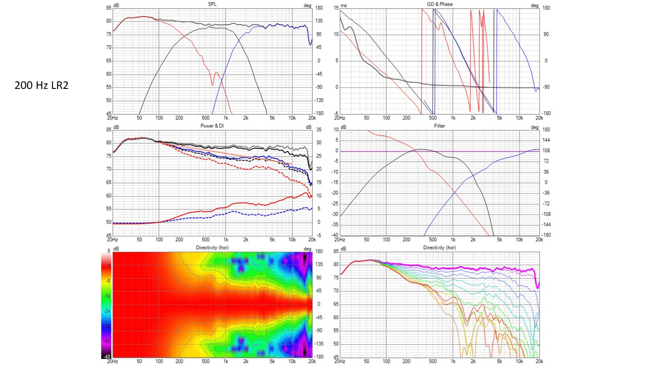

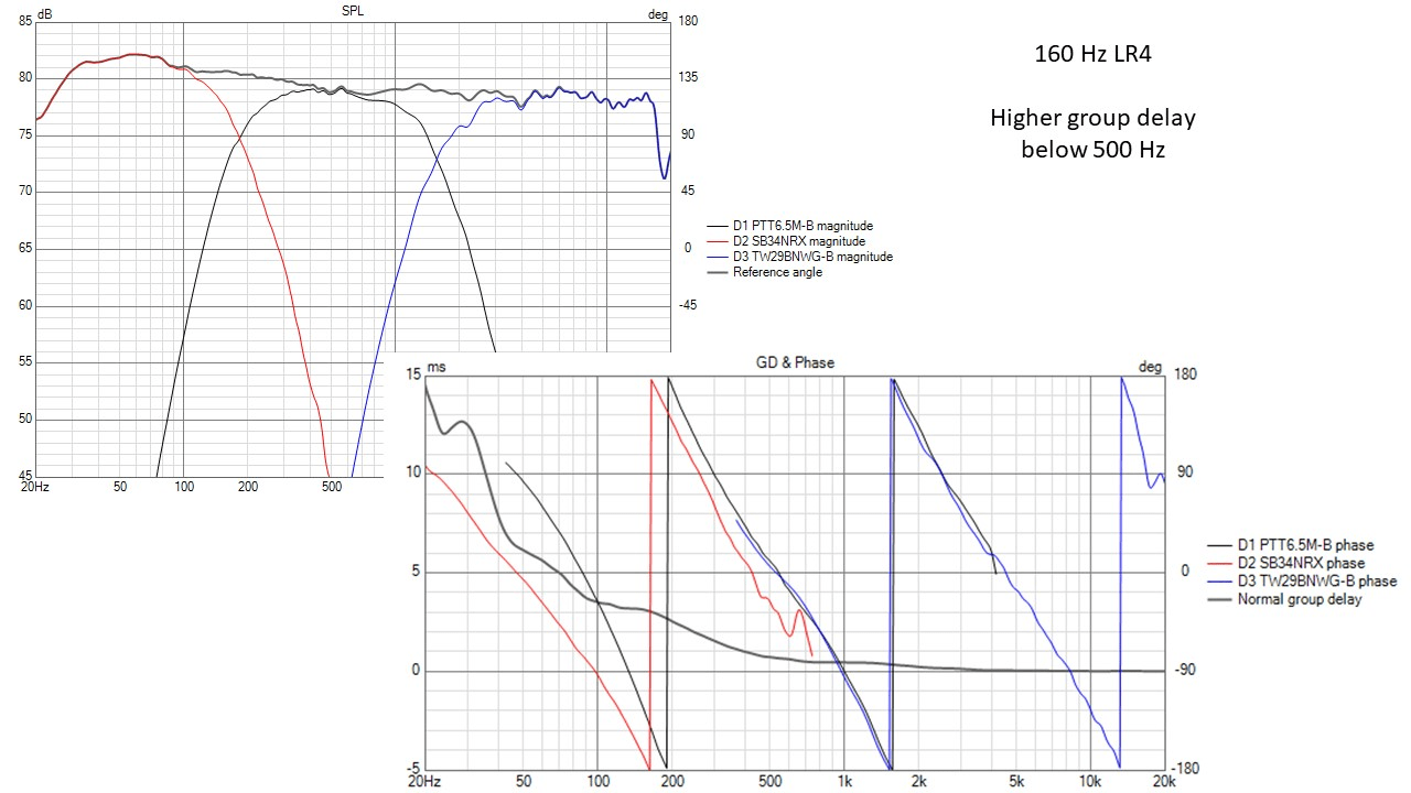

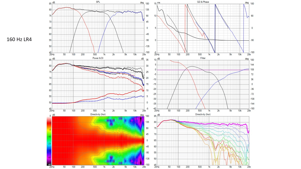

Shown below is the six pack for the two different DSP filters. This is my "pop music" DSP preset which has a slight downward slope.
Now shown is a close up of the phase and group delay plots
Overall, there is very little difference between the the two DSP filters in terms of frequency response. The sound power, DI, horizontal polar response, all of these are quite similar. What is dramatically different is group delay below 500 Hz.
So that is my theory. Group delay below 500 Hz is an important factor in the quality of bass presentation. Or to be more precise, group delay below 500 Hz is highly correlated to my perception of bass realism and accuracy. I suspect that I am more sensitive to this phenomenon than most.
I know this is not exactly ground breaking research, and the concept that group delay is important to bass quality is an idea that has been percolating about for decades. But the psychoacoustic studies are inconclusive, and I am not aware of any industry guidance on what level of group delay is acceptable. So for me, this is interesting information.

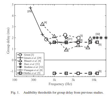

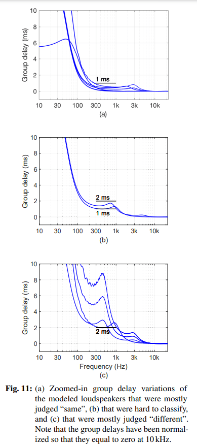

There isn't a definitive conclusion with a specific number but many of the studies converge in a broader sense.But the psychoacoustic studies are inconclusive, and I am not aware of any industry guidance on what level of group delay is acceptable.
I think this one is good from the point of view of a worst case scenario, in that the test is difficult and it was done with headphones.
Keeping GD under 1ms from 300Hz to 1KHz, was the threshold of not being able to hear the difference.

Simulations with a 400 Hz LR4 show that group delay rises from 0.5 ms at 1k to about 2 ms at 300 Hz, and then stays constant down to 100 Hz where it starts to rise again. So maybe this would be fine? Maybe it is the change in group delay in the crucial 100 - 400 Hz range?
Kimmo has suggested looking at excess group delay and keeping "Excess GD <2 ms at 100 Hz"So maybe this would be fine?
My experience seems to confirm that guidance. Thanks for that tip!Kimmo has suggested looking at excess group delay and keeping "Excess GD <2 ms at 100 Hz"

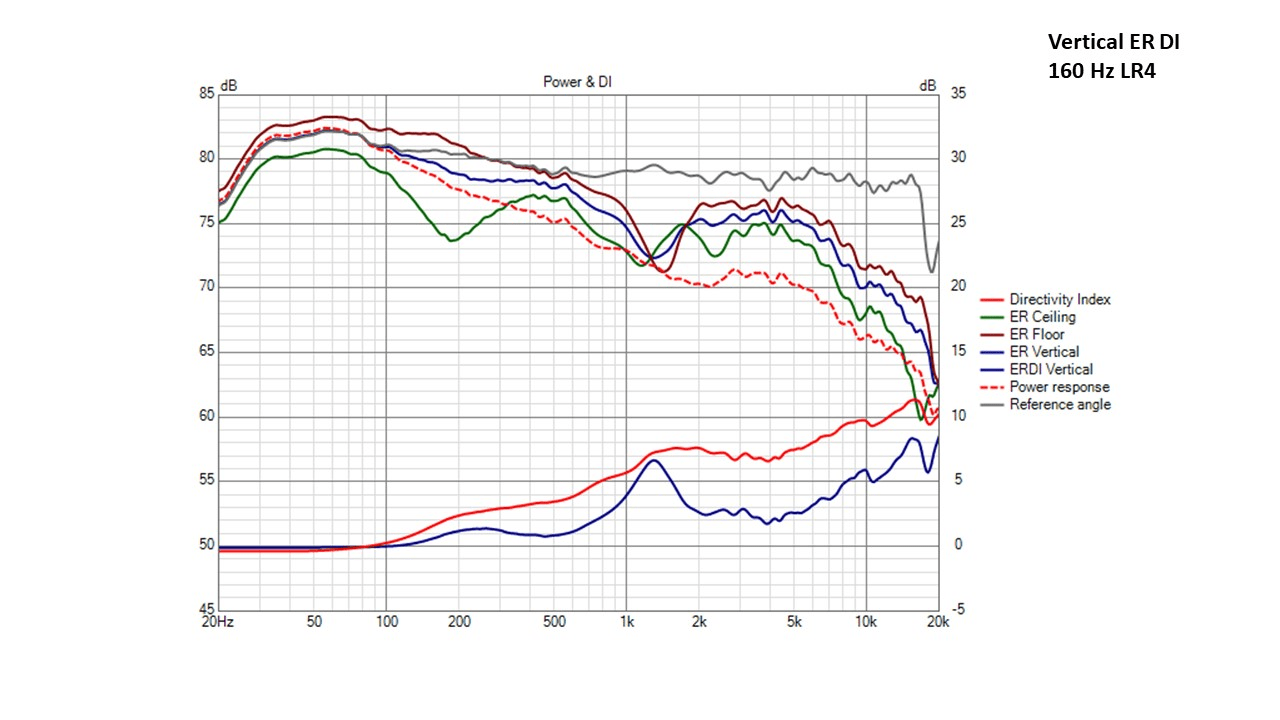

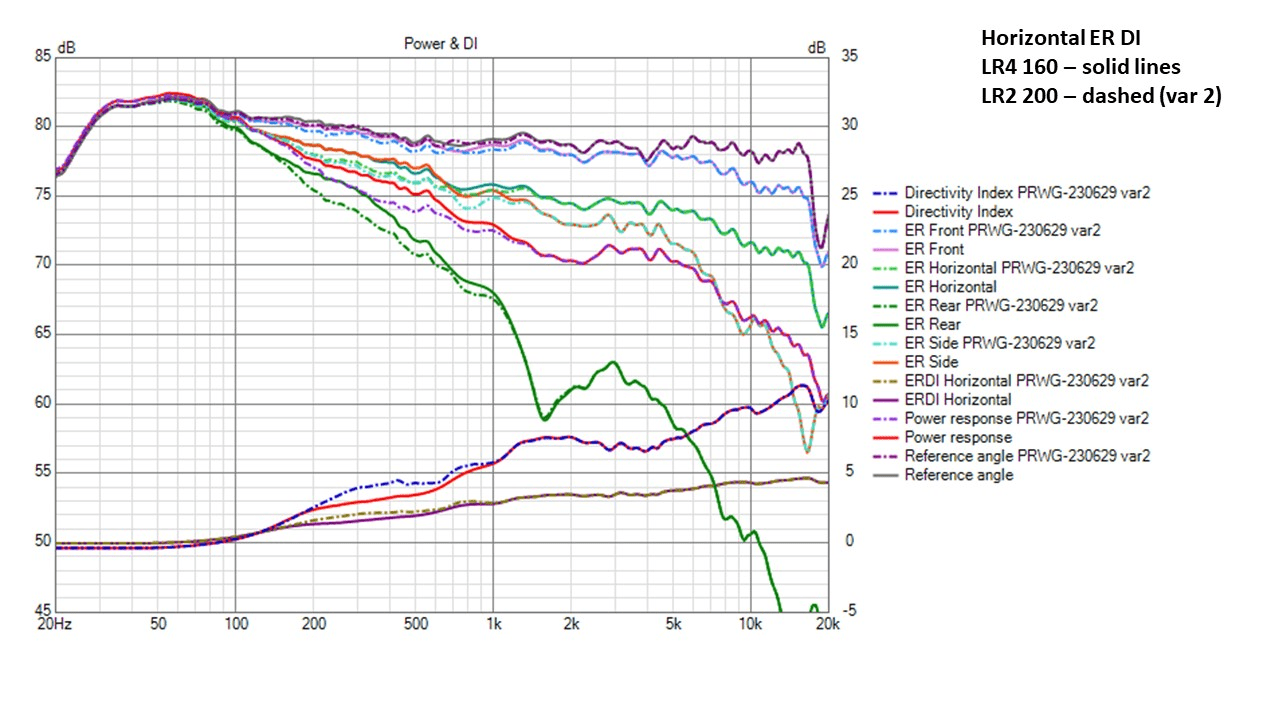

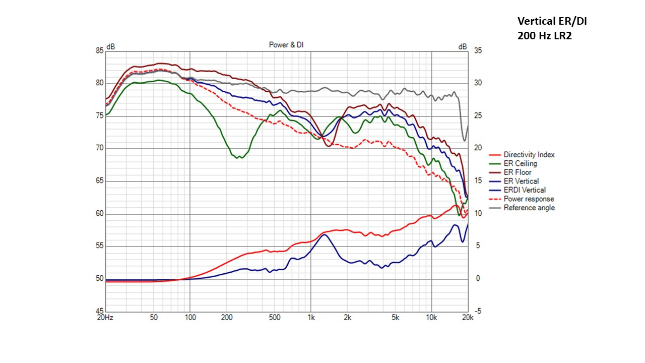

Piggybacking on Fluid's comments, what do the early reflections look like, broken out into horizontal, floor, and ceiling? Might be something interesting there that isn't captured by the gobal DI and PIR.
See if anything here makes sense to you... The horizontal power and DI are so similar between the two filters, I very much doubt they have any bearing.
The vertical Power and DI curves do have some differences. I am not smart enough to have an opinion about these vertical curves
