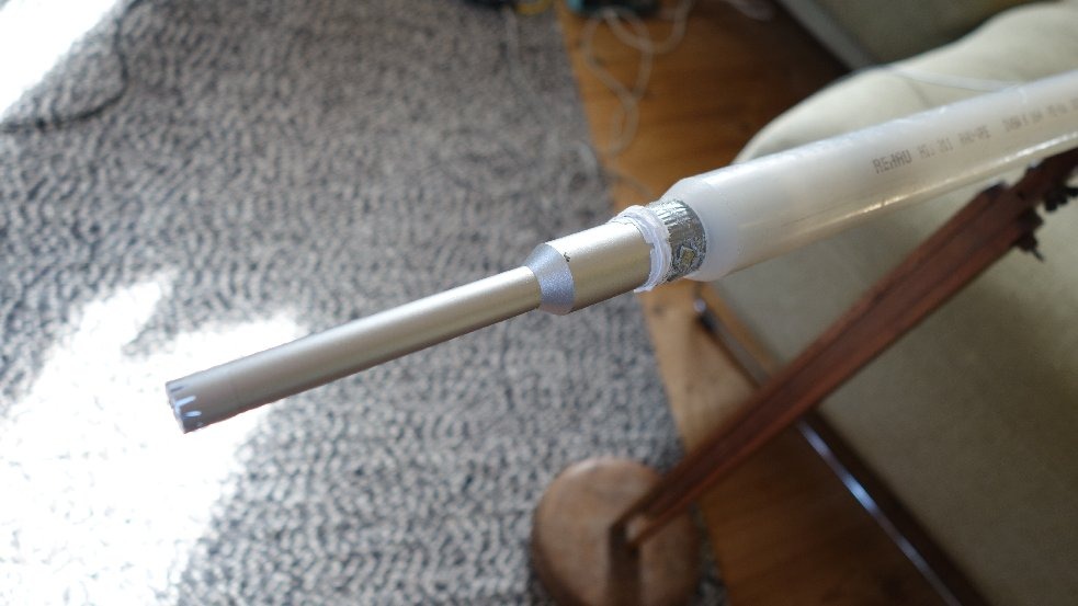

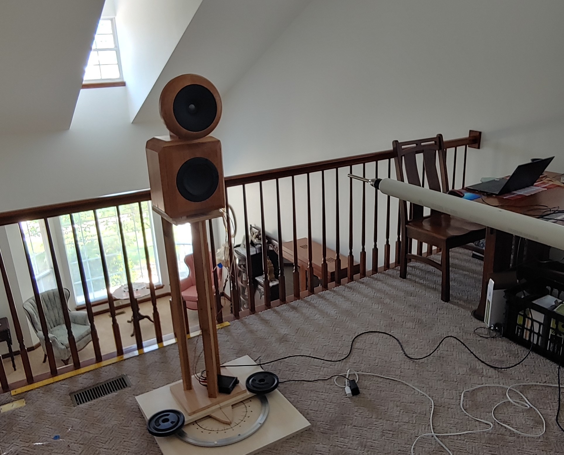

First time I've seen anyone else use the "mic in pipe" measuring setup like I have. I simply did it because I found a fitting pipe in my dads workshop, and read/thought that it was a good way to avoid unnecessary reflections - also to save money by building it myself and reuse and old wooden stand from my grandfather.
Did you put an angle on the end of the pipe to reduce reflections, like on the mic? I put mine in a lathe and made a simple 45 degree cut to imitate the design of the mic.Cool angle stand 👍
I rounded the profile of the plastic pipe with 100 grit sandpaper. I smoothed it until I no longer got a reflection in CSD waterfall plots.Did you put an angle on the end of the pipe to reduce reflections, like on the mic? I put mine in a lathe and made a simple 45 degree cut to imitate the design of the mic.

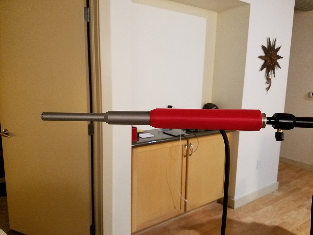

I agree the mic holder is critical. You just can't use the normal saddle without ripples showing up in the treble. Attached are .stls for the Dayton EMM6 and Behringer ECM8000 for anyone that wants to print their own mic holder.

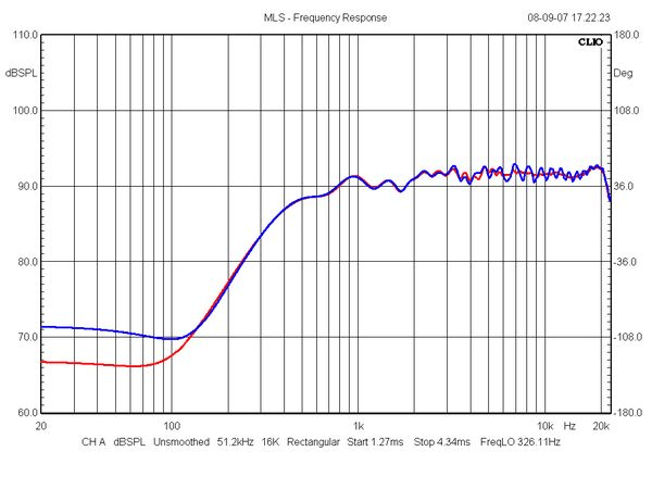

If i were to measure with different distances say 80, 100, 120cm and some ripples present in each result, could that be from the mic holding device?

perhaps yes... I think the best way to identify reflections near the mic is to measure a well-behaved tweeter and look at the CSD waterfall or burst decay plots.If i were to measure with different distances say 80, 100, 120cm and some ripples present in each result, could that be from the mic holding device?

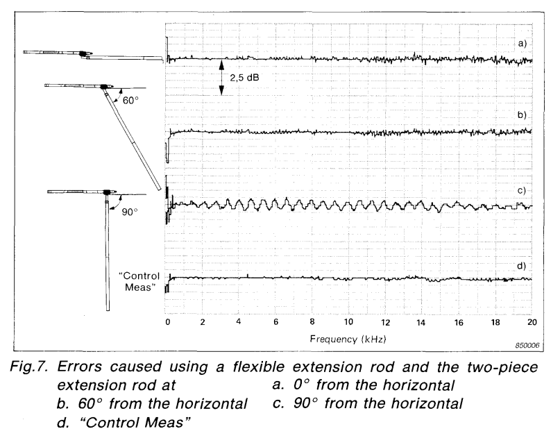

Doesn't that apply to any calibration? Shouldn't we always keep mic pointed to speaker? When taking off-axis we rotate the speaker on a turntable.That will not work for multiple angles, as with any diffraction it is angle dependent and it cannot be calibrated out other than for a single axis.
My Minidsp Umic-1 came with two cal files, 0 and 90deg. The 90 is for room rta with the mic pointed up.
Have you guys checked Troels' mic test, here is copy - the effect is shown above 3kHz, not below 120!
This old paper from B&K shows hows the problem develops, the biggest issue is the return from a 90 degree stand to the capsule. Having the mic in a long enough tube or the arm of the mic behind the mic body gets rid of most of the problem. Wrapping the join in automotive felt or foam works well to get rid of any little spurious reflection from the body or joints.

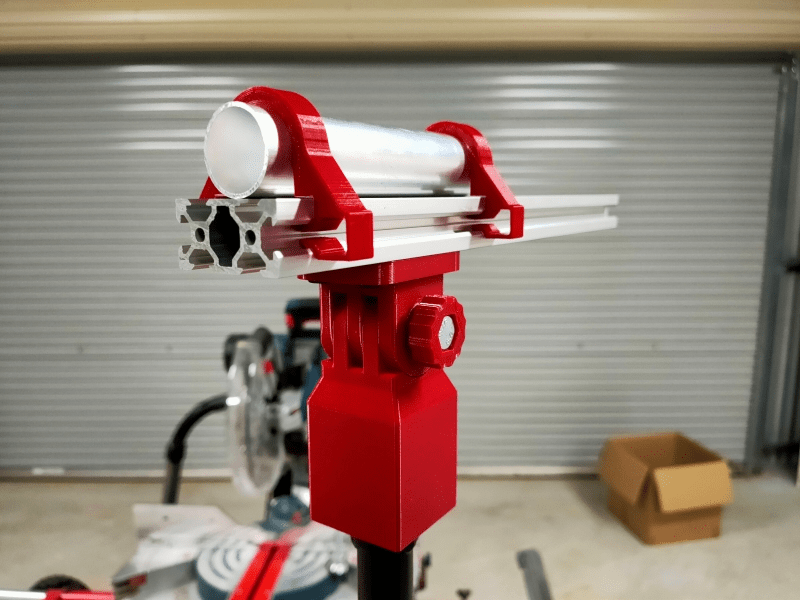

I've made a mount to attach a 1 to 2m long aluminium tube onto a lighting stand (short test tube in below image)
Nice work Fluid, and also like your choice of color (red) for the DIY mount contraption. 🙂
