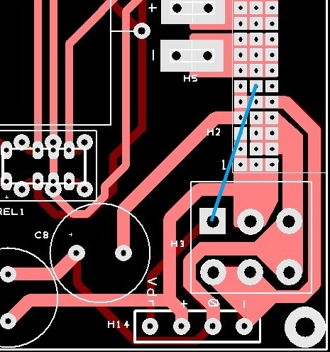

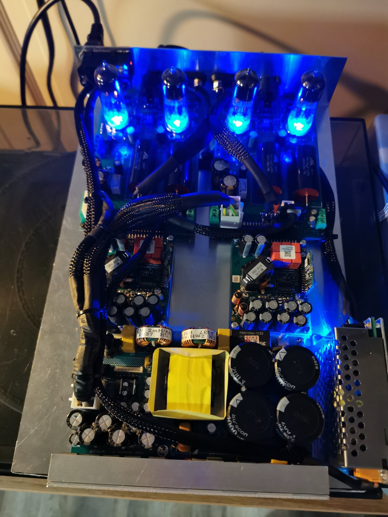

The new Purifi 1ET7040SA Class-D module has a new 54 pin connector so previous 1ET400A pre amp boards would not optimal fit.
My previous 1ET400A board(36 pin) i have adjusted for the 1ET7040SA(54 pin) but new board is downward compatible with 1ET400A(and NC500).

No it give no typical SE tube sound, but I experience a less wider soundstage were voices coming more foreward. It is less analitical as with a opamp input buffer.

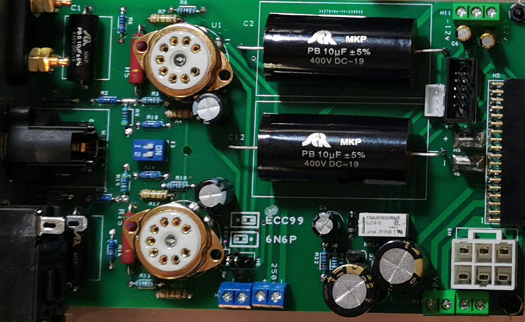

Resistors are 1/4 or 1/2 Watt except the ones noted 3Watt in the schematic. Also in the schematic the minimun voltage of the capacitors. About sizes look at the PCB layout, PCB is 100 x 160mm.
The SMPS does not stated the output current. You need minimal 3.5A heater current and at least 100mA for the anode supply of the two boards. Normally one smps is enough. Just try the smps, you can always use an extra filter.

The tube socket are right.

C1/c11 100nF. Which voltage and type ? (aluminium oil mkp...)
C2/c12 10uf/400v you advise mkp but they doesn't fit your pcb at all. On the picture of your board they look like big tube cap like in the speaker filter .
What are d2/d3 Led???
Is it possible to modify the pcb to write in white X3/X9 on both sides of the J3 connector to know which side to move the button to get x3 or x9 gain depending on the balanced/unbalance input.or maybe it's possible to use wires and a normal small switch on the back of the amplifier close to the jack/xlr socket to select the input type directly ?

I used for the 100nf and 10uf capacitors MKP type 400v from solen but caps and clarity or obbligato also have mkp capacitors who will fit.
When using origenal dip switch the on position is marked on the switch. In the schematic you can see that on is 3x gain and off is 9 x gain.
Using an extern switch is also possible but the change of interference will be higher.
Led d2 and d3 have double function, they show amp on signal is high and light up the bottom of the tube with a blue glow.
