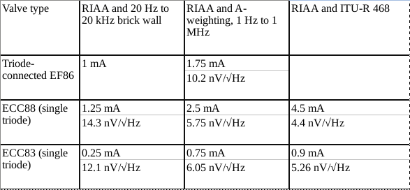

Based on Merlin Blencowe's data for the ECC83 and ECC88 and my own measurements on a very small number of triode-connected EF86's, I once found the attached table. The noise density is a sort of average, to be precise it is the amount of white noise voltage at the input of the amplifier that would produce the same total noise at the output of the weighting filter as the actual noise of the valve.
The optima for A- and RIAA-weighted noise correspond to 0.35 uV for the ECC83, 0.33 uV for the ECC88 and 0.58 uV for the triode-connected EF86 when you divide the total weighted noise by the gain at 1 kHz.
To prevent misunderstandings: you can't compare the values from my last sentence 1 to 1 with artosalo's 0.75 uV because the weightings are different.

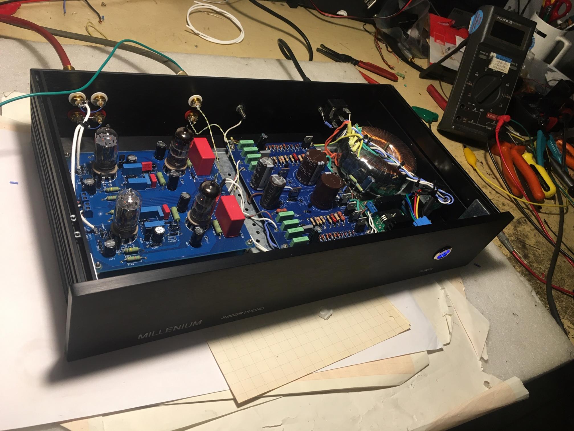

Hi
In attach the photo of the proto of Junior assembled.
The tubes are 5965 in gain stage + PCC88 output.

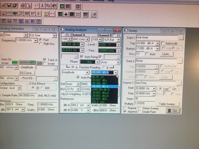

In addition the test on s/n on this version.
the gain is around 109, 40,8 db
the s/n measured is 80,68 with a residual of 50,78 uV. Weighted.
It is very good.
The noise tension related to the input will be 50,78 /108 = 0,47 uV.
The 5965 is not a very high gm tube ( but it has a reasonable low Rp) but in this configuration it is very impressive also as sound.
In other project I got, with a pentode configured as triode, around -85 dB weighted.
