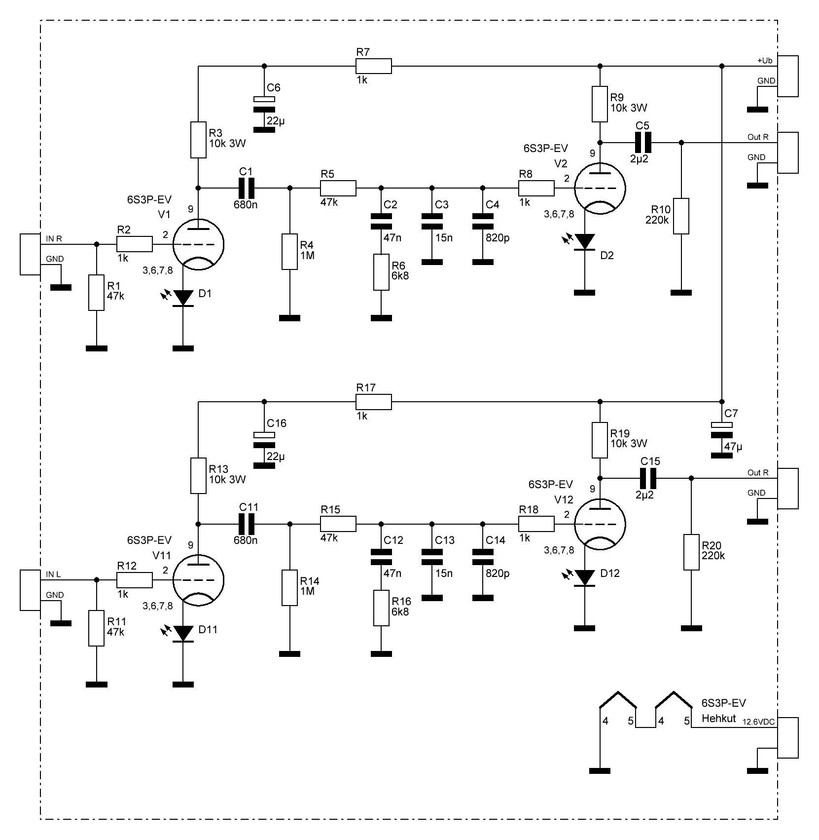

Here is my version with hi-gm triodes 6S3P-EV. These produce some 6...7 dB better signal to noise ratio compared to typical 12AX7/ECC83 constructions.
Gain is 40,3 dB, noise level at the input is 0,75 µV when terminated with 50 ohms.
THD = 0.08 % at 1 Vrms out.

I won't reffer specifficaly to the valves you used in your circuit, but i tried simillar circuits based on D3a and i found that using infrared LED's in the cathode makes the distortions audible and not pleasant at all compared with the simple cathode resistor versions.Here is my version with hi-gm triodes 6S3P-EV. These produce some 6...7 dB better signal to noise ratio compared to typical 12AX7/ECC83 constructions.
Now i can simply understand the decision for using an LED for biasing the valves as they are lower gain than D3a or 12AX7 and the noise is also lower with an LED so maybe using a cathode resistor would make the total gain unfit for a line output usual level, but distortionwise i can bet you can hear the difference between resistor and LED bias.

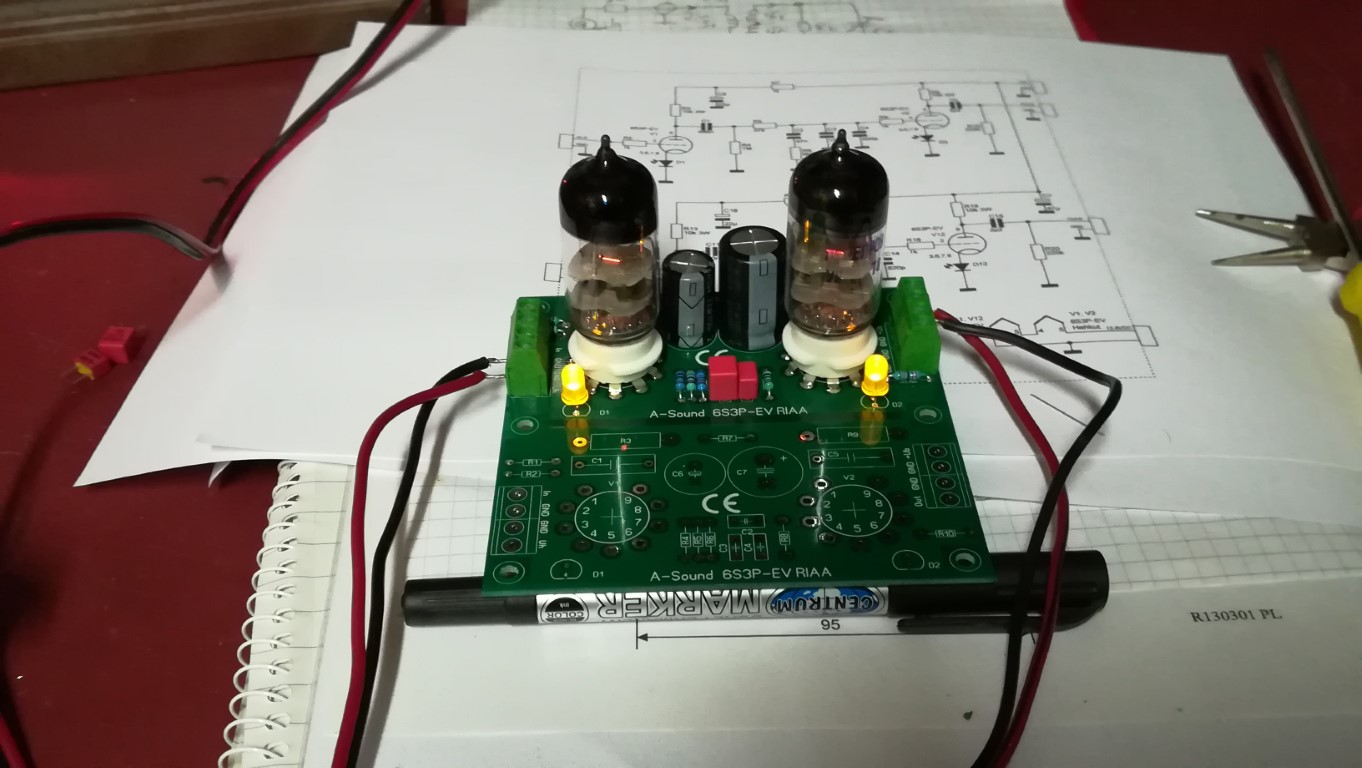

In attach the photo of the proto of Junior assembled.
The tubes are 5965 in gain stage + PCC88 output.
In addition the test on s/n on this version.
the gain is around 109, 40,8 db
the s/n measured is 80,68 with a residual of 50,78 uV. Weighted.
It is very good.
The noise tension related to the input will be 50,78 /108 = 0,47 uV.
The 5965 is not a very high gm tube ( but it has a reasonable low Rp) but in this configuration it is very impressive also as sound.
