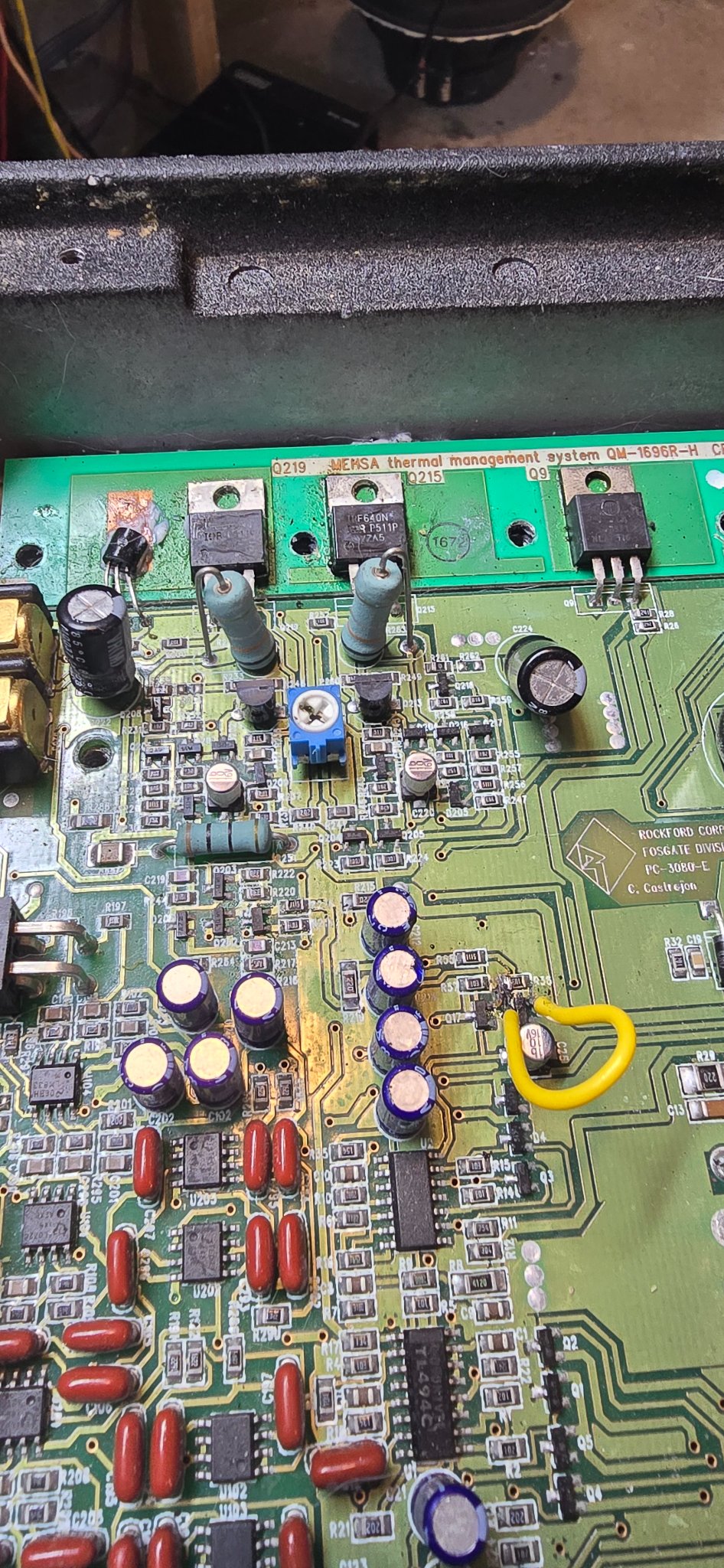

Your talking about the 2 resistors above the pot , correct?
There are a small number of Rockford amps that have the pots for bias reversed (fully CCW is higher biased than fully CW, as it is with most of their amps). You were having trouble with excessive current draw. I wanted you to run them fully clockwise with the limiter to see if that decreased the current draw. It would be safe to do with the limiter and watching the temperature of the outputs. Then, monitoring the voltage across the 0.03 ohm source resistors, you could safely turn the pots to see which limit caused the higher voltage across those resistors.
