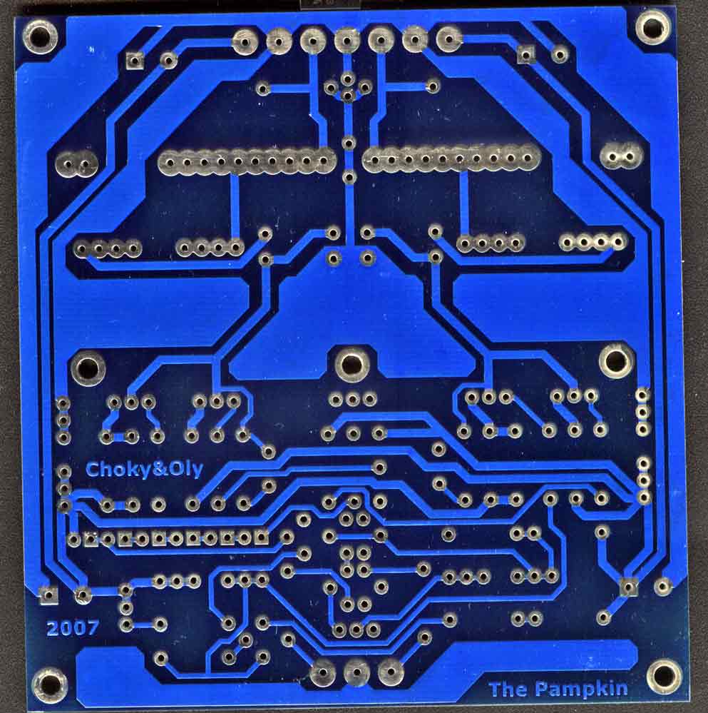

HeHe... Success !
R1/R3 = 8,1Kohm ... R5/R6 = 147,5Kohm (VoltageGain ~x18)
~3v input / 50v out (balanced)
~1v input / 18v out (balanced)
Clipping appears, at approx. 4v input (Near 70v out !!!)

Anyway, today i tried hook'ed 1channel up with F4 (Balanced out 1channel aka' mono)... Let's say, the sound is amazing, simply asstunning, and very clear. First thing i noticed, was very much 'punch', something my setup likes very much.
This pre. is absolutely something different than other i had been listning too, in the good way 😀. Well i am not telling more about this now, as everything isen't made finish yet. (pumpkin wasent even hot when listning, nor adjusted 100% either),
Anyway i had a quistion for you today too ZenMod 😀
I had been lowering R1/R3 to 8,1K and R5/R6 is increased to 147,5K for giving gain at ~18 times. Is there a formula for calculating this, say if i want 30x i increase R5/R6 into 200K and decrease R1/R3 to 6,8K giving like ~29. Will it give more heat ? Will it make noise ? Should i not do it ?... What's to tell about this ?

well ......... I know that I'm Ba...... (
anyway- you can alter values of feedback loop to your choice ,thinking that (roughly!!!) input impedance is ~ value of your R1(R3) resistor and- most important - you can't go with CLG much near OLG without penalties ;
as I wrote before - I didn't measure OLG and I didn't remember what I calc on back of ....toilette paper .......
anyway - why you need astronomic input voltages in F4 ,stacked or not ......... are you deaf .......... or you try to PA kindergarten?
edit:
Hehe... yep, i live near such a thing!... Anyway i just want to drive the F4 to max, at approx. 1/2 volume.. But i see now, it's a stupid thing to do. End of that quistion 🙂
is hottest when is in idling , doesn't matter what gain you set ; it's A class , ya remember?
I just throught that i was changing bias (stupid throught!).. It's clear to me, how it work's now thank's 🙂

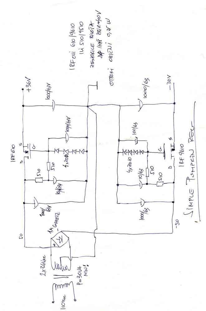

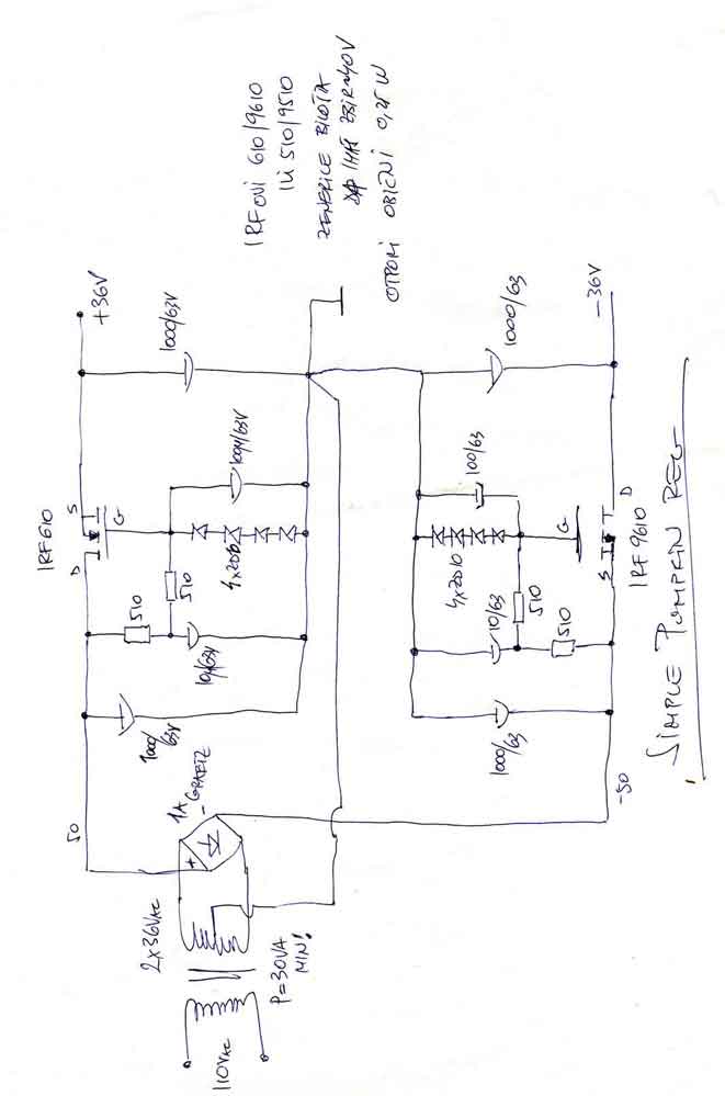

BTW: Have you tested that +36/-36v regulator ? It's just that i made a simmulair one, with 6x6,8v zener = 40,8. Voltage is dropping to 35v with 1 channel hooked up (Maybee i will adjust zener to 42v later). I don't know how much it will lower more (if any) with 2channel's... Just to tell you (and not trying to be clever here 😀). It proberly dosen't mean anything btw.
Jesper.
Jesper.
why I need to test that silly thing- it's boiled water and remember that's just schematic ............ nobody can say that your specimen will work, if you drek something
reg is reg- his role is to regulate voltage , in some boundaries ;
you probably made some mistake- in wiring or in approach....... have your xformer enough voltage and mA for task?
you must have firm input voltage in reg , to have firm output
btw- for reg of that sort , output voltage IS overall zenner string voltage MINUS Ugs ............

lykkedk said:
BTW: Have you tested that +36/-36v regulator ,,,,,,,,,,,,,,,,,
like usual, I made mistake in hand-drawing - switched legs of 9610 .... I hope

they just arrived - first batch of main pcbs
1/2
- Pumpkin Preamp - Perfect for F4
