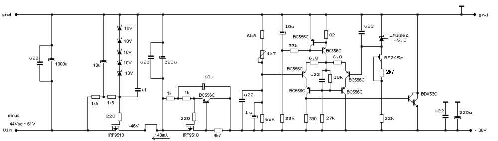

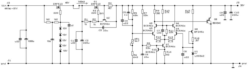

Hello Zenmod,
This is the first regulator of this type put on the Pass Labs section of this Bulletin Board (or at least it is the first for a VERY, VERY long time).
1. How do you adjust it to get different output voltages?
2. What would be the limits of voltages (high and low) it could usefully produce?
I am thinking in terms of all the Pass variants we have seen mulled over on this bulletin board, especially the NS10/SL10 versions, one of which I have built which works currently with two LM317's ... very technical!
George.

Re: regulator
before 1. :
ya know that I'm precious invisible member of this board,so this is pretty logical from me...........
1. easy. too tired now for proper answer;
gimme your desired voltge and load current and I'll show you with that example
2.well......... say- twice 18 to twice 70~80~90
