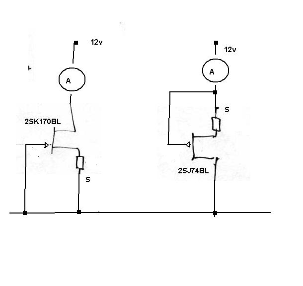

easy peasy , for 2SJ109, matching by Idss :
source and gate to +9 (max 12V)
drain to mA meter red probe
mA meter black probe to gnd

they're fakes
according to 2SJ109 datasheet , there are 3 groups of Idss for exactly same test setup :
GR , BL , and V
if you made test as I wrote ( see enclosed sketch) , they're fakes without doubts
look at 2Sj74 side , presume that Rs is zero , for your case of measuring (full) Idss

Yes my Rs is zero and my type are BL ,so...what should be the correct IDSS (if they were genuine) in my case, with 9V and without Rs?

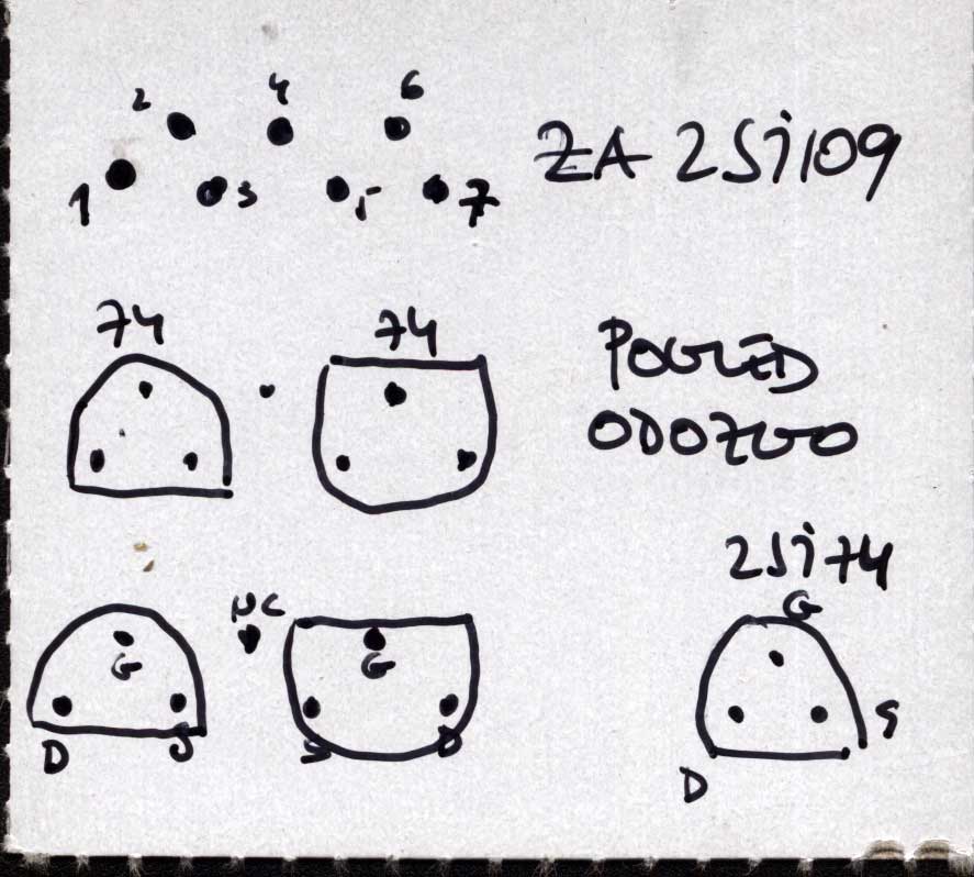

perfect 😉
just take care of pinout

they're good , of course
attached pic - view from top (as a bird ....... or Batman 😉 )

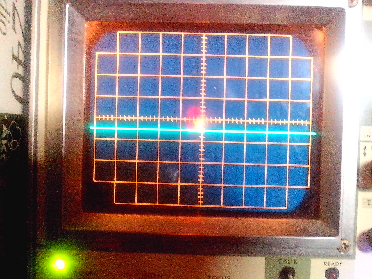

Shunty little poblem/curiosity
Hi for everybody and merry chrystmas!

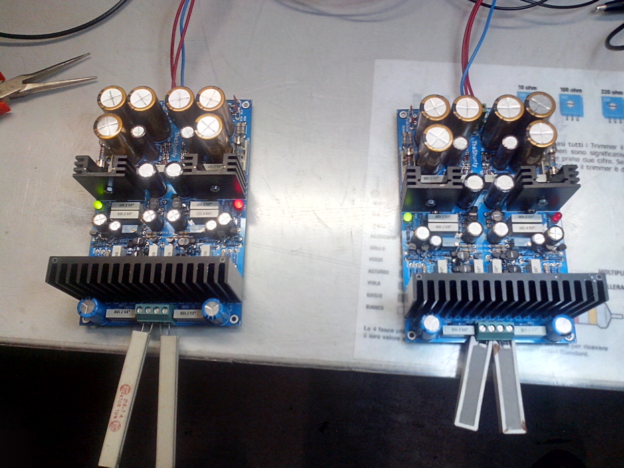

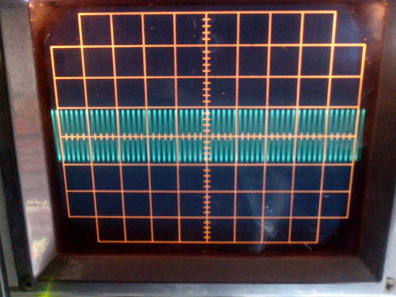

I need to know if this 25Mhz 7Vrms (see pictures attached) found out from my shunty is normal or not.
Have you tried to do an analysis of the output voltage of your shunty?
I believe however that should not be a problem ,but it would be interesting to ask what can be generated by this high frequency and if is possible somehow solve this little problem..🙄
Antonio

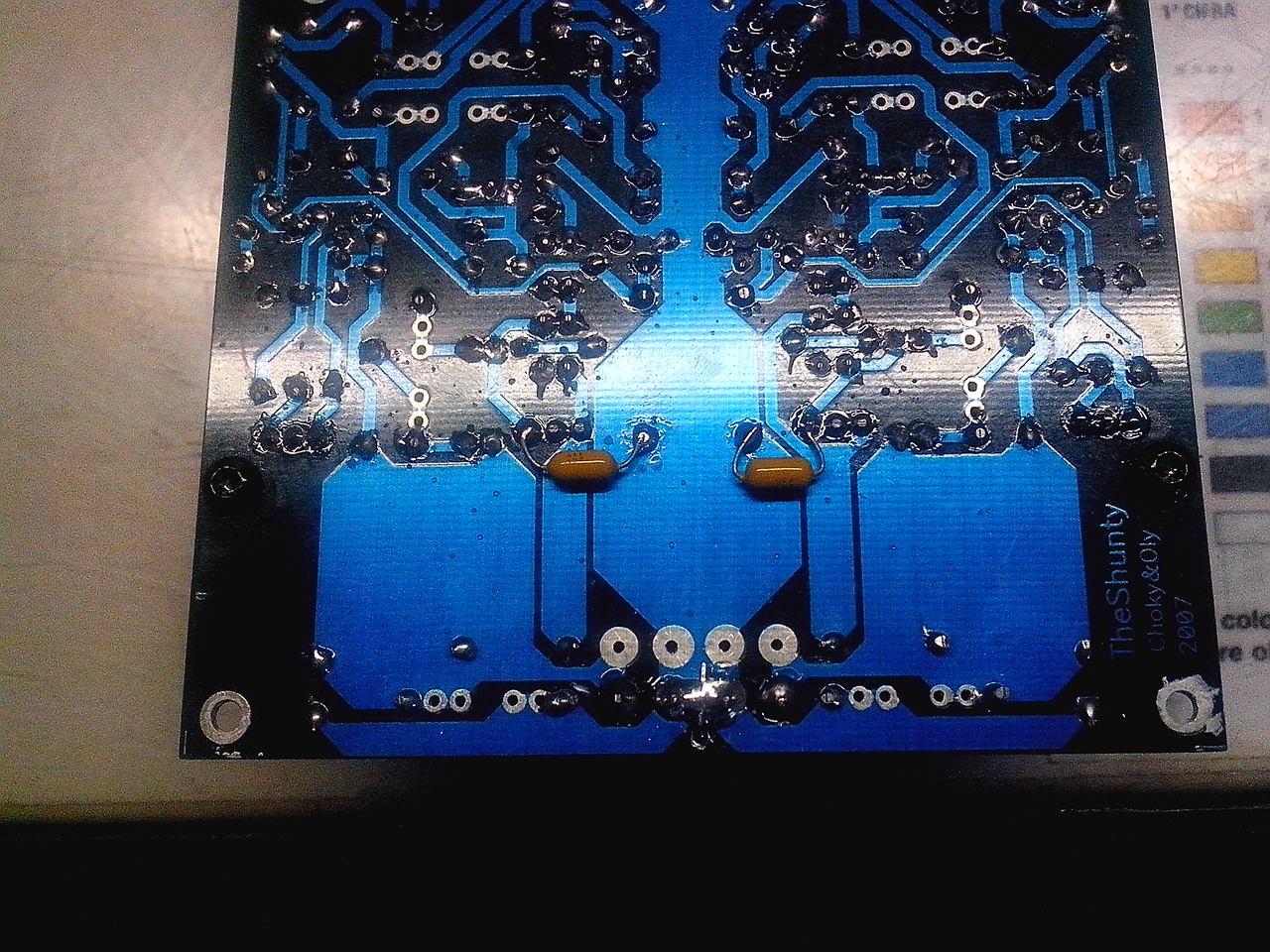

I have a BC Philips brand,so... i have to put a 1uF and 15R in series between the legs of C14 and C14A?
Or a have to
put 1nF between B and C on BDX-es
Or both?

Sorry my mistake the spurious is 25Mhz 7mVrms [/B]and NOT 7Vrms
my specimens were dead silent , also confirmed in AR2's small DIY lab
what type of output (final) caps are you having ?
for test - try snubber RC cell across them
say 1uF and 15R in series
Or a have to
Or both?
....[/COLOR]
both

that means - during development and in first specimens I had genuine parts from old stash ; especially BDX transistors - being darlington , their quality is crucial ; problem is "problem" , meaning that I didn't checked functionality of Shunty with less than optimal parts ; less optimal - meaning not so good BDX ( fluffy production or even fake)
But....this spurious frequency may cause problems or not on the quality sound of the preamp?
Thanks!:hohoho:
7mV is big difference from 7V :rofl:
it will probably not change much in preamp function , but there is also possibility that oscillation is result of dirty surround (regarding RF) and suboptimal test setup
those dummy load resistors are pretty big ; try to connect satellite dish to them ..... :clown:
Alex as you know i'm a policeman and i have to find the rot in everything I do but I must say that you are a great man!🙂
I solved putting 1nF between B and C on BDX-es only!
Now the shunty is ok on all range of frequency, absolutly silent as a grave!

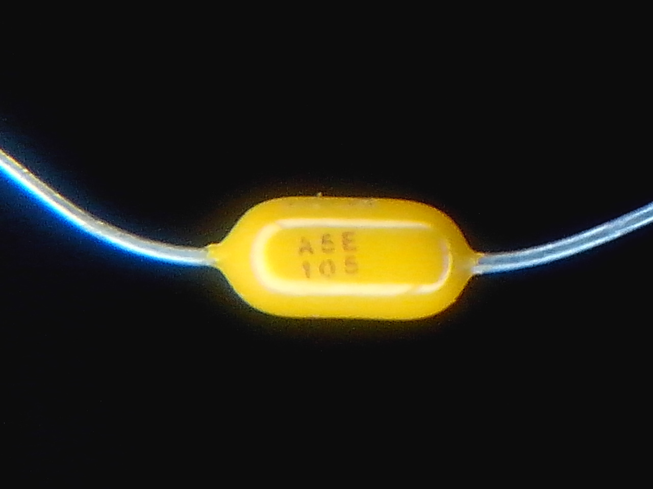

Other Mistake😡sorry i'm tired:headbash:
Solved putting 1uF end not 1nF between B and C on BDX-es only!
Thanks!
please - try decreasing that ....... leave smallest value which is curing oscillation
1uF is way too much

Alex as I said now shunty is perfect! Why to change again, in my city there is a proverb "Never change a winning team." But you are the "Boss"......so . if you want ,please tell me what value and type of capacitor i should use and I will do.🙂
