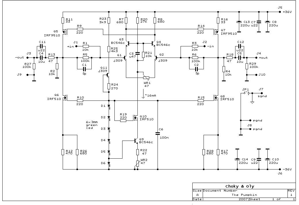

Just finished populating pumpkin. Power Supply with standar LM3x7. When first power on, Led string doesn't light-up. I measured just 4.5V (Gate Q11 and V-). Can you help me?

Led string tested with voltage 11.8V, led light up, so i guest led orientation not wrong. Led Vf=1.97V.

If i change Led with higher Vf (maybe White or Blue Led) will it make Voltage higher (Gate Q11 and V-) ?

Because i just use LTSpice to sim Led String CCS, and i got 5V, maybe my sim not right.
Update : i lift Gate resistor of CCS output (Q6 and Q8), Led String light up, measure it 11,4V. Howto check mosfet, good or bad ? check with my ohm meter pin G-S i got 220 ohm ( on both Channel, Q6 and Q8)

Replace Q6 and Q8 (IRF610), LED string light up (just one channel). I guest Q6 and Q8 on the other channel need replacement too.
Didiet
Didiet
Q6 and Q8 are faulty. Replace quad of them. On one channel, i can set the offset betwen - gnd and + gnd to get 20mV. Betwen - and + i get 2mV.
On the other chanel i only can get - gnd, + gnd 16V. Betwen - + 2 Volt.
I think Q9 fault too. I'll check again tomorrow

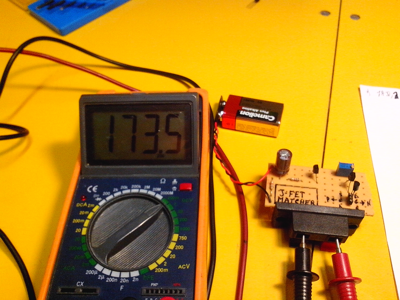

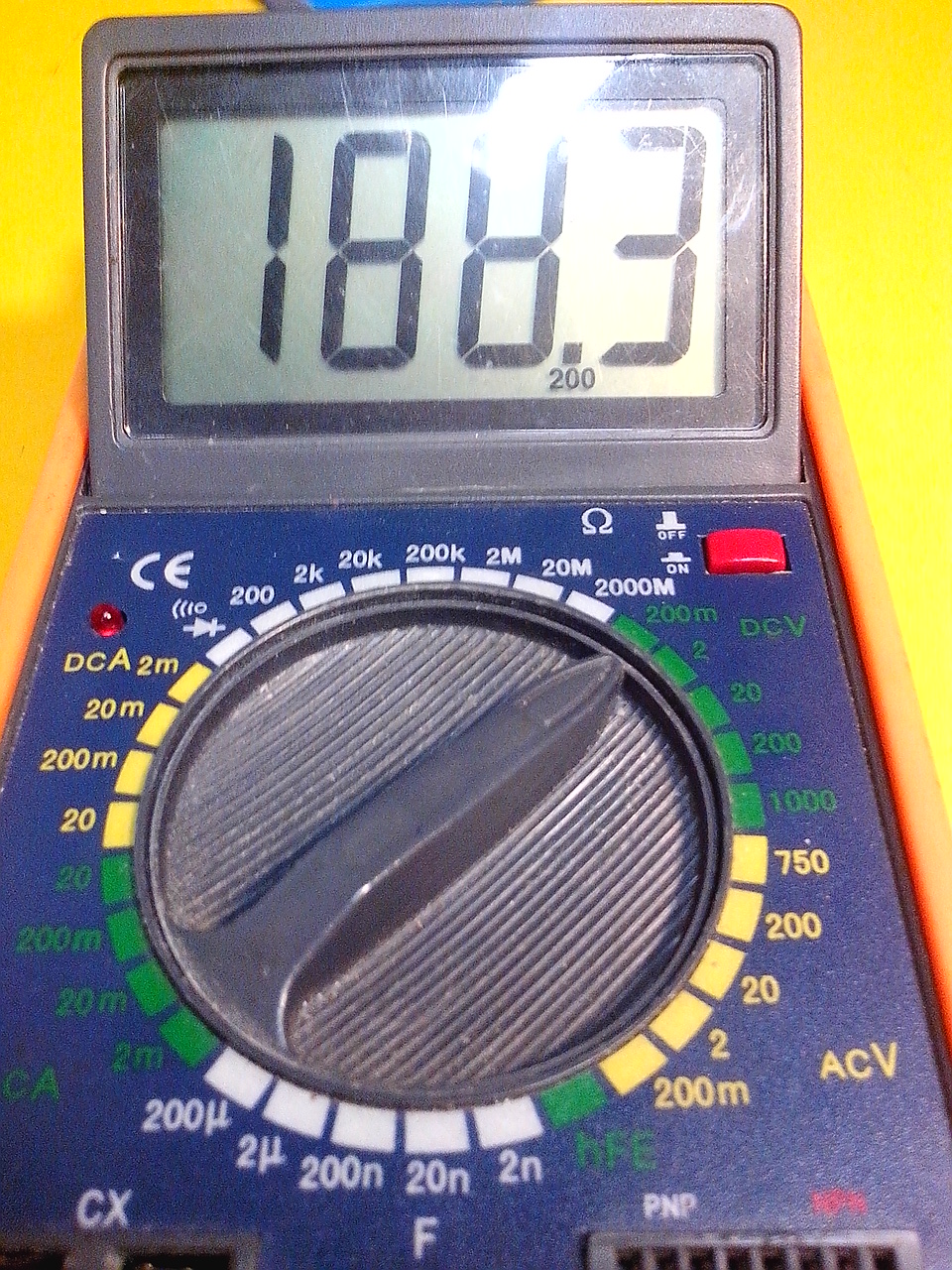

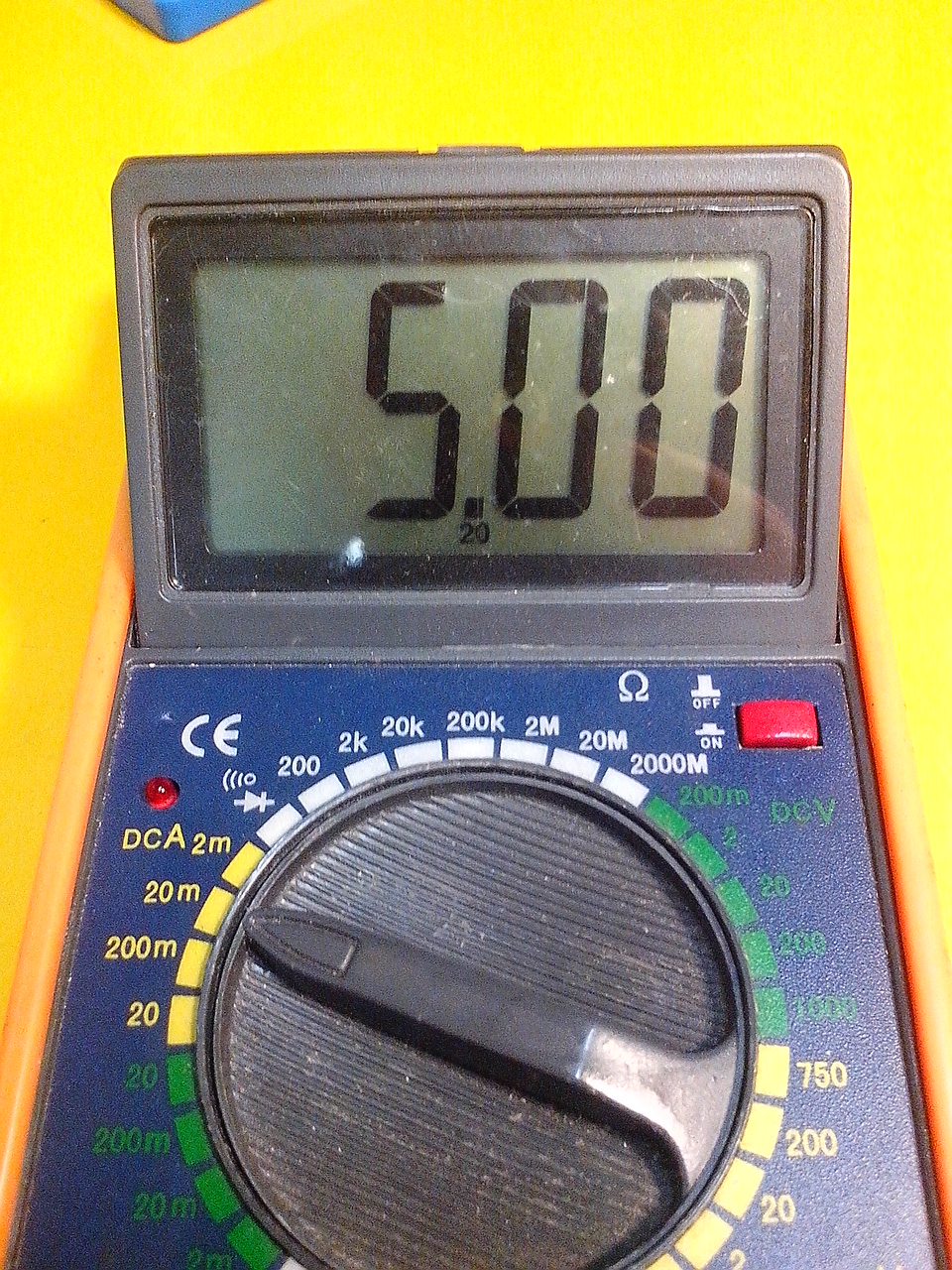

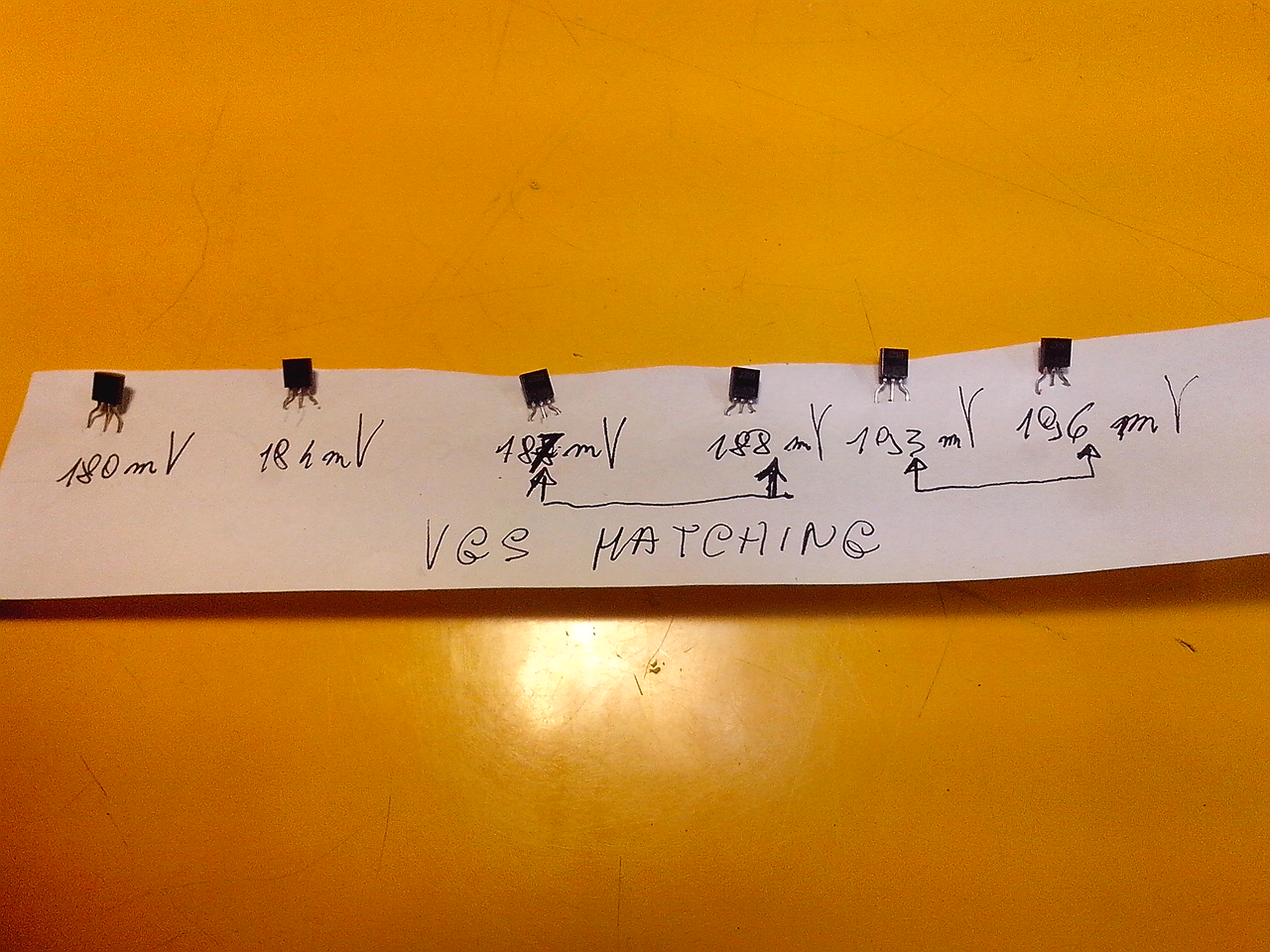

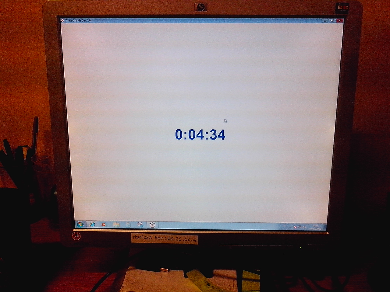

Hi at all! Please i just make the matching of 2sj310 (Q1 and Q2) jfet of Pumpink with Zen mod's circuit matcher.
I have found those values of Vgs:
180-184-(187-188)-(193-196) mV so i have match as in parenthesis.
I have to ask you your comments for results.
The current draw is set to 5mA for five minutes test time.
In addition I also bought some 2sj109 used (for future aleph j babbelfish project), can you suggest a method to test their genuineness?
Please can you let me know?
In attached some pictures please to know some comments for results.
