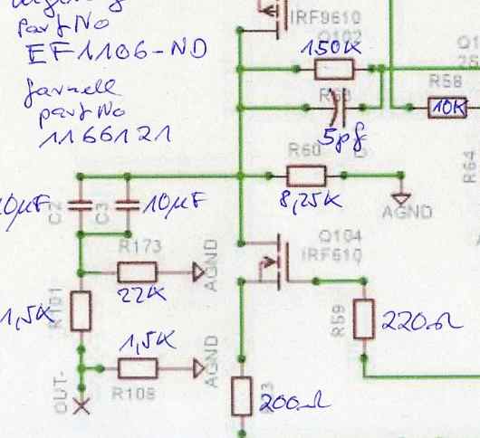

I just remembered that two years ago when I tried my X0 clone (similar to Pumpkin) on perf boards I had a bad oscillation and I cured it by having 1k5 in series with the output after the cap and and 1k5 then to ground.....
Osci was gone.....

and I think the circuit of Pumpkin ZM made is very good and I hope that you have no more pcb problems with Pumpkin and can cure the oscillations with reducing the output resistors and enlarging the output load.....

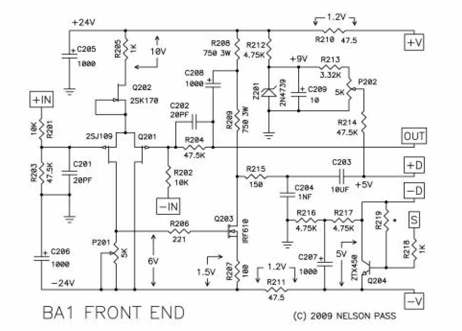

..... what did Nelson say with BA-3
"We have a saying in my house (lifted from Cesar Milan) that “A tired puppy is a happy puppy.” It is my experience that sometimes you get subjectively better sound from a gain device which is operated at a significant portion of its capacity – not allowed to loaf around with an easy job. We may find that it sounds better if we make it do some work. There's nothing magic about this. Making a gain device traveling a load line that represents real work gives it some character. Your mother would probably agree."

I know you are getting lots of suggestions, so here is one more. Simply load both outputs past the output caps at J3,J4 with what ever resistance you choose then you have effectively reduced the AC gain of Q5 and Q7 by loading the outputs with R13 and the loading resistor on the minus output and R14 and the loading resistor on the positive output. This wont effect your dc biasing because of C4 and C5. No desoldering!

OK, in no particular order I have tried all the suggestions.
1. Adding a 4K7 load to both +out and -out makes no difference to the oscillations.
2. Shorting R1 and R3 KILLS the oscillation . +IN and -IN are GROUNDED.
3. Replacing R2 and R4 with 2K7 and connecting 2K7 between Q3(c) and Q4(c) makes no difference to the oscillation.
As this pumpkin now stands.
Everything is AS PER SCHEMATIC except R2 and R4 are now 2K7. R5 and R6 are 27K. C1 and C2 are 33pF. there is a 2K7 as in (3). There are two 4K7 load resistors (one +OUT to GND - the other -OUT to GND).

Just to reiterate where we are.
Everything is still as per the schematic except:
R2 and R4 have been reduced to 2K7
There is a 2K7 between Q3(c) and Q4(c)
R5 and R6 are reduced to 27K
C1 and C2 are increased to 33pF
There are 2 x 33pF between Q1(g) and GND and Q2(g) and GND
There are two 4K7 load resistors between +OUT and GND and -OUT and GND.
IN+ IN- and SIG GND are shorted together.
JP1 is fitted shorting SIG GND to PWR GND.
I appreciate that C1, C2 and the two extras should be 15pF but I'm not spending any more money on this thing until I get somewhere.
