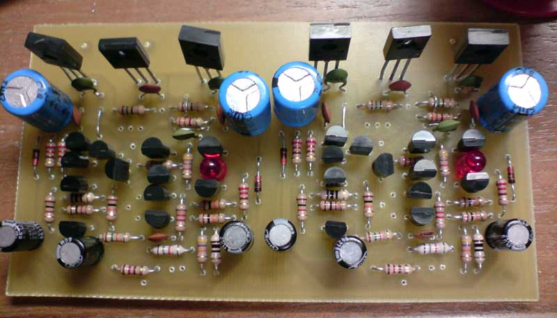

Gentlemen,
Finally I am going to put the
to work. I am building it into its final case right now. Before closing the thing I have been running some more tests with Shuntys only and 470R as load.
Unfortunately R21,R22 keep "blowing" - they are actually not burned, just R is > 2M. My first attempt was 1R8 1/4W noname according to notes in the cook book, then I used 2R 1W Vishay metal film. They just died 5 minutes ago when I switched of/on the third time (It always happens when I switch it on). Both channels at the same moment. I use low ESR Rubycon caps and a 42V 250VA EI transformer...
What could I do?

I took carbon types and had no problem.....your no name were carbon resistors?
And what about the advice of Zen to take MOX 1watt
But I suppose Zen will answer soon.....🙂🙂🙂

you have two solutions , obviously ;
1. either toss those Ruby's out .........
2. or keep changing resistors ; put some fuse holders in their place , to ease that change ........
or ....... maybe you can decrease them in value , 'till they start to survive powering up

Ex post praying did not work, so I guess will have to actually put other resistors. The fuse socket is not such a bad idea since these PCBs clearly have been designed to solder ONCE and then never again 🙄😉.
I don't really know how much current runs through these resistors during startup and why 1W is not enough - I already halved the value. Without much experimenting - bear in mind frequent soldering/desoldering is not the best thing to do to these PCBs
- what should I use? 1/2W Carbon 2R? Generg mentioned MOX?

OK. Should I change R23(a)/R24(a), too? Today it's the same 2R 1W and they did not blow, however I would like to find a setup that reliably survives at least 1000 On/Off cycles without me opening the case and exchanging resistors... 😉
I suppose that is a actually good thing...
Will change to 1R1W and report back. If it blows again I WILL shoot it! 😉
