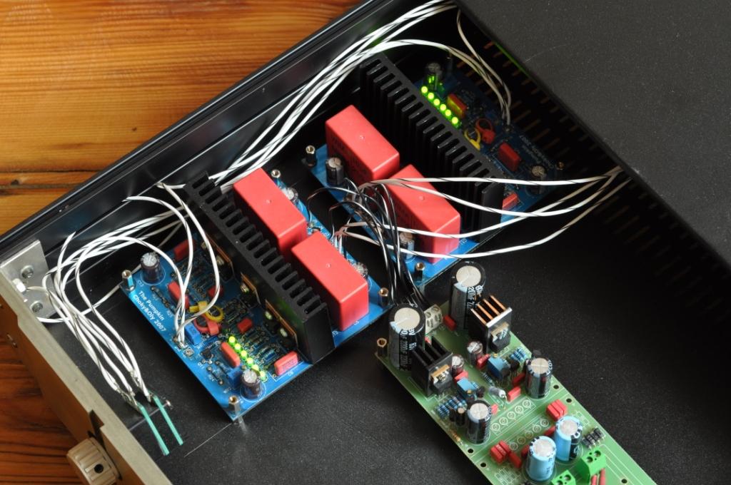

After talking with Manu, i have decided to build the Pumpkin/Shunty....🙂
I just wait for my parcel now. Time is looooooooooooooong. 😱

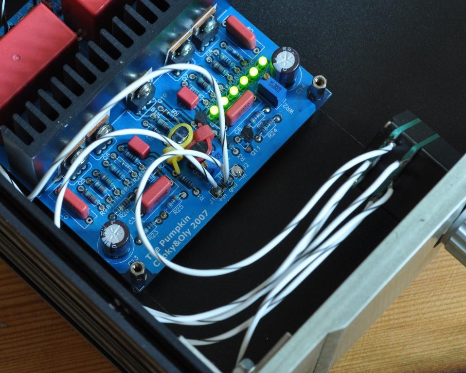

too fat wires
too long , also
you need to keep them tiny and short - at least those for signal ;
that means - both selector and preciousssssssssss TKD must be mounted near back plate
if that's just for test - scusate ....

I like spaghetti wires..🙂🙂🙂🙂. I cook them before I build them in..😉😉😉😉...9 minutes.....sound is incredible.....

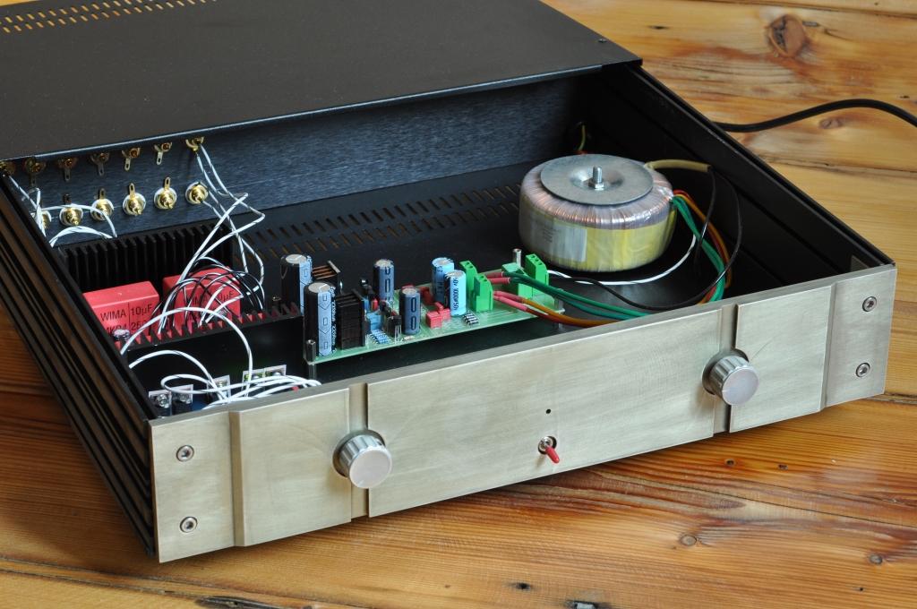

Yes the pics reflects experimental state .... 😎
So to speak ... because it already sounds fantastic as is
I ll do that when i finish shunty and can focus on optimal version ...

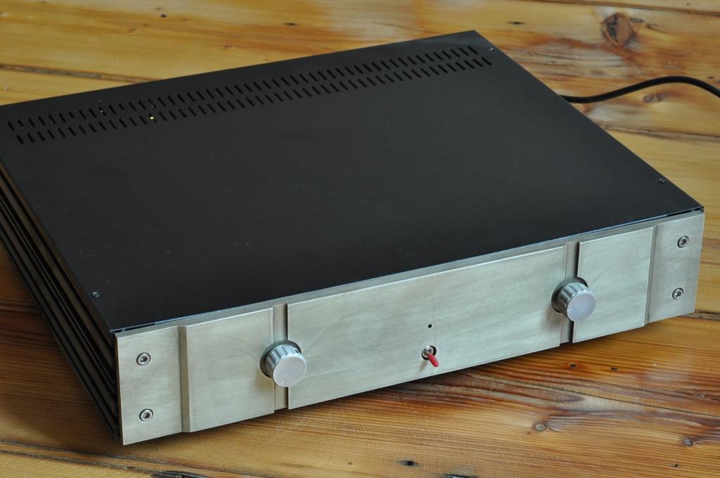

BTW Sasha : why you don't say "ugly"? ... Iznogoud, my Pumpkin ...? 🙁
Has anyone sourced these sinks in the US? Equivelent of Buerklin's 73 B 1792
and 70 B 7206 for the Shunty-Pumpkin?

Russel - just made them of Al sheet - 2 or 3mm thickness , use full height of case
heatsink's form/quality is less important then well ventilated case

But I wanted it to be unfugly! Seriously, how tall would the case have to be?
I may be getting some sinks from Conrad, perhaps they have them. The aluminum you suggest sure would be the easiest way.
