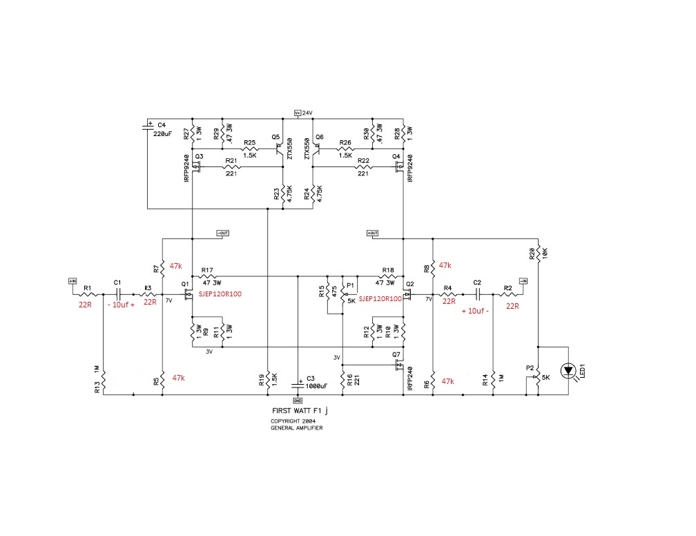

Hi Zen Mod,
when I combine Pumpkin with F1 I have two times 10 uF in the signal path.
My idea is to keep the pumpkin output caps and to bridge the 10 uF of F1.
O.k. .....?
Is it important to keep the two 22 Ohm gatestoppers in F1 or can I choose one of 40 Ohm when I shorted the cap?. Why is one before and one after the cap in the original?
ThX
O.k. .....?
ThX
yes , you can .

just leave out R1 , C1 ,R13,R2,R,14,C2
just R3 and R4 are actual gate stoppers ; rest are protective resistors for cap charging/discharging

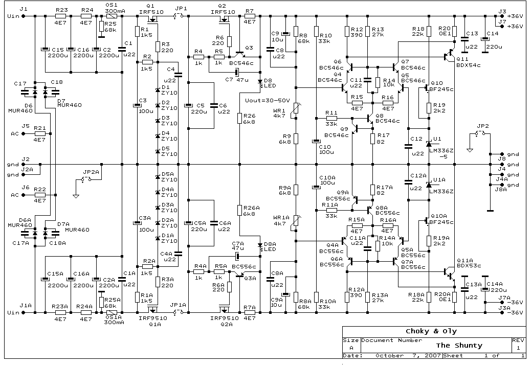

Dear ZenMod,😀
I have on the negative side of one shunty driving pumpkin only 7V instead of 36V. 😕 I opened Jumper 1a, 50V coming from zeners, O.K. But after R7a, 4,7 Ohm only 7V. I changed Q2a, Q3a, nothing better. I proofed the resistors around Q3a, all o.k..
Maybe you have a hint, before I change all the other semiconductors.....
Have a nice evening.....!
what's happening when you remove bridge , labeled as R20 ?
in any case - while repairing Shunty - disconnect
from it
I left bridge open, 0.k?
0,6v over R17 and nothing at base of Q5!

yes - bridge open
connect mA meter across U1 - you must have around 1mA through Q10 CCS ;
if you have - U1 is toasted
if you don't have that 1mA , then Q10 is toasted
....... I'm here 😉
....... I'm here 😉
don't have that 1mA .............. Q10
is toasted.
Tomorrow shops are open I ll buy ten BF245C!
🙂HAPPY GENERG THANKS ZENMOD MILLE FOIS!!!!!!!!🙂

Dear Zen Mod,🙂
when I changed the LM336 and the BF245C I did something to the board by the too often resoldering. The problem got even worse, the current was so high on the negative side that the fuse (315mA) blow many times.😡
Over hours I checked the paths, cleaned the pcb, proved all parts again, no success, only blowing the fuse.
I constructed the branch with LM336 and BF245C apart, on the fly, now it delivered the 5 V for the base of Q5a and I got 36V at the output.🙂
Unfortunately BDX33c gets very hot. I compared the current at R20 and R20a and the negative side has 300mA current instead of 140mA! (right side and correct value I suppose)🙁
May I ask you again for a hint?
I thought the current is determined by R7a, the value is correct.
I had never before such an obstinate problem.😡😡😡
you obviously have oscilation
use cheapest elko ( C14(a)) on Shunty output , and as small as you dare
remove C13(a)
put 1n cap between B-E of Q11(a)
remove C13(a)
