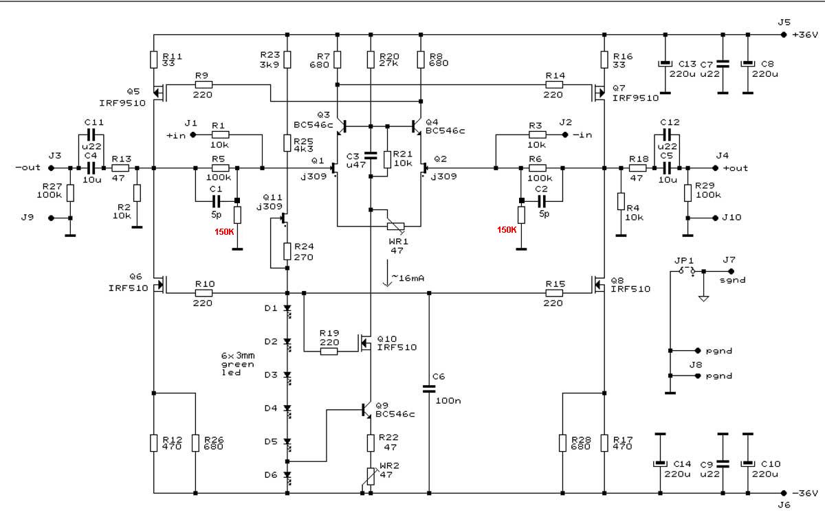

For Nicola Sartori :
look at schematic ..... pairing PSM LS with
is easy , and we only need to increase input impedance of Pumpie , so we don't need any buffer stage in between : increase both R1 and R3 to 47K or 56K , increase both R5 and R6 to 390K , decrease C1 and C2 to 1p5-2p2
for Nicola and Generg - substitute of both Q5 and Q7 (IRF9510) with 2SJ313 : decrease both R11 and R16 to 15R , decrease both R7 and R8 to 220-250R
readjust offset ;

Hi Zen Mod,
I tweaked pumpkin with your recommendations, I had more gain in the stage, is that possible? I reduced the gain 47k instead of 100k.
the sound is different, difficult to say ...... more clarity, less dark, very precise, less warm, more attack.
I have to hear more material, of cause I was used to the old pumpkin sound that was a bit more relaxed.....
very interesting......

more gain in stage ?
naah ..... who cares what's culprit , as long you're able to tweak it to your needs
.... The more I hear with modified pumpkin music I can say To observe more details and they are better located in the soundstage. The reverberations around voices and the construction done by the sound mixer is comprehensible.

shortening the output for muting
can I short-circuit the + and - outputs to ground for muting or is it not good for pumpkin?
Marcel
Marcel
Marcel
Any downside to using a switched attenuator between them for volume control?
