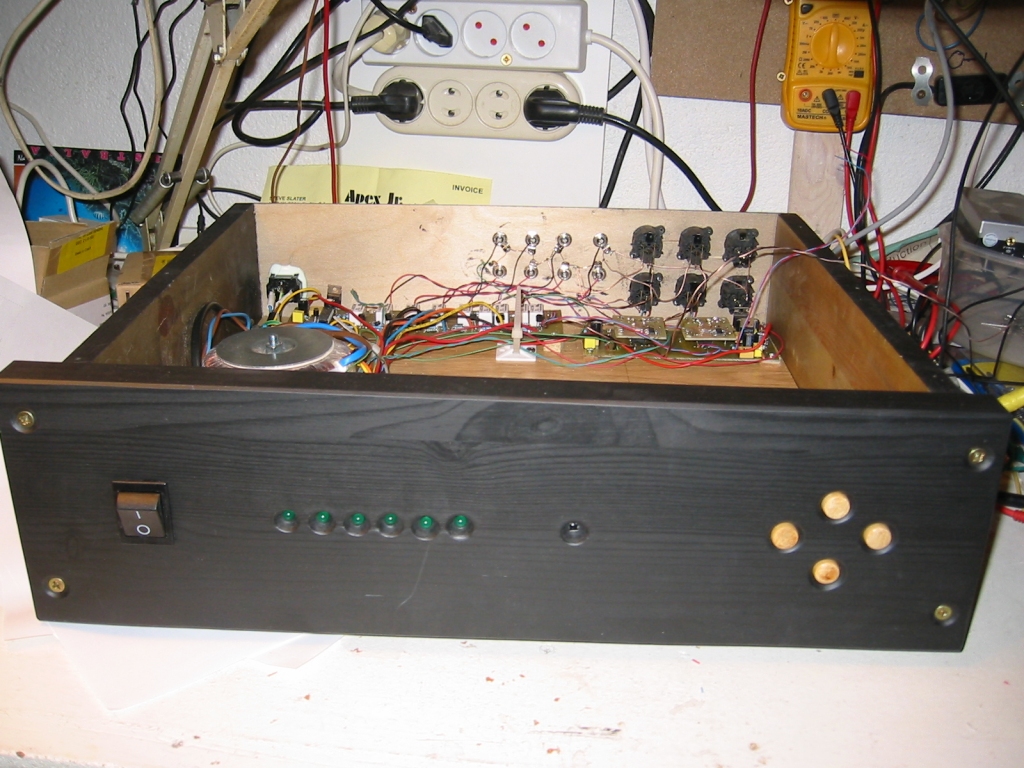

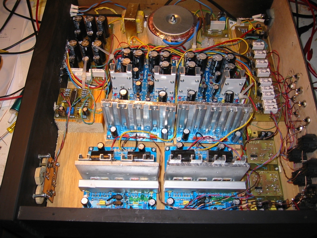

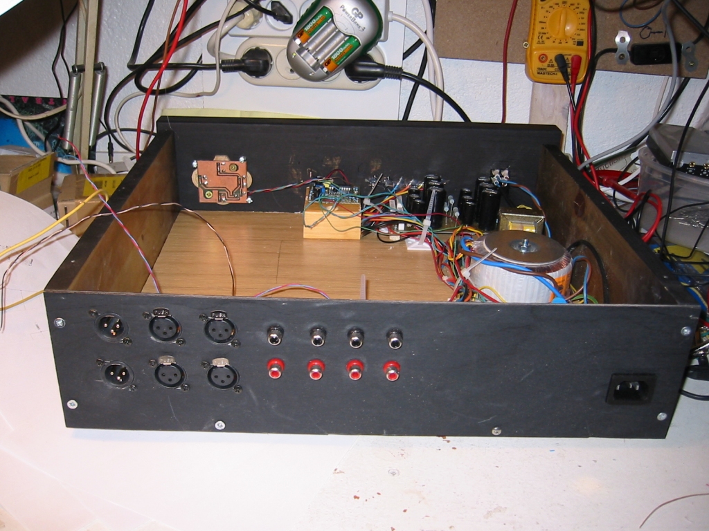

and Happy Hour for me ......pumpkin works and puts some glamour in my soul!:cloud9:

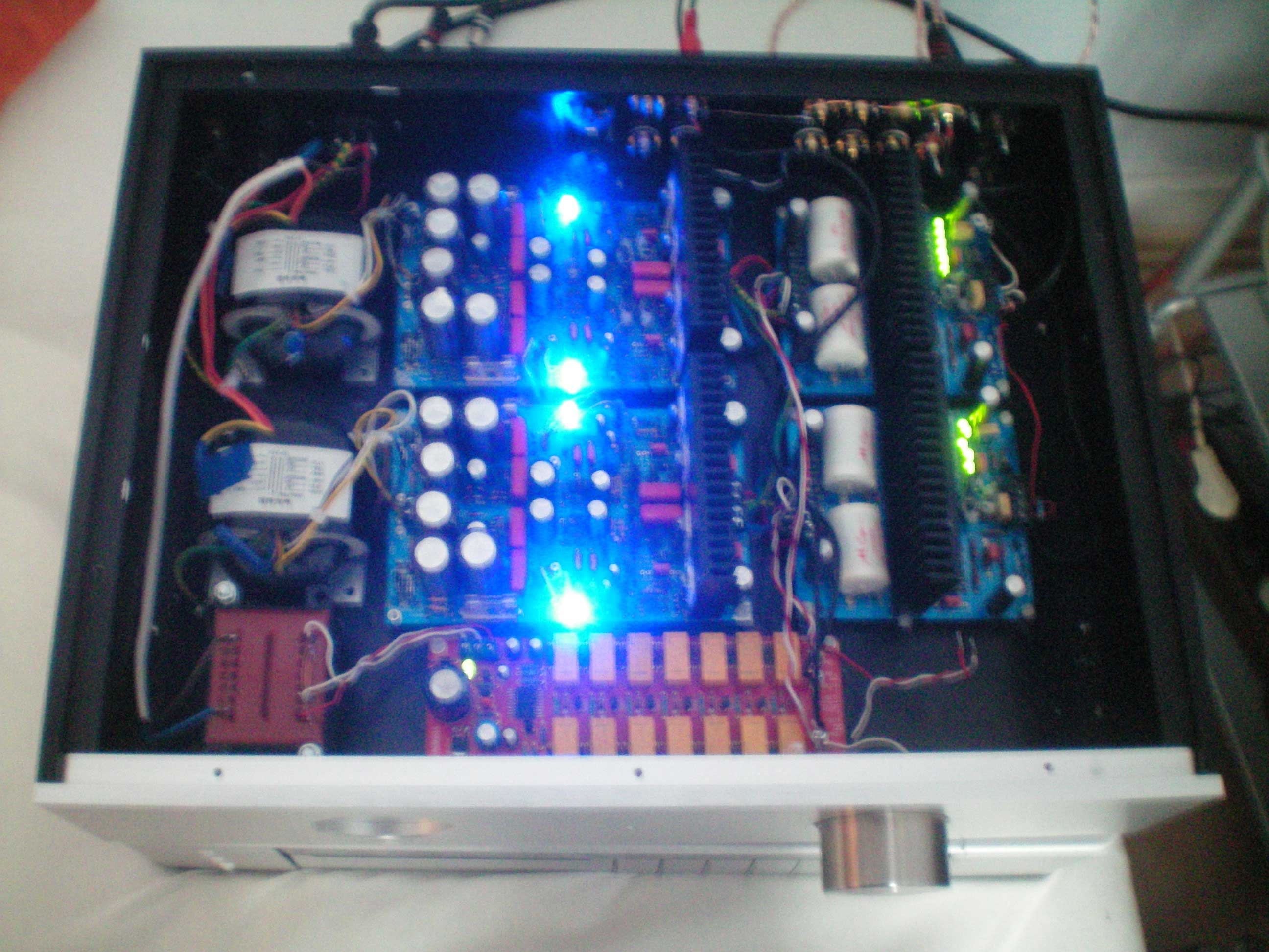

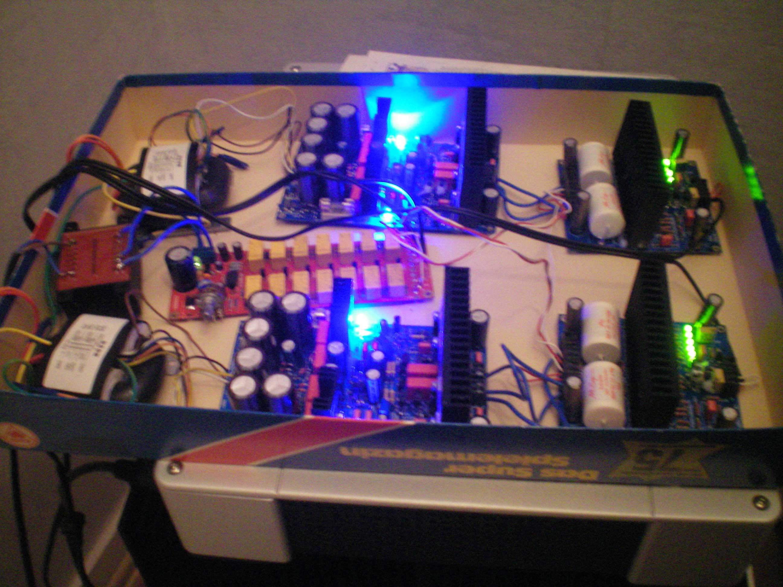

I put it also in the front of pumpkin and compared it to the ebay attenuator on the output of Pumpkin. You can see on the picture the yellow relais. Worked a little better for me.
Heatsinks, I took all what Zen Mod recommended in the .pdf.
My problem was that the transformers gave about 2 x 52V. So I had to fight with much heat.
I put the transistors with the small heatsinks an the alu chasis. Here they feel well.:flame:
